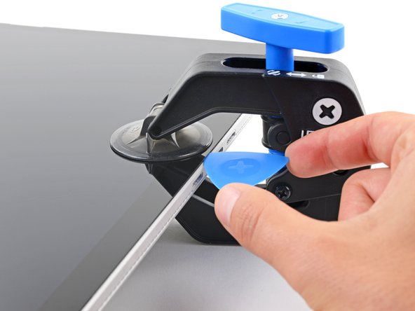

  2. Microsoft Surface Book Screen Replacement, Anti-Clamp instructions: crwdns2935265:02crwdnd2935265:01crwdnd2935265:03crwdne2935265:0 Microsoft Surface Book Screen Replacement, Anti-Clamp instructions: crwdns2935265:02crwdnd2935265:02crwdnd2935265:03crwdne2935265:0 Microsoft Surface Book Screen Replacement, Anti-Clamp instructions: crwdns2935265:02crwdnd2935265:03crwdnd2935265:03crwdne2935265:0
    Clampy - Anti-Clamp
    $24.95
    • The next three steps demonstrate the Anti-Clamp, a tool we designed to make the opening procedure easier. If you aren't using the Anti-Clamp, skip down three steps for an alternate method.
    • For complete instructions on how to use the Anti-Clamp, check out this guide.
    • Pull the blue handle backwards to unlock the Anti-Clamp's arms.
    • Place an object under your Surface Book so it rests level between the suction cups.
    • Position the suction cups near the middle of the bottom edge—one on the front, and one on the back.
    • Hold the bottom of the Anti-Clamp steady and firmly press down on the top cup to apply suction.
    • If you find that the surface of your device is too slippery for the Anti-Clamp to hold onto, use tape to create a grippier surface.

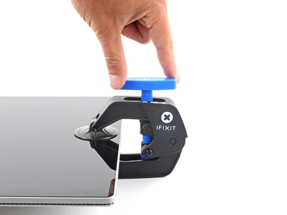

  3. Microsoft Surface Book Screen Replacement: crwdns2935265:03crwdnd2935265:01crwdnd2935265:03crwdne2935265:0 Microsoft Surface Book Screen Replacement: crwdns2935265:03crwdnd2935265:02crwdnd2935265:03crwdne2935265:0 Microsoft Surface Book Screen Replacement: crwdns2935265:03crwdnd2935265:03crwdnd2935265:03crwdne2935265:0
    • Pull the blue handle forward to lock the arms.
    • Turn the handle clockwise 360 degrees or until the cups start to stretch.
    • Make sure the suction cups remain aligned with each other. If they begin to slip out of alignment, loosen the suction cups slightly and realign the arms.

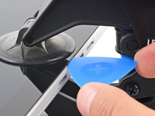

  4. Microsoft Surface Book Screen Replacement: crwdns2935265:04crwdnd2935265:01crwdnd2935265:03crwdne2935265:0 Microsoft Surface Book Screen Replacement: crwdns2935265:04crwdnd2935265:02crwdnd2935265:03crwdne2935265:0 Microsoft Surface Book Screen Replacement: crwdns2935265:04crwdnd2935265:03crwdnd2935265:03crwdne2935265:0
    • Wait one minute to give the adhesive a chance to release and present an opening gap.
    • If your screen isn't getting hot enough, you can use a hair dryer to heat along the bottom edge.
    • For complete instructions on how to use a hair dryer, check out this guide.
    • Insert an opening pick under the screen when the Anti-Clamp creates a large enough gap.
    • If the Anti-Clamp doesn't create a sufficient gap, apply more heat to the area and rotate the handle clockwise half a turn.
    • Don't crank more than a half a turn at a time, and wait one minute between turns. Let the Anti-Clamp and time do the work for you.
    • Skip the next step.
    Didn't worked for me. And the top suction cup is now broken where the anti-clamp and the suction cup unites. Even though, it was extermely difficult to keep the anti-clamp in place. The top suction cup will begin to move around and the anti-clamp will not stay vertical, going sideways or tilted. I ended up using a standard suction cup and finally could move forward. Also the anti-clamp gets very hot when used with a hair dryer, and touching it is almost impossible.
    Andrés Vettori - crwdns2934203:0crwdne2934203:0
    going from middle didn't work for me, works better from one of the bottom corners.
    me160 - crwdns2934203:0crwdne2934203:0

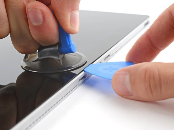

  5. Microsoft Surface Book Screen Replacement, Insert an opening pick: crwdns2935265:05crwdnd2935265:01crwdnd2935265:03crwdne2935265:0 Microsoft Surface Book Screen Replacement, Insert an opening pick: crwdns2935265:05crwdnd2935265:02crwdnd2935265:03crwdne2935265:0 Microsoft Surface Book Screen Replacement, Insert an opening pick: crwdns2935265:05crwdnd2935265:03crwdnd2935265:03crwdne2935265:0
    • The adhesive securing the screen is very strong. This step may take significant force and multiple attempts.
    • Apply a suction handle to the screen, as close to the center of the bottom edge as possible.
    • Pull up on the suction cup with strong, steady force to create a gap between the screen and the frame.
    • If you have trouble creating a gap, apply more heat to further soften the adhesive. Follow the iOpener instructions to avoid overheating.
    • Insert an opening pick into the gap.
    The glass is extremely brittle, so do not keep applying too much upward force while clearing the adhesive, or it will shatter and make you yell at your dog!
    Mark Yeager - crwdns2934203:0crwdne2934203:0

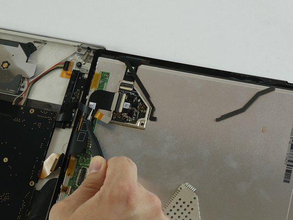

  7. Microsoft Surface Book Screen Replacement: crwdns2935265:07crwdnd2935265:01crwdnd2935265:03crwdne2935265:0 Microsoft Surface Book Screen Replacement: crwdns2935265:07crwdnd2935265:02crwdnd2935265:03crwdne2935265:0 Microsoft Surface Book Screen Replacement: crwdns2935265:07crwdnd2935265:03crwdnd2935265:03crwdne2935265:0
    • Begin by removing the ribbon on the right. With the curved tweezers, carefully remove the metal bracket to expose the end of the ribbon. Remove ribbon.
    Metal plates are difficult to remove. Must pry them off.
    Tommy - crwdns2934203:0crwdne2934203:0
    I was not able to pry off the metal bracket, so I just propped up the screen with the ribbon cables attached while I carefully worked on the laptop
    Jeff How - crwdns2934203:0crwdne2934203:0
    I was able to pull the plate off with my thumb nail. It comes off easily if you get the right angle.
    Marvin - crwdns2934203:0crwdne2934203:0
    I used a blue tool with small scoop on the side opposite the tines to leverage the bracket off. Easily popped off that way, after a few attempts with the curved tweezers filed.
    Mark Kizilos - crwdns2934203:0crwdne2934203:0
    This blue tool seemed to work best for me, as well as knowing the pry point is opposite of the tines.
    mavzerb -
    Is it just me that had extra ribbons?
    W Z - crwdns2934203:0crwdne2934203:0

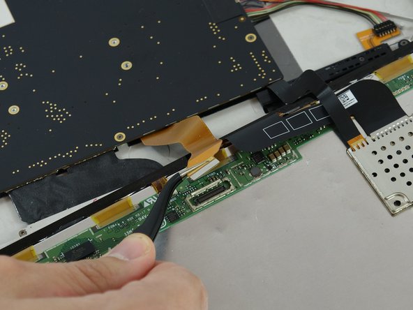

  8. Microsoft Surface Book Screen Replacement: crwdns2935265:08crwdnd2935265:01crwdnd2935265:03crwdne2935265:0 Microsoft Surface Book Screen Replacement: crwdns2935265:08crwdnd2935265:02crwdnd2935265:03crwdne2935265:0 Microsoft Surface Book Screen Replacement: crwdns2935265:08crwdnd2935265:03crwdnd2935265:03crwdne2935265:0
    • Next, remove the metal shield covering the other ribbon. Then remove the ribbon.
    • Remove the screen.
    Remove only the plug to the far right leave the ribbon cables and the clips alone What was confusing in this photo it looked like he removed the large ribbon clip, he did not. I did and busted the clip that secured the cable. I had to buy a new touch sensor board.
    Don’t make this mistake, look carefully before you do. Stop before going to far.
    James Foley - crwdns2934203:0crwdne2934203:0
    I managed to bust my connector as well, despite trying like !&&* not to - awful design on microsoft's part, but the instructions really need to call out just how exactly one needs to remove these without destroying other components
    Manuka -
    James Foley, I've just done the same: busted the clip on the wide connector (had to detach the ribbon cables to replace a broken screen with a new one). Where and how did you find a replacement board?
    Dan Guralnik -
    I assume your talking about step 8. I removed all 3 ribbons easily. 2 had latches that need to be opened. I had the whole sensor out and seperated.
    More McCormack -
    I think I could have done this in less than 30 minutes since the computer back was bulging with the batteries swelling. To my surprise, the batteries were stuck to the back with black adhesive so the connector popped loose. Fearing that I had screwed up the connector, I plugged the computer into the new battery pack and found everything was working and the battery showed a full charge. TaDa. With my wife’s help holding the back, I used a hair dryer and wooden spatula to remove the old battery pack. Rather than trying to apply more adhesive to the edges of the back I used black electrical tape to keep it in place.
    Tom Strothers - crwdns2934203:0crwdne2934203:0
    I did the screen and battery. Battery swelled and cracked the screen. Scariest part was heating the battery. Reading all the labels about possibility of fire. I heated the back and the old battery slipped right out. adhesive was still good so I put the new battery right in on top of it.
    More McCormack - crwdns2934203:0crwdne2934203:0
    If you are replacing the screen, you will need to transfer the square/triangular board from the old screen to the new screen. This step/detail is missing.
    meh - crwdns2934203:0crwdne2934203:0
