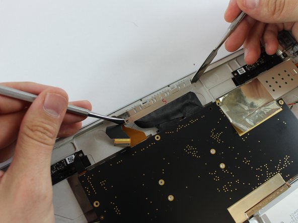

    3. Microsoft Surface Book Battery Replacement: crwdns2935265:018crwdnd2935265:01crwdnd2935265:03crwdne2935265:0 Microsoft Surface Book Battery Replacement: crwdns2935265:018crwdnd2935265:02crwdnd2935265:03crwdne2935265:0 Microsoft Surface Book Battery Replacement: crwdns2935265:018crwdnd2935265:03crwdnd2935265:03crwdne2935265:0
      • Remove the black plastic strip.
      • Then use a metal spudger to remove the ribbon under the black strip.
      • Make sure that you gently remove the ribbon.
    4. Microsoft Surface Book Battery Replacement: crwdns2935265:019crwdnd2935265:01crwdnd2935265:03crwdne2935265:0 Microsoft Surface Book Battery Replacement: crwdns2935265:019crwdnd2935265:02crwdnd2935265:03crwdne2935265:0 Microsoft Surface Book Battery Replacement: crwdns2935265:019crwdnd2935265:03crwdnd2935265:03crwdne2935265:0
      • Gently raise the motherboard slightly.
      • Don't manhandle the motherboard.
      • Use a plastic spudger to gently pry the battery. The battery runs underneath the motherboard. Pull free to the right.
