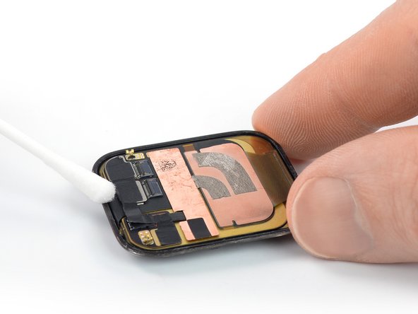

    • The following steps show how to apply new display adhesive with the display already installed. If you're installing a new screen or removed your screen jump to Step 6 of this guide.
    • Apply a little bit of isopropyl alcohol (>90%) to a cotton swab, or Q-tip (or use a cleaning pad) and gently remove the old adhesive on top of the watch frame.
    • To remove the adhesive on the side with the display cables, gently lay the display on the frame.
    • Avoid straining or tearing the display cables.
  2. How to Reseal an Apple Watch, Clean the rear side of the display: crwdns2935265:02crwdnd2935265:01crwdnd2935265:02crwdne2935265:0 How to Reseal an Apple Watch, Clean the rear side of the display: crwdns2935265:02crwdnd2935265:02crwdnd2935265:02crwdne2935265:0
    • Flip the Apple Watch upside down so the display lays flat and lift the watch body.
    • Gently remove the old adhesive on the rear side of the display.

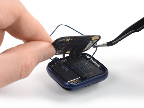

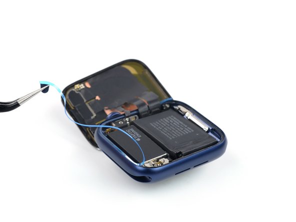

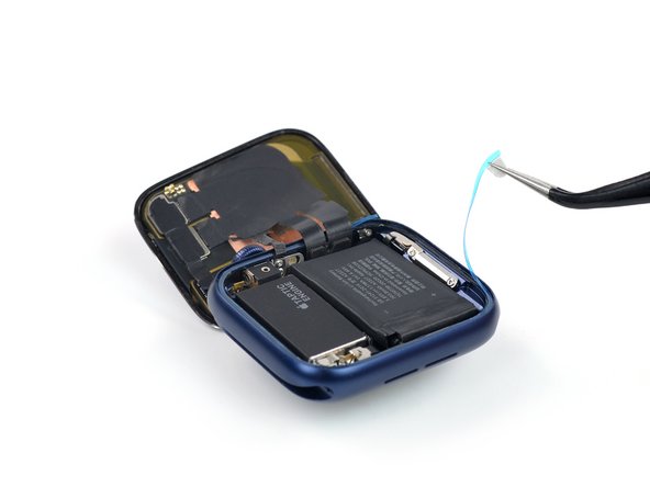

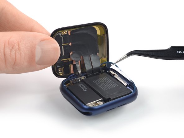

  4. How to Reseal an Apple Watch, Apply the new adhesive: crwdns2935265:04crwdnd2935265:01crwdnd2935265:03crwdne2935265:0 How to Reseal an Apple Watch, Apply the new adhesive: crwdns2935265:04crwdnd2935265:02crwdnd2935265:03crwdne2935265:0 How to Reseal an Apple Watch, Apply the new adhesive: crwdns2935265:04crwdnd2935265:03crwdnd2935265:03crwdne2935265:0
    • Hold the replacement adhesive diagonally and thread it over the display.
    • Slightly tilt the display forward to align the adhesive with the frame.
    • Position the replacement adhesive on the watch frame, where the old adhesive was located.

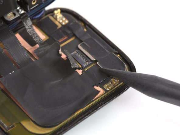

  11. How to Reseal an Apple Watch, Reconnect the screen: crwdns2935265:011crwdnd2935265:01crwdnd2935265:02crwdne2935265:0 How to Reseal an Apple Watch, Reconnect the screen: crwdns2935265:011crwdnd2935265:02crwdnd2935265:02crwdne2935265:0
    • Lay your display flat on your working surface.
    • Hold the watch body in an upright position and grab the display cables with a pair of tweezers.
    • Before inserting the cables into the connectors, make sure the ZIF connector flaps are in an upright position. Otherwise, you risk damaging the cables.
    • Align the display cables parallel to the ZIF connectors and push them in.
    • No force is needed to push the cables into the connectors. If the cable doesn’t insert easily, it’s probably misaligned and needs to be gently removed and repositioned.

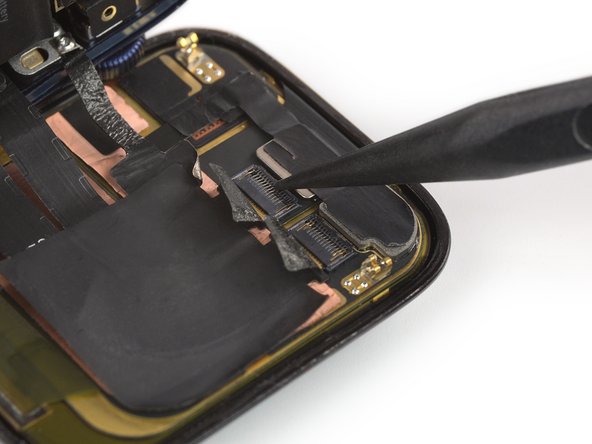

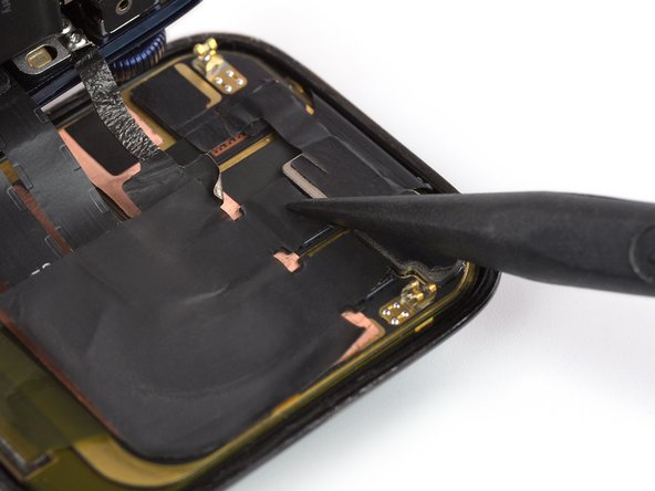

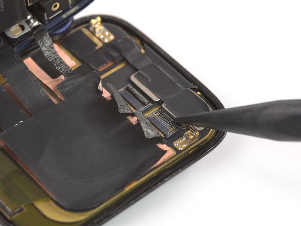

  12. How to Reseal an Apple Watch, Secure the ZIF connectors: crwdns2935265:012crwdnd2935265:01crwdnd2935265:03crwdne2935265:0 How to Reseal an Apple Watch, Secure the ZIF connectors: crwdns2935265:012crwdnd2935265:02crwdnd2935265:03crwdne2935265:0 How to Reseal an Apple Watch, Secure the ZIF connectors: crwdns2935265:012crwdnd2935265:03crwdnd2935265:03crwdne2935265:0
    • Use the pointed end of a spudger and fold down the black flaps on top of the ZIF connectors to secure the cables.

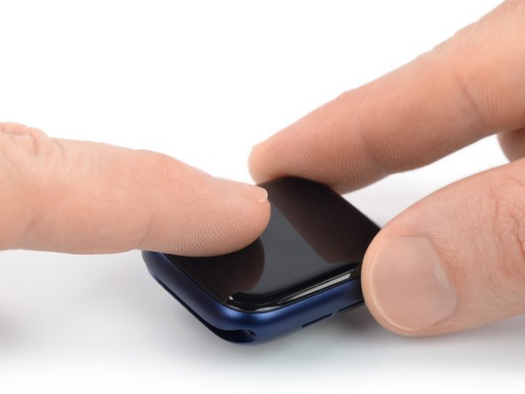

  15. How to Reseal an Apple Watch, Reseal the Apple Watch: crwdns2935265:015crwdnd2935265:01crwdnd2935265:02crwdne2935265:0 How to Reseal an Apple Watch, Reseal the Apple Watch: crwdns2935265:015crwdnd2935265:02crwdnd2935265:02crwdne2935265:0
    • Align the screen and press it down firmly onto the adhesive.
    • To improve bonding of the adhesive, apply a heated iOpener to the display. Then apply pressure for a few hours —for example, place your Apple Watch under one or two heavy books overnight.
    • Alternatively, you can use screen vice clamps around the perimeter of your device to set the new adhesive.
