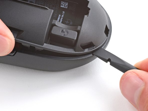

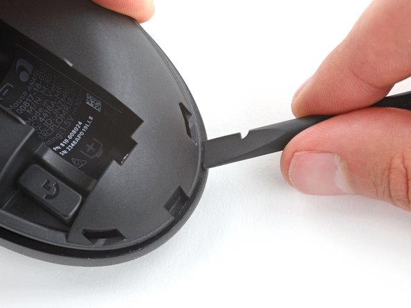

  10. How to Open Your Logitech G305: crwdns2935265:010crwdnd2935265:01crwdnd2935265:03crwdne2935265:0 How to Open Your Logitech G305: crwdns2935265:010crwdnd2935265:02crwdnd2935265:03crwdne2935265:0 How to Open Your Logitech G305: crwdns2935265:010crwdnd2935265:03crwdnd2935265:03crwdne2935265:0
    • With one hand, firmly grip the top shell.
    • With your free hand, insert the flat end of a spudger between the top and bottom shells near the rear of the mouse.
    • Slide the spudger towards the rear of the mouse while pulling the top shell up and toward the front to separate the shells.
    • If the shells don't separate, repeat the process on the other side of the mouse.

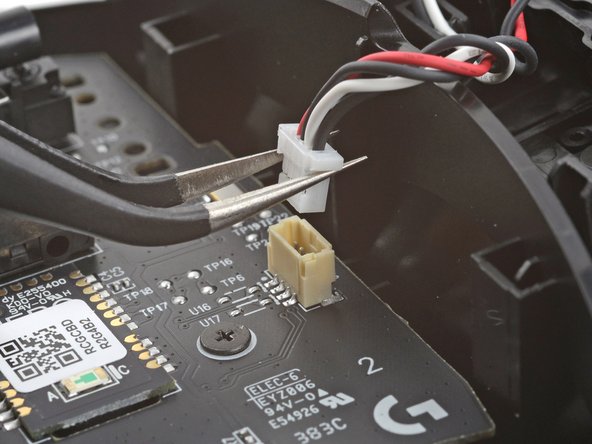

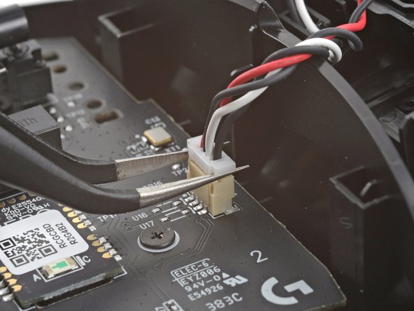

  12. How to Open Your Logitech G305: crwdns2935265:012crwdnd2935265:01crwdnd2935265:03crwdne2935265:0 How to Open Your Logitech G305: crwdns2935265:012crwdnd2935265:02crwdnd2935265:03crwdne2935265:0 How to Open Your Logitech G305: crwdns2935265:012crwdnd2935265:03crwdnd2935265:03crwdne2935265:0
    • Use tweezers to firmly grip the short edges of the battery cable connector on the bottom right corner of the board.
    • Pull the connector straight up and out of its socket.
    • If you're having trouble, rock the connector side-to-side to help loosen it.
    • During reassembly, push down on the edges of the connector with the flat end of a spudger until it's fully seated in the socket.

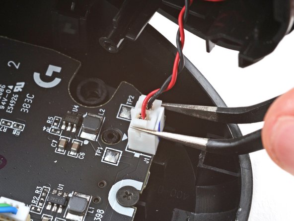

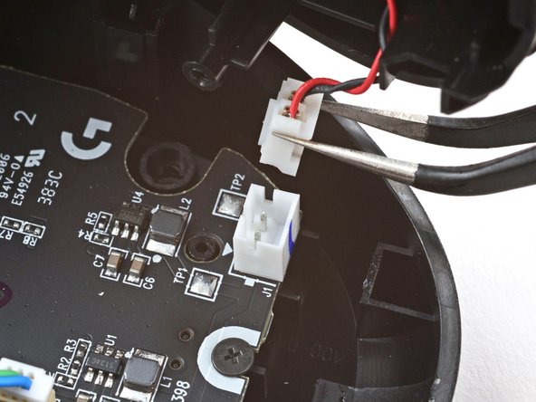

  14. How to Open Your Logitech G305: crwdns2935265:014crwdnd2935265:01crwdnd2935265:03crwdne2935265:0 How to Open Your Logitech G305: crwdns2935265:014crwdnd2935265:02crwdnd2935265:03crwdne2935265:0 How to Open Your Logitech G305: crwdns2935265:014crwdnd2935265:03crwdnd2935265:03crwdne2935265:0
    • Use tweezers to firmly grip the short edges of the top buttons connector on the right edge of the board.
    • During reassembly, push down on the short edges of the connector with the flat end of a spudger until it's fully seated in the socket.

Hey, there is a little tab at the back of the mouse on step 10 that seems to be broken in this tutorial, it holds the top shell down and you have to push it backwards to release the top shell.⏎
I struggled a bit because of it, so if you are too don't force it or you might break it too, just push the tab backwards, thx!
