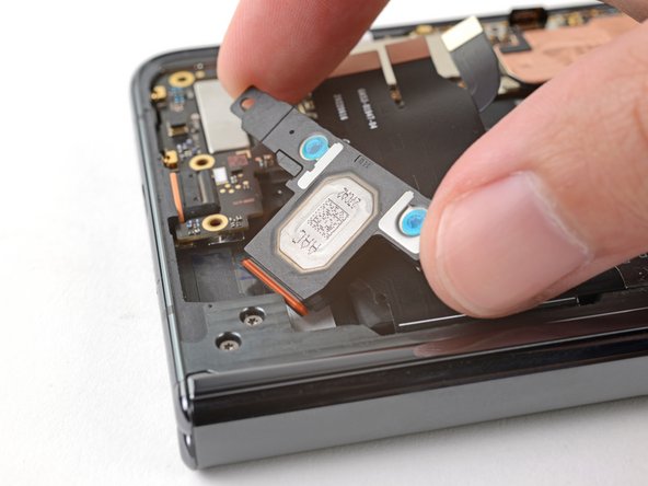

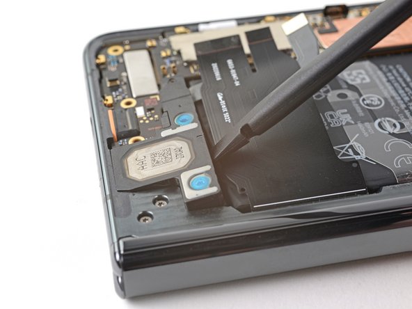

  33. Google Pixel Fold Bottom Speaker Replacement, Remove the bottom speaker: crwdns2935265:033crwdnd2935265:01crwdnd2935265:03crwdne2935265:0 Google Pixel Fold Bottom Speaker Replacement, Remove the bottom speaker: crwdns2935265:033crwdnd2935265:02crwdnd2935265:03crwdne2935265:0 Google Pixel Fold Bottom Speaker Replacement, Remove the bottom speaker: crwdns2935265:033crwdnd2935265:03crwdnd2935265:03crwdne2935265:0
    Tesa 61395 Tape
    $5.99
    • The speaker is lightly adhered to the frame.
    • Don't pry with the spudger, as you risk damaging the battery.
    • Insert the flat end of a spudger between the battery and the bottom speaker.
    • Twist the spudger to separate the adhesive securing the bottom speaker.
    • Remove the bottom speaker.
    • During reassembly, if your adhesive is still intact and sticky, you can reuse it. Otherwise, follow this guide to replace it with custom cut strips.
    • If you don't have custom cut adhesive strips, use double-sided tape, like Tesa Tape, to secure the speaker to the frame.
