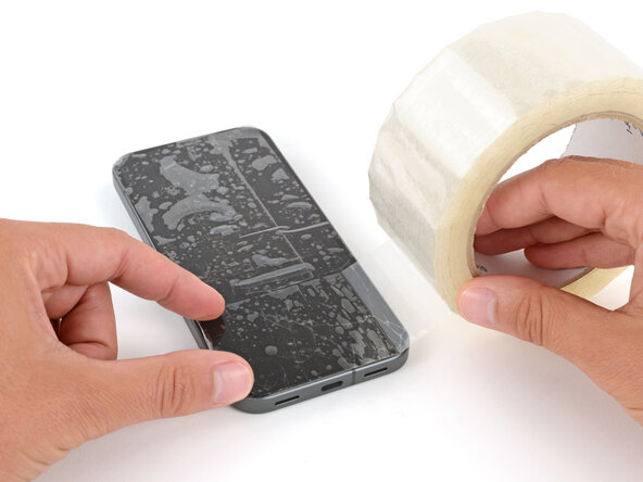

  2. Google Pixel 10 Screen Replacement, Cracked glass preparation: crwdns2935265:02crwdnd2935265:01crwdnd2935265:03crwdne2935265:0 Google Pixel 10 Screen Replacement, Cracked glass preparation: crwdns2935265:02crwdnd2935265:02crwdnd2935265:03crwdne2935265:0 Google Pixel 10 Screen Replacement, Cracked glass preparation: crwdns2935265:02crwdnd2935265:03crwdnd2935265:03crwdne2935265:0
    • Glass shards can complicate disassembly—or worse, cause injury. If your phone has a cracked screen, follow this step.
    • Apply strips of packing tape to the cracked glass until the whole screen is covered—this will help keep the glass contained and allow the suction cup to stick to the screen.
    • Make sure there's a single strip (not overlapping) of tape across the top edge, big enough for a suction cup to fit on.
    • Only cover the glass itself—don't stick any tape to the frame.
    • Consider wearing safety glasses to protect your eyes from any glass shaken free during the repair.

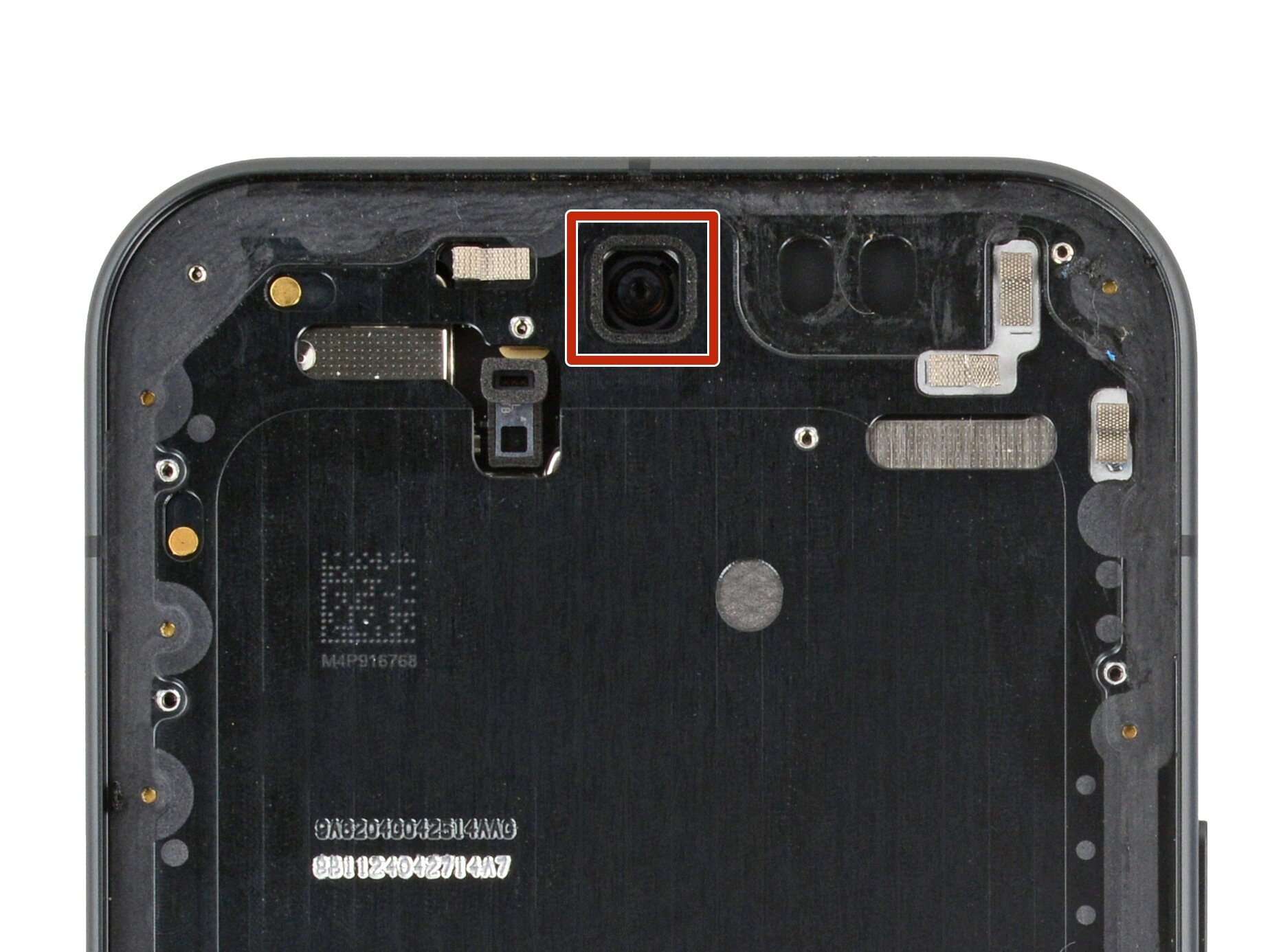

  5. Google Pixel 10 Screen Replacement, Insert an opening pick: crwdns2935265:05crwdnd2935265:01crwdnd2935265:03crwdne2935265:0 Google Pixel 10 Screen Replacement, Insert an opening pick: crwdns2935265:05crwdnd2935265:02crwdnd2935265:03crwdne2935265:0 Google Pixel 10 Screen Replacement, Insert an opening pick: crwdns2935265:05crwdnd2935265:03crwdnd2935265:03crwdne2935265:0
    • Inserting an opening pick is difficult. Be patient and reheat the screen at any point if it feels stuck.
    • Pull up on the suction handle with strong, steady force to create a gap between the screen and frame.
    • Insert the tip of an opening pick under the screen.
    • A plastic frame is attached to the backside of the display. When inserting your pick, make sure it's underneath this frame, and not only underneath the glass panel—delaminating the glass panel from the screen will make removal difficult.
    • Only insert the pick slightly (a few millimeters) to prevent damaging the front camera.

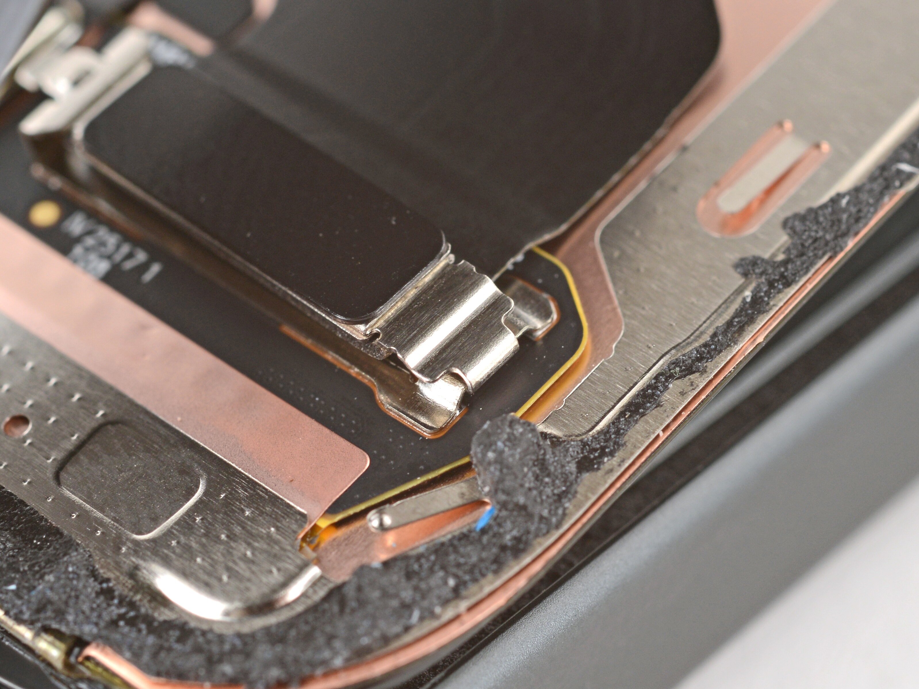

  9. Google Pixel 10 Screen Replacement, Remove the screen cable bracket: crwdns2935265:09crwdnd2935265:01crwdnd2935265:03crwdne2935265:0 Google Pixel 10 Screen Replacement, Remove the screen cable bracket: crwdns2935265:09crwdnd2935265:02crwdnd2935265:03crwdne2935265:0 Google Pixel 10 Screen Replacement, Remove the screen cable bracket: crwdns2935265:09crwdnd2935265:03crwdnd2935265:03crwdne2935265:0
    • Use the flat end of a spudger to push in the clip on the screen cable bracket until it releases.
    • Remove the bracket.

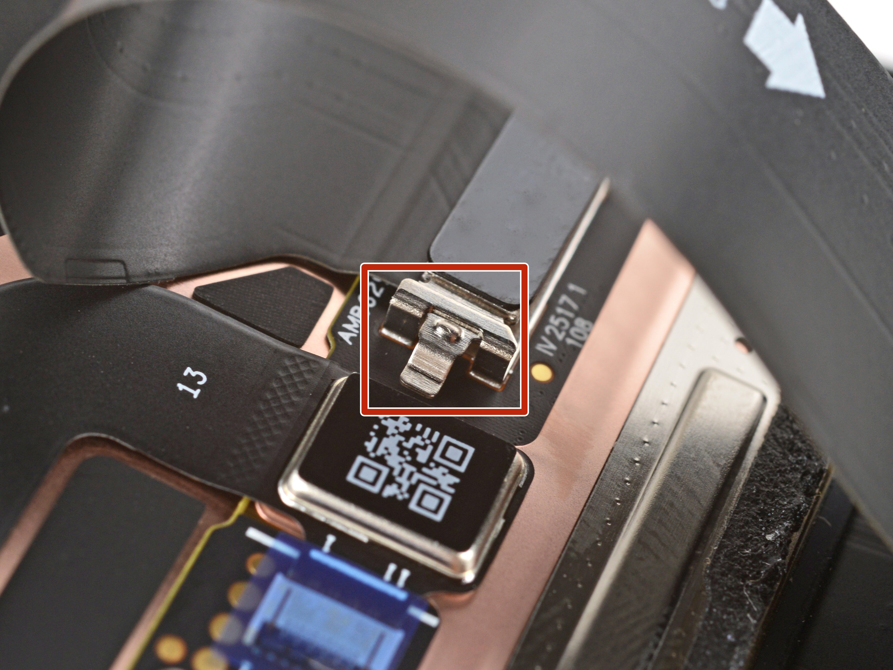

  10. Google Pixel 10 Screen Replacement, Disconnect the screen: crwdns2935265:010crwdnd2935265:01crwdnd2935265:02crwdne2935265:0 Google Pixel 10 Screen Replacement, Disconnect the screen: crwdns2935265:010crwdnd2935265:02crwdnd2935265:02crwdne2935265:0
  11. Google Pixel 10 Screen Replacement, Peel up the screen cable: crwdns2935265:011crwdnd2935265:01crwdnd2935265:02crwdne2935265:0 Google Pixel 10 Screen Replacement, Peel up the screen cable: crwdns2935265:011crwdnd2935265:02crwdnd2935265:02crwdne2935265:0
    • Grip the screen cable just above its connector and gently peel it up.

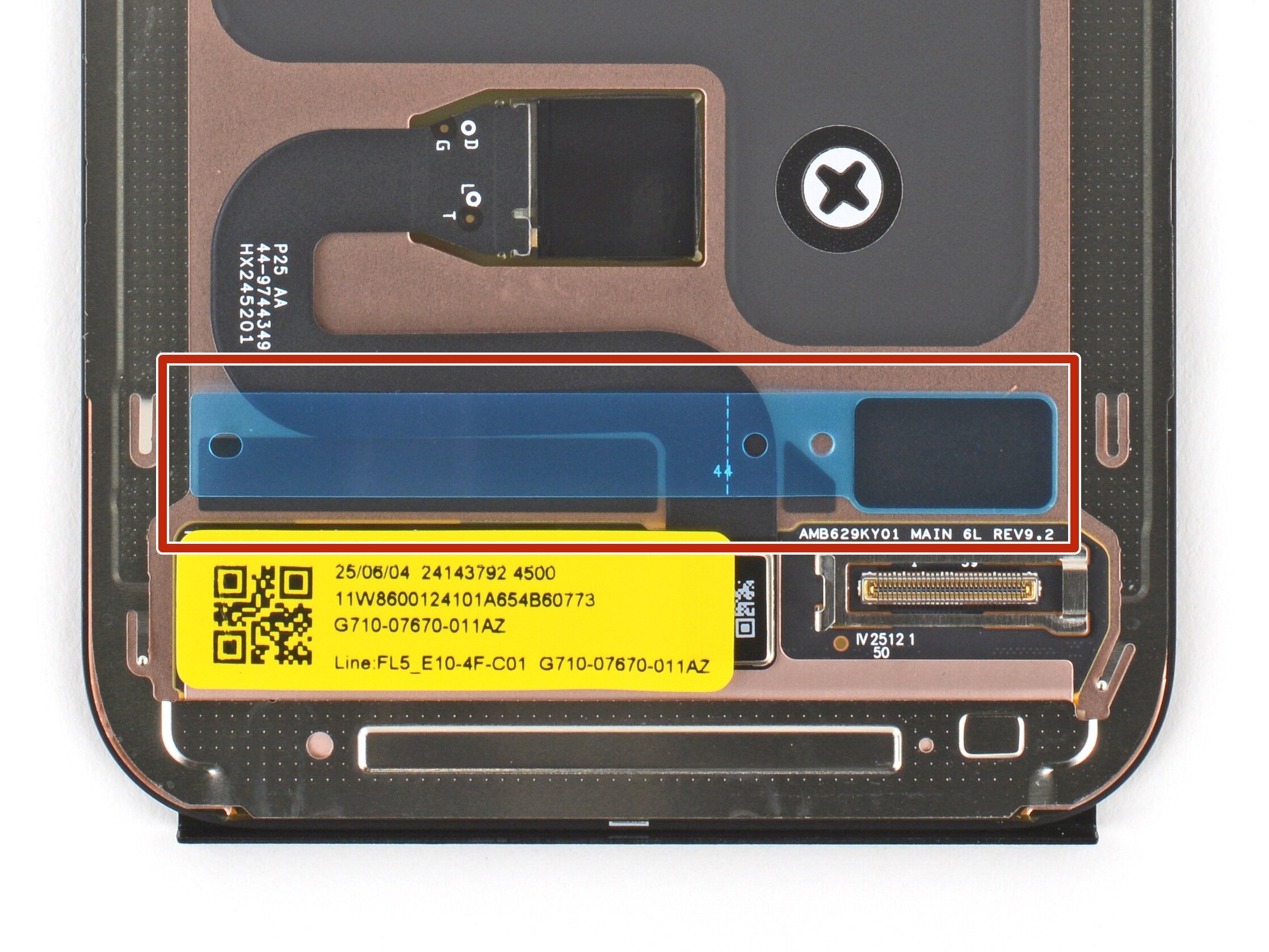

  25. Google Pixel 10 Screen Replacement, Remove the cable adhesive: crwdns2935265:025crwdnd2935265:01crwdnd2935265:02crwdne2935265:0 Google Pixel 10 Screen Replacement, Remove the cable adhesive: crwdns2935265:025crwdnd2935265:02crwdnd2935265:02crwdne2935265:0
    • If your new screen comes with cable adhesive installed just above the connector on the back of the screen, follow this step to remove the old adhesive. Otherwise, skip this step and leave the old adhesive.
    • Use a spudger to gently scrape up and remove the piece of adhesive on the screen cable, near the connector.
    • Be very careful not to damage the cable. Otherwise, your screen may not work.
