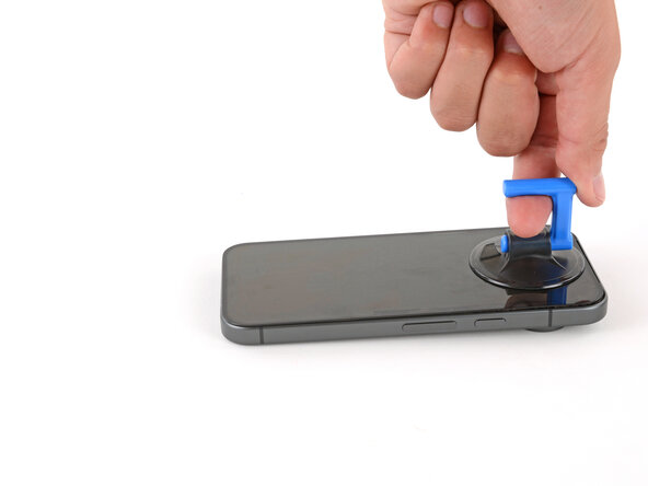

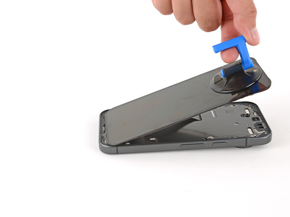

  4. Google Pixel 10 Screen Replacement, Apply a suction handle: crwdns2935265:04crwdnd2935265:01crwdnd2935265:02crwdne2935265:0 Google Pixel 10 Screen Replacement, Apply a suction handle: crwdns2935265:04crwdnd2935265:02crwdnd2935265:02crwdne2935265:0
    • Apply a suction handle to the center of the screen's top edge, as close to the edge as possible.
  5. Google Pixel 10 Screen Replacement, Insert an opening pick: crwdns2935265:05crwdnd2935265:01crwdnd2935265:03crwdne2935265:0 Google Pixel 10 Screen Replacement, Insert an opening pick: crwdns2935265:05crwdnd2935265:02crwdnd2935265:03crwdne2935265:0 Google Pixel 10 Screen Replacement, Insert an opening pick: crwdns2935265:05crwdnd2935265:03crwdnd2935265:03crwdne2935265:0
    • Inserting an opening pick is difficult. Be patient and reheat the screen at any point if it feels stuck.
    • Pull up on the suction handle with strong, steady force to create a gap between the screen and frame.
    • Insert the tip of an opening pick completely under the screen.
    • A metal panel is attached to the backside of the display. When inserting your pick, make sure it's underneath the metal, and not only under the glass—separating only the glass panel will make removal difficult.
    • Only insert the pick slightly (a few millimeters) to prevent damaging the front camera.

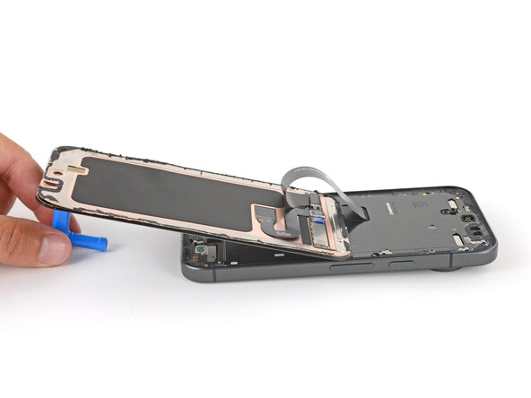

  8. Google Pixel 10 Screen Replacement, Prop up the screen: crwdns2935265:08crwdnd2935265:01crwdnd2935265:03crwdne2935265:0 Google Pixel 10 Screen Replacement, Prop up the screen: crwdns2935265:08crwdnd2935265:02crwdnd2935265:03crwdne2935265:0 Google Pixel 10 Screen Replacement, Prop up the screen: crwdns2935265:08crwdnd2935265:03crwdnd2935265:03crwdne2935265:0
    • Flip the top edge of the screen over the bottom edge and use the suction handle (or a sturdy object) to prop it up, so you have access to the screen cable connector.
    • If the screen still feels stuck, go back around the perimeter with an opening pick and separate any remaining adhesive.

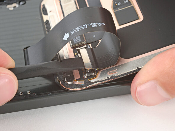

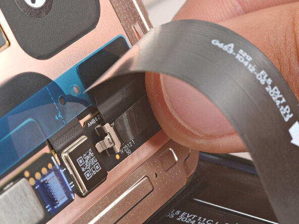

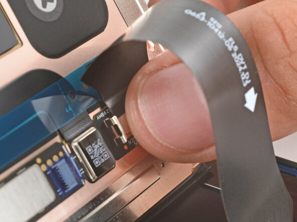

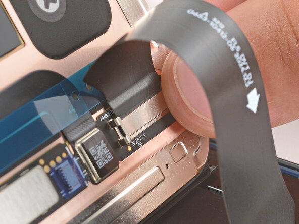

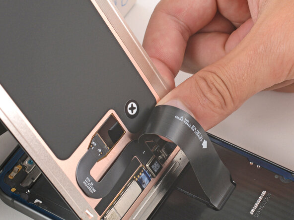

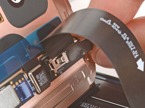

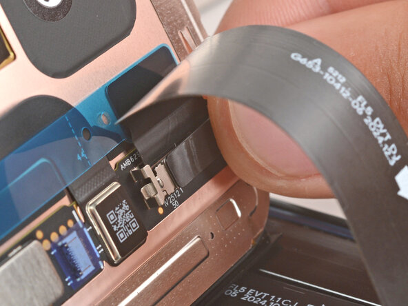

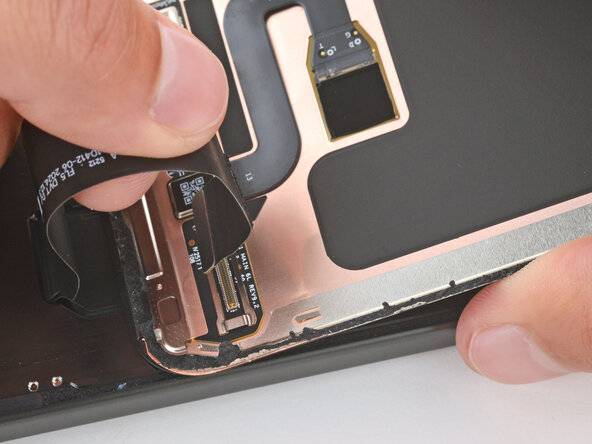

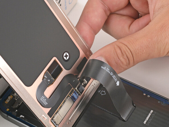

  10. Google Pixel 10 Screen Replacement, Disconnect the screen: crwdns2935265:010crwdnd2935265:01crwdnd2935265:02crwdne2935265:0 Google Pixel 10 Screen Replacement, Disconnect the screen: crwdns2935265:010crwdnd2935265:02crwdnd2935265:02crwdne2935265:0
  11. Google Pixel 10 Screen Replacement, Peel up the screen cable: crwdns2935265:011crwdnd2935265:01crwdnd2935265:02crwdne2935265:0 Google Pixel 10 Screen Replacement, Peel up the screen cable: crwdns2935265:011crwdnd2935265:02crwdnd2935265:02crwdne2935265:0
    • Grip the screen cable just above its connector and gently peel it up.
    • If you're having trouble, use a hair dryer or heat gun to lightly heat the cable.

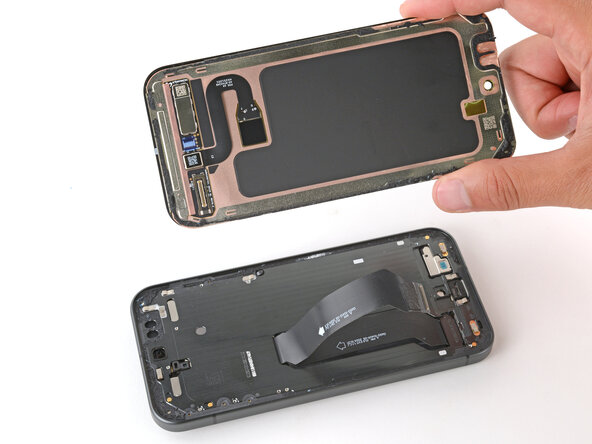

  12. Google Pixel 10 Screen Replacement, Remove the screen: crwdns2935265:012crwdnd2935265:01crwdnd2935265:01crwdne2935265:0
    • Remove the screen.

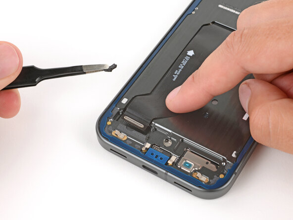

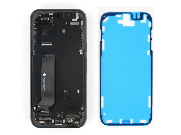

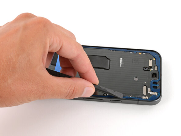

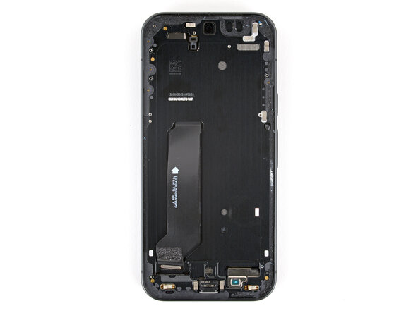

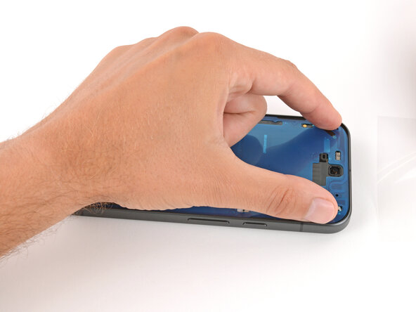

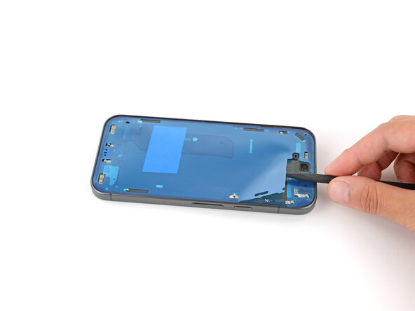

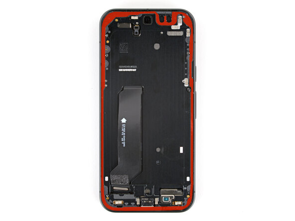

  13. Google Pixel 10 Screen Replacement, Clean the frame: crwdns2935265:013crwdnd2935265:01crwdnd2935265:02crwdne2935265:0 Google Pixel 10 Screen Replacement, Clean the frame: crwdns2935265:013crwdnd2935265:02crwdnd2935265:02crwdne2935265:0
    • Before installing adhesive, all the old adhesive must be completely removed from the frame.
    • Take your time during the next two steps. A clean frame allows replacement adhesive to lay totally flat, ensuring a better seal for your new screen.

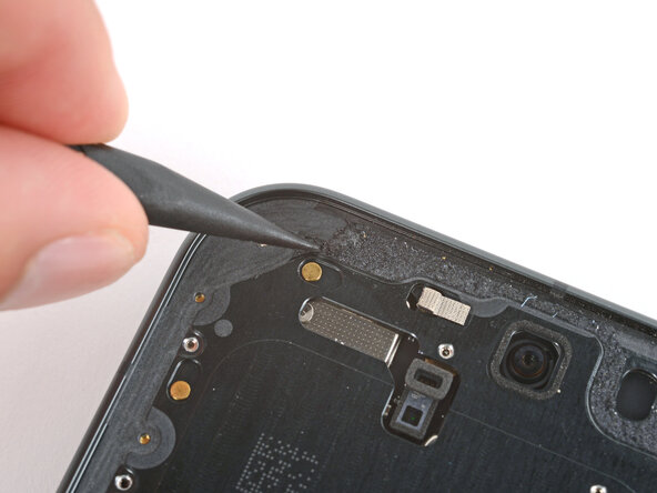

  14. Google Pixel 10 Screen Replacement: crwdns2935265:014crwdnd2935265:01crwdnd2935265:02crwdne2935265:0 Google Pixel 10 Screen Replacement: crwdns2935265:014crwdnd2935265:02crwdnd2935265:02crwdne2935265:0

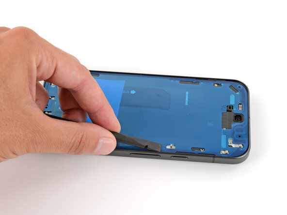

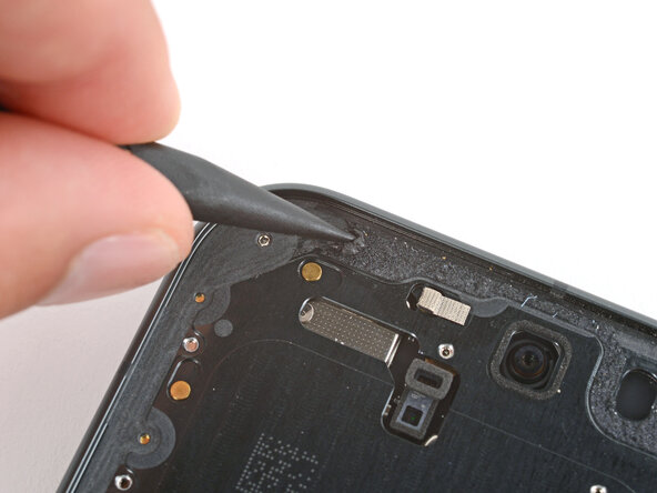

    • This step will take some time, as removing the adhesive can be very tricky.
    • Use the point of a spudger to remove all the old screen adhesive from the frame. Try to "roll" the adhesive onto itself so it balls up, making it easier to remove.

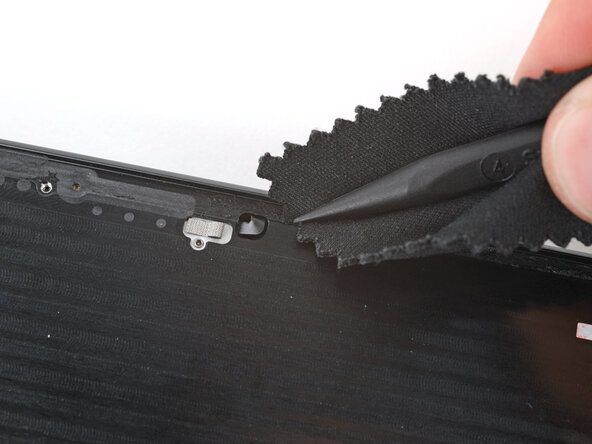

  15. Google Pixel 10 Screen Replacement: crwdns2935265:015crwdnd2935265:01crwdnd2935265:02crwdne2935265:0 Google Pixel 10 Screen Replacement: crwdns2935265:015crwdnd2935265:02crwdnd2935265:02crwdne2935265:0
    • Wrap a microfiber or lint‑free cloth around a spudger and apply a single drop of high‑concentration (>90%) isopropyl alcohol to the end.
    • Use the spudger to clean up all the remaining adhesive residue from the frame, applying more drops of alcohol as necessary.
    • Let the alcohol dry completely before continuing.

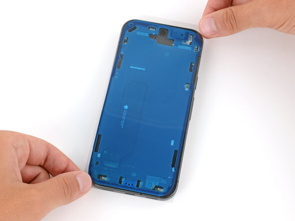

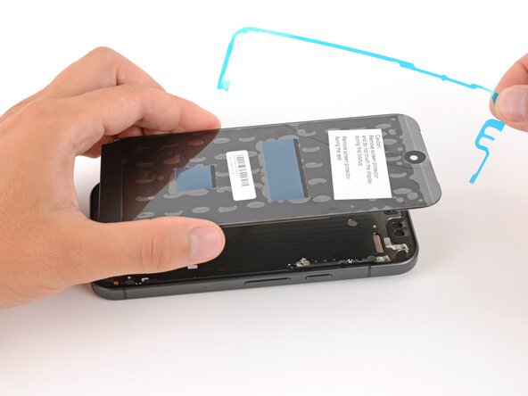

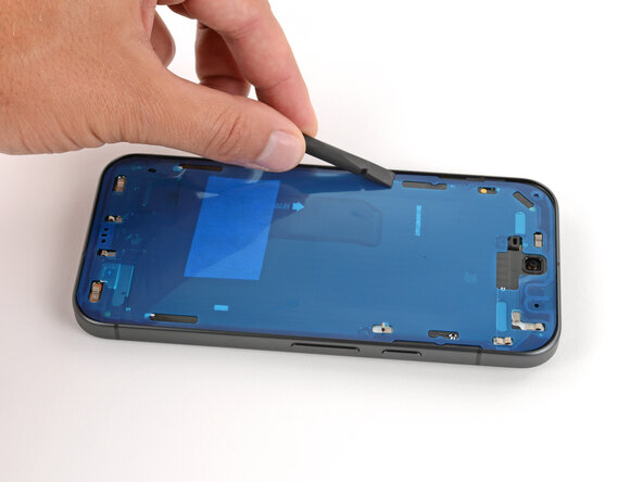

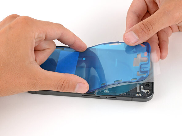

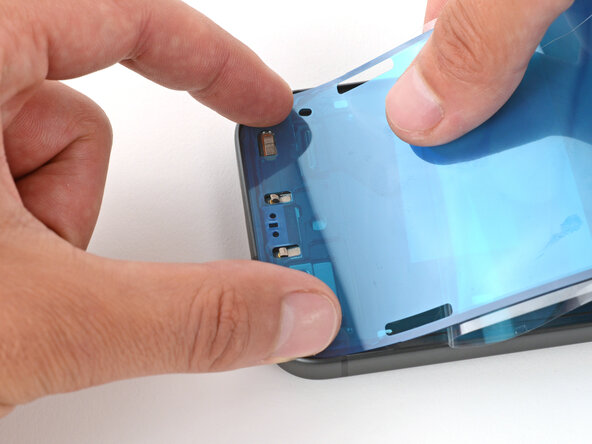

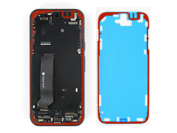

  16. Google Pixel 10 Screen Replacement, Orient the adhesive: crwdns2935265:016crwdnd2935265:01crwdnd2935265:03crwdne2935265:0 Google Pixel 10 Screen Replacement, Orient the adhesive: crwdns2935265:016crwdnd2935265:02crwdnd2935265:03crwdne2935265:0 Google Pixel 10 Screen Replacement, Orient the adhesive: crwdns2935265:016crwdnd2935265:03crwdnd2935265:03crwdne2935265:0
    • Before applying any adhesive, check if your replacement screen comes with adhesive pre‑installed around its perimeter. If it does, skip down nine steps. If it doesn't, follow the next nine steps to install new screen adhesive on the frame.
    • Before applying the screen adhesive, make sure you know how it will sit on the frame. If you apply the adhesive incorrectly, you'll need to restart with new adhesive.
    • Hold the adhesive above the frame to find its orientation. Use cutouts in the liner and the contours of the adhesive to help visualize how it will lay in the frame.

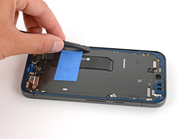

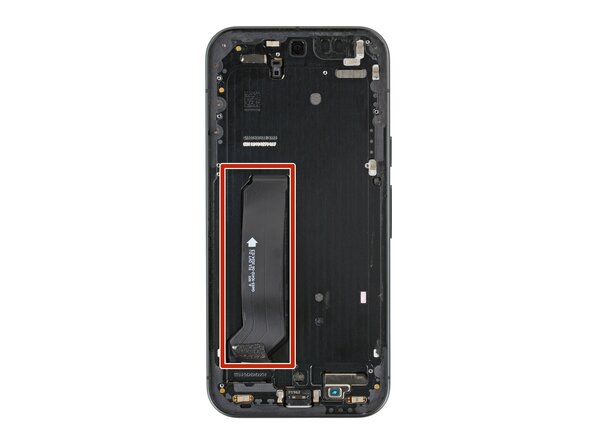

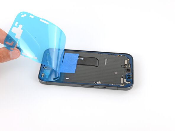

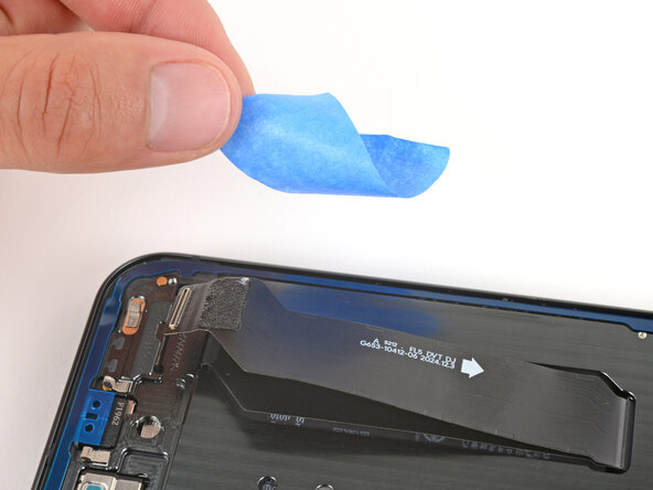

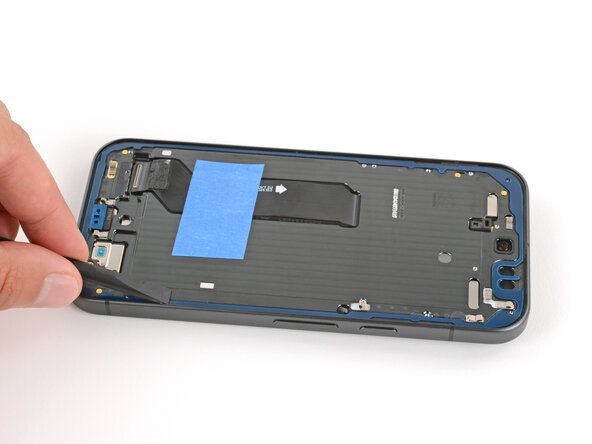

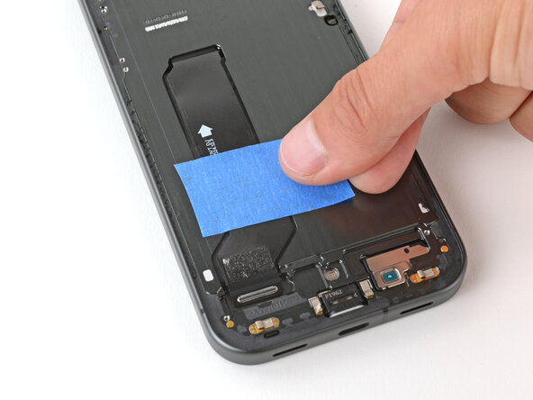

  17. Google Pixel 10 Screen Replacement, Tape the screen cable down: crwdns2935265:017crwdnd2935265:01crwdnd2935265:02crwdne2935265:0 Google Pixel 10 Screen Replacement, Tape the screen cable down: crwdns2935265:017crwdnd2935265:02crwdnd2935265:02crwdne2935265:0
    • The screen cable sticks up off the frame, making it difficult to apply new screen adhesive.
    • Tape the middle of the cable down to the frame, making sure the tape isn't covering anywhere the new adhesive will go.

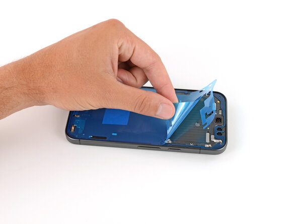

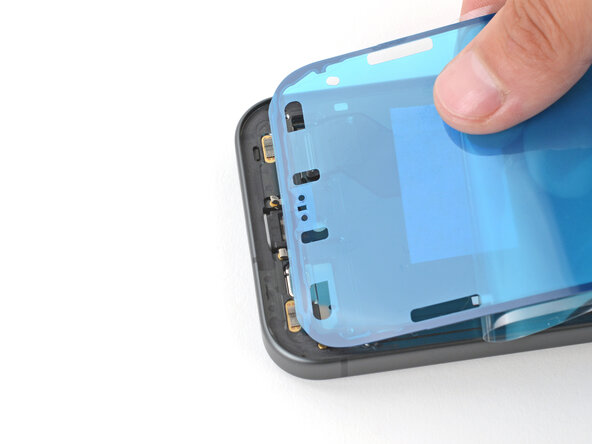

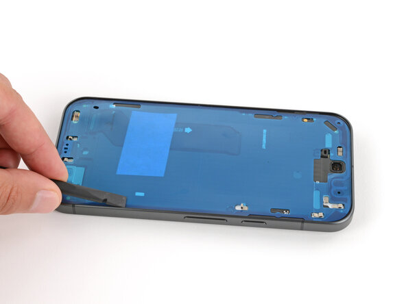

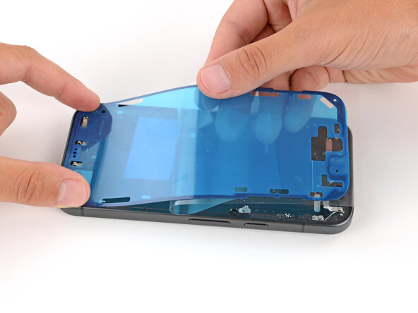

  18. Google Pixel 10 Screen Replacement, Apply the adhesive: crwdns2935265:018crwdnd2935265:01crwdnd2935265:01crwdne2935265:0
    • Peel up the bottom half of the large, clear liner to expose the adhesive—don't fully remove the liner yet.
  19. Google Pixel 10 Screen Replacement: crwdns2935265:019crwdnd2935265:01crwdnd2935265:03crwdne2935265:0 Google Pixel 10 Screen Replacement: crwdns2935265:019crwdnd2935265:02crwdnd2935265:03crwdne2935265:0 Google Pixel 10 Screen Replacement: crwdns2935265:019crwdnd2935265:03crwdnd2935265:03crwdne2935265:0
    • Take your time aligning the adhesive with the frame—it's very sticky and can't be moved after you apply it.
    • With the larger, clear liner folded towards the top of the phone, lay the exposed bottom edge of the adhesive onto the frame.
    • Use the lip of the frame to help align the adhesive.
    • Once the top edge is properly aligned, gently press down on the top corners to secure the adhesive.

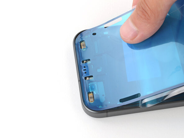

  20. Google Pixel 10 Screen Replacement: crwdns2935265:020crwdnd2935265:01crwdnd2935265:03crwdne2935265:0 Google Pixel 10 Screen Replacement: crwdns2935265:020crwdnd2935265:02crwdnd2935265:03crwdne2935265:0 Google Pixel 10 Screen Replacement: crwdns2935265:020crwdnd2935265:03crwdnd2935265:03crwdne2935265:0
    • Slowly lay the rest of the adhesive onto the frame, pressing it into place and peeling away the larger liner as you go.
  21. Google Pixel 10 Screen Replacement, Secure the adhesive: crwdns2935265:021crwdnd2935265:01crwdnd2935265:03crwdne2935265:0 Google Pixel 10 Screen Replacement, Secure the adhesive: crwdns2935265:021crwdnd2935265:02crwdnd2935265:03crwdne2935265:0 Google Pixel 10 Screen Replacement, Secure the adhesive: crwdns2935265:021crwdnd2935265:03crwdnd2935265:03crwdne2935265:0
    • Use a spudger to press down firmly on the screen adhesive to secure it to the frame.

  24. Google Pixel 10 Screen Replacement, Remove the tape: crwdns2935265:024crwdnd2935265:01crwdnd2935265:01crwdne2935265:0
    • Remove the tape securing the screen cable.

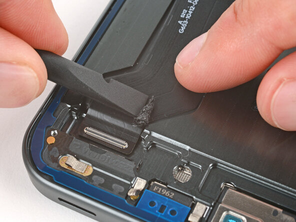

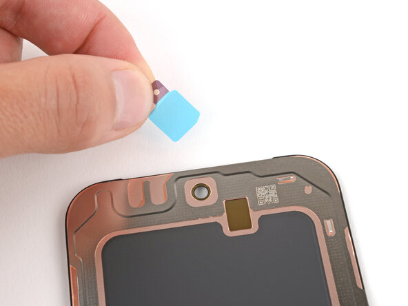

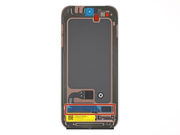

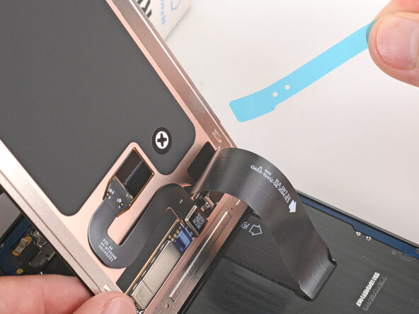

  25. Google Pixel 10 Screen Replacement, Remove the cable adhesive: crwdns2935265:025crwdnd2935265:01crwdnd2935265:02crwdne2935265:0 Google Pixel 10 Screen Replacement, Remove the cable adhesive: crwdns2935265:025crwdnd2935265:02crwdnd2935265:02crwdne2935265:0
    • If your new screen comes with cable adhesive installed just above the connector on the back of the screen, follow this step to remove the old adhesive. Otherwise, skip this step and leave the old adhesive.
    • Use a spudger to gently scrape up and remove the piece of adhesive on the screen cable, near the connector.
    • Be very careful not to damage the cable. Otherwise, your screen may not work.

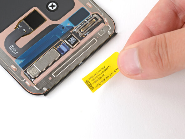

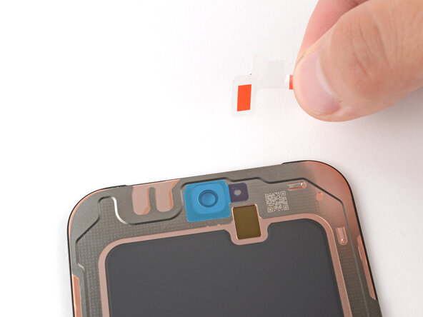

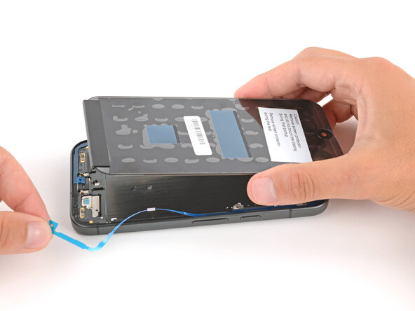

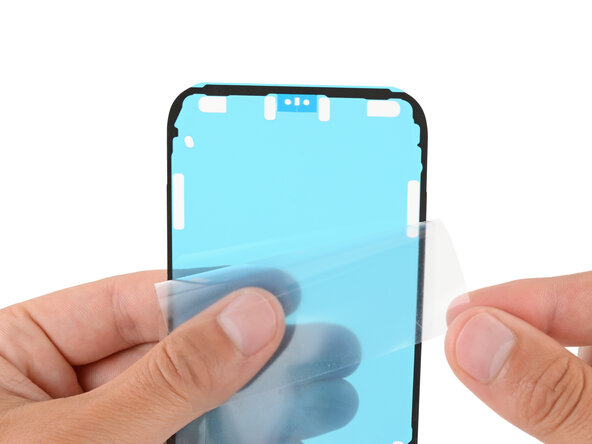

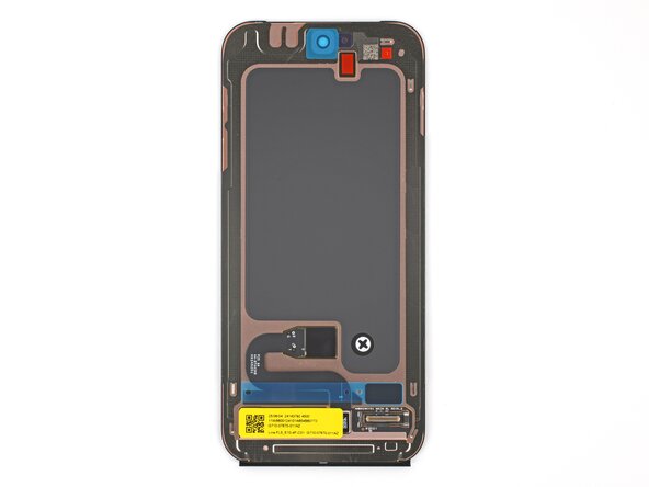

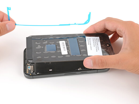

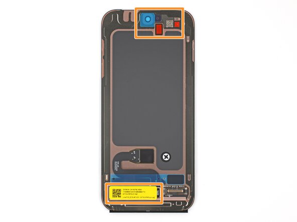

  26. Google Pixel 10 Screen Replacement, Check for plastic liners on the screen: crwdns2935265:026crwdnd2935265:01crwdnd2935265:03crwdne2935265:0 Google Pixel 10 Screen Replacement, Check for plastic liners on the screen: crwdns2935265:026crwdnd2935265:02crwdnd2935265:03crwdne2935265:0 Google Pixel 10 Screen Replacement, Check for plastic liners on the screen: crwdns2935265:026crwdnd2935265:03crwdnd2935265:03crwdne2935265:0
    • Your replacement screen has various protective liners and pieces of tape on the underside that must be removed before installation. Your screen may have different pieces in different locations, so make sure to check carefully!
    • Don't remove the screen cable adhesive liner near the bottom of the screen yet—you'll do so after reconnecting the cable.
    • Check around the front facing camera cutout, and near the bottom edge of the screen—you'll remove these in the next step.
    • Usually, you can identify the liners by their pull tabs.
  27. Google Pixel 10 Screen Replacement, Remove screen liners: crwdns2935265:027crwdnd2935265:01crwdnd2935265:03crwdne2935265:0 Google Pixel 10 Screen Replacement, Remove screen liners: crwdns2935265:027crwdnd2935265:02crwdnd2935265:03crwdne2935265:0 Google Pixel 10 Screen Replacement, Remove screen liners: crwdns2935265:027crwdnd2935265:03crwdnd2935265:03crwdne2935265:0
    • The exposed back of the screen is very fragile—even a small scratch can cause damage. Be very careful not to damage the screen during the remaining steps.
    • Use your fingers or tweezers to remove the plastic liners and tape from the back of the screen.

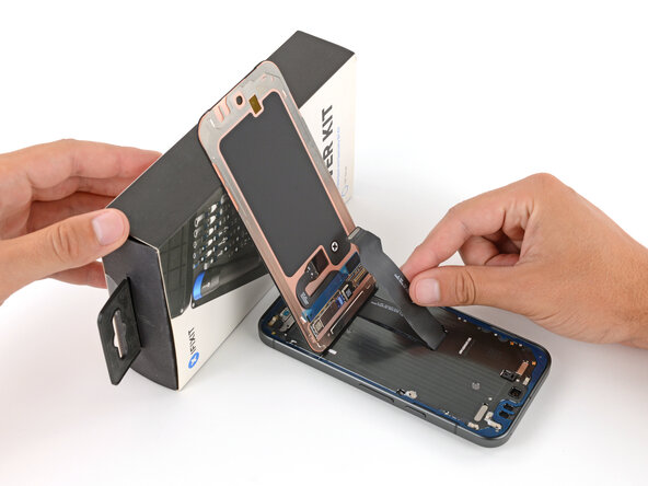

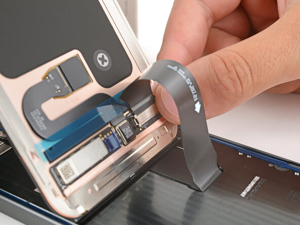

  28. Google Pixel 10 Screen Replacement, Prop up the screen: crwdns2935265:028crwdnd2935265:01crwdnd2935265:01crwdne2935265:0
    • Use a sturdy object to prop up the screen so you can reconnect its cable.
    • Make sure the screen is oriented so it's in the proper position when you flip it back down.

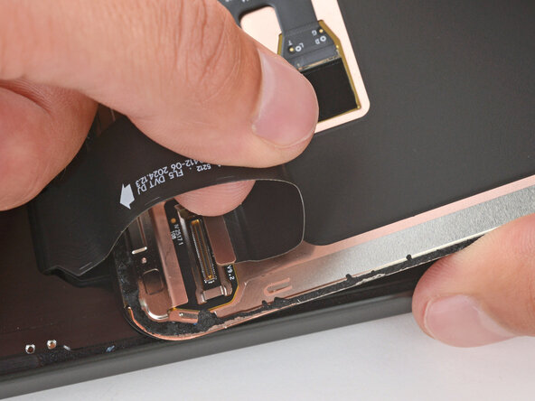

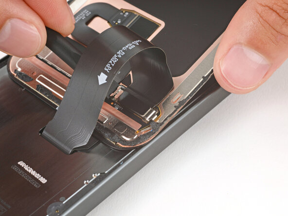

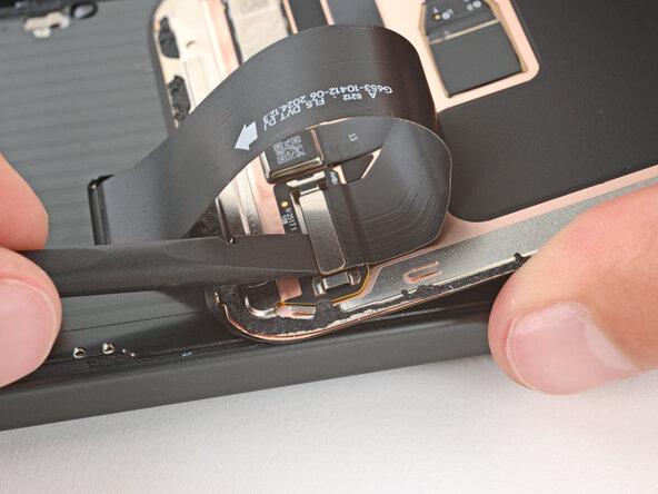

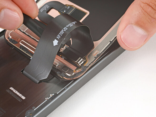

  29. Google Pixel 10 Screen Replacement, Connect the screen: crwdns2935265:029crwdnd2935265:01crwdnd2935265:03crwdne2935265:0 Google Pixel 10 Screen Replacement, Connect the screen: crwdns2935265:029crwdnd2935265:02crwdnd2935265:03crwdne2935265:0 Google Pixel 10 Screen Replacement, Connect the screen: crwdns2935265:029crwdnd2935265:03crwdnd2935265:03crwdne2935265:0
    • Loop the screen cable around and use your fingers to reconnect the press connector, pressing on one side first and then the other.

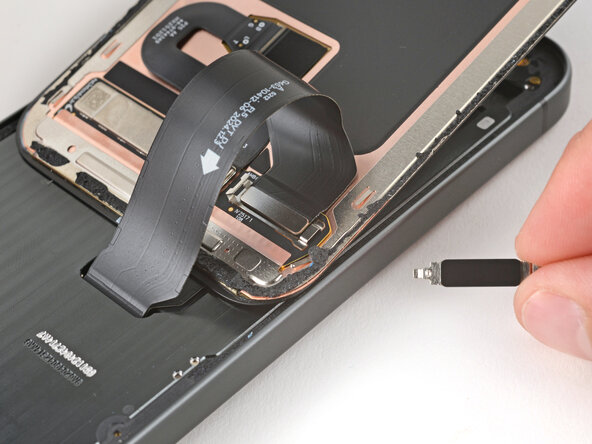

  30. Google Pixel 10 Screen Replacement, Install the bracket: crwdns2935265:030crwdnd2935265:01crwdnd2935265:03crwdne2935265:0 Google Pixel 10 Screen Replacement, Install the bracket: crwdns2935265:030crwdnd2935265:02crwdnd2935265:03crwdne2935265:0 Google Pixel 10 Screen Replacement, Install the bracket: crwdns2935265:030crwdnd2935265:03crwdnd2935265:03crwdne2935265:0
    • Insert the small arm of the screen cable bracket into its slot next to the connector.
    • Press down on the bracket and slide it into place until it clicks, making sure the outer edge hooks into place.

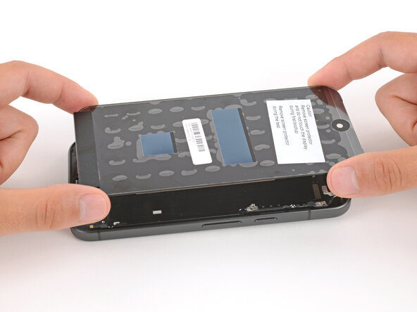

  32. Google Pixel 10 Screen Replacement, Remove the remaining liners: crwdns2935265:032crwdnd2935265:01crwdnd2935265:03crwdne2935265:0 Google Pixel 10 Screen Replacement, Remove the remaining liners: crwdns2935265:032crwdnd2935265:02crwdnd2935265:03crwdne2935265:0 Google Pixel 10 Screen Replacement, Remove the remaining liners: crwdns2935265:032crwdnd2935265:03crwdnd2935265:03crwdne2935265:0
    • Flip the screen down and hold it above the frame.
    • Remove all remaining liners from the adhesive (either on the frame, or from the underside of the screen).
  33. Google Pixel 10 Screen Replacement, Install the new screen: crwdns2935265:033crwdnd2935265:01crwdnd2935265:03crwdne2935265:0 Google Pixel 10 Screen Replacement, Install the new screen: crwdns2935265:033crwdnd2935265:02crwdnd2935265:03crwdne2935265:0 Google Pixel 10 Screen Replacement, Install the new screen: crwdns2935265:033crwdnd2935265:03crwdnd2935265:03crwdne2935265:0
    • Firmly push the screen into place on the frame.

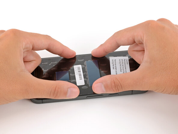

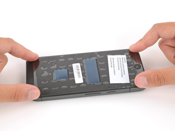

  34. Google Pixel 10 Screen Replacement: crwdns2935265:034crwdnd2935265:01crwdnd2935265:03crwdne2935265:0 Google Pixel 10 Screen Replacement: crwdns2935265:034crwdnd2935265:02crwdnd2935265:03crwdne2935265:0 Google Pixel 10 Screen Replacement: crwdns2935265:034crwdnd2935265:03crwdnd2935265:03crwdne2935265:0
    • Hold your phone up and squeeze firmly around the perimeter to strengthen the adhesive bond.
    • For an even stronger bond, you can stack books on the back glass or use screen vise clamps.
    • Before powering on your Pixel for the first time, lay the phone screen-side up on a clean, flat surface. Remove the plastic liner from the screen, making sure nothing touches the phone while you do so (fingers, screen protectors, or cases).
    • Follow any other specific instructions that may be on the screen's adhesive liner.
