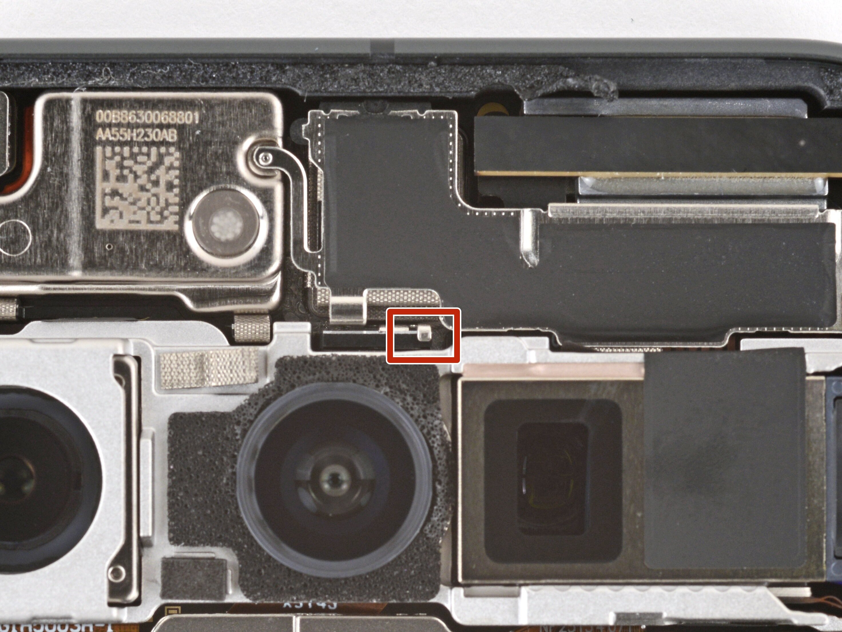

  19. Google Pixel 10 Rear Cameras Replacement, Remove the front camera bracket: crwdns2935265:019crwdnd2935265:01crwdnd2935265:02crwdne2935265:0 Google Pixel 10 Rear Cameras Replacement, Remove the front camera bracket: crwdns2935265:019crwdnd2935265:02crwdnd2935265:02crwdne2935265:0
    • Use a Torx Plus 3IP screwdriver to remove the 5.0 mm‑long screw securing the front camera bracket.
  20. Google Pixel 10 Rear Cameras Replacement, Remove the bracket: crwdns2935265:020crwdnd2935265:01crwdnd2935265:03crwdne2935265:0 Google Pixel 10 Rear Cameras Replacement, Remove the bracket: crwdns2935265:020crwdnd2935265:02crwdnd2935265:03crwdne2935265:0 Google Pixel 10 Rear Cameras Replacement, Remove the bracket: crwdns2935265:020crwdnd2935265:03crwdnd2935265:03crwdne2935265:0
    • Use the point of a spudger to push the front camera bracket's clip in and up to release it.
    • Remove the bracket.
