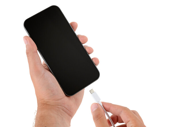

  1. Google Pixel 10 Battery Replacement, Prepare your Pixel for disassembly: crwdns2935265:01crwdnd2935265:01crwdnd2935265:01crwdne2935265:0
    • Unplug all cables from your phone.
    • Let your Pixel's battery drain completely (until it dies) before starting this repair. A charged lithium‑ion battery may catch fire if damaged.

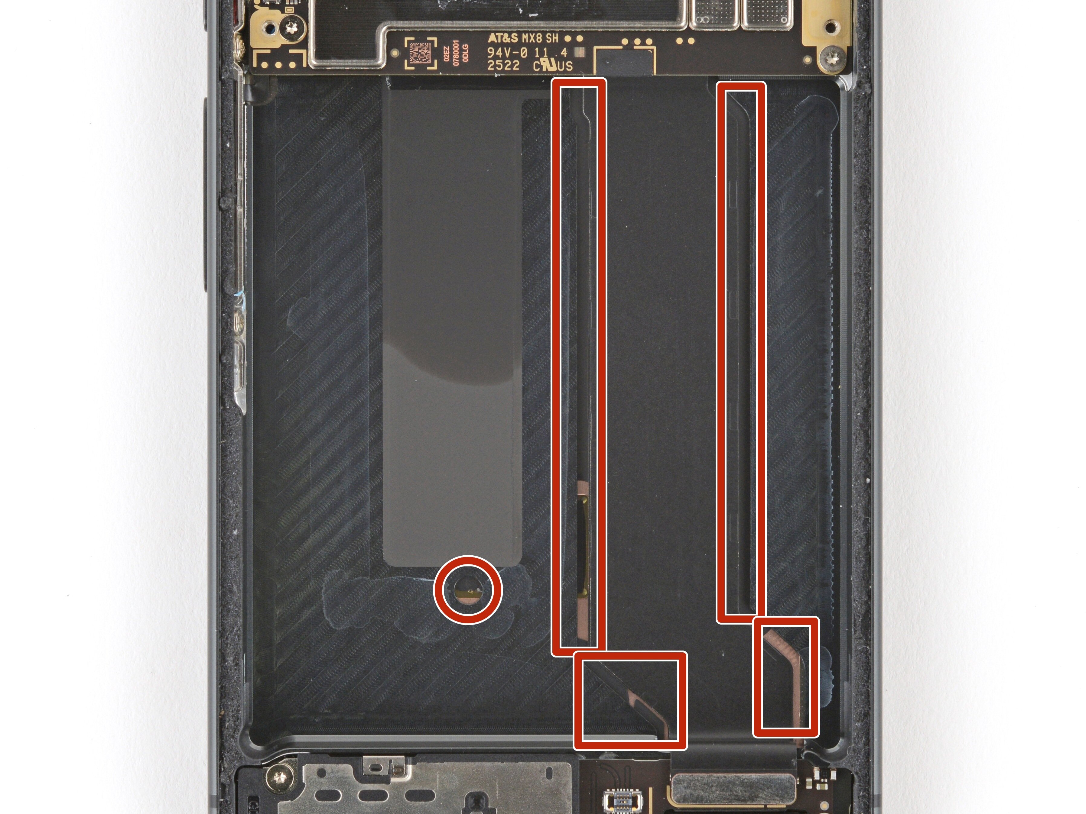

  6. Google Pixel 10 Battery Replacement, Back glass adhesive information: crwdns2935265:06crwdnd2935265:01crwdnd2935265:03crwdne2935265:0 Google Pixel 10 Battery Replacement, Back glass adhesive information: crwdns2935265:06crwdnd2935265:02crwdnd2935265:03crwdne2935265:0 Google Pixel 10 Battery Replacement, Back glass adhesive information: crwdns2935265:06crwdnd2935265:03crwdnd2935265:03crwdne2935265:0
    • The back glass is secured with adhesive around the perimeter of the frame. Use this picture as a reference while you separate the adhesive.
    • A cable connects the back glass near the power button. Don't insert your pick here to avoid damaging the cable.

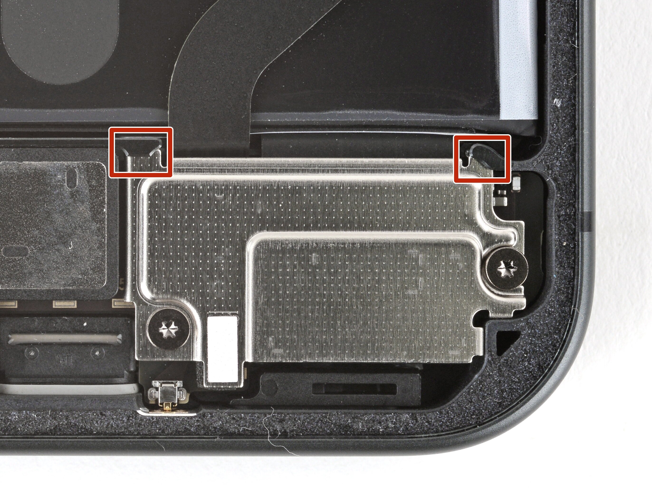

  37. Google Pixel 10 Battery Replacement, Install the USB‑C board cover: crwdns2935265:037crwdnd2935265:01crwdnd2935265:03crwdne2935265:0 Google Pixel 10 Battery Replacement, Install the USB‑C board cover: crwdns2935265:037crwdnd2935265:02crwdnd2935265:03crwdne2935265:0 Google Pixel 10 Battery Replacement, Install the USB‑C board cover: crwdns2935265:037crwdnd2935265:03crwdnd2935265:03crwdne2935265:0
    • Put the USB‑C board cover back into place, sliding the tabs on the top corners under their hooks.
  38. Google Pixel 10 Battery Replacement: crwdns2935265:038crwdnd2935265:01crwdnd2935265:02crwdne2935265:0 Google Pixel 10 Battery Replacement: crwdns2935265:038crwdnd2935265:02crwdnd2935265:02crwdne2935265:0
    • Use a Torx Plus 3IP screwdriver to install the two 5.0 mm‑long screws securing the USB‑C board cover.

  47. Google Pixel 10 Battery Replacement, Install the graphite sheet: crwdns2935265:047crwdnd2935265:01crwdnd2935265:03crwdne2935265:0 Google Pixel 10 Battery Replacement, Install the graphite sheet: crwdns2935265:047crwdnd2935265:02crwdnd2935265:03crwdne2935265:0 Google Pixel 10 Battery Replacement, Install the graphite sheet: crwdns2935265:047crwdnd2935265:03crwdnd2935265:03crwdne2935265:0
    • Lay the graphite sheet into place, so the circular portion is over the battery, and the cutouts on the top edge go into the grooves on the motherboard cover.
    • Use your fingers to press down firmly on the entire surface of the sheet to secure it.
  48. Google Pixel 10 Battery Replacement: crwdns2935265:048crwdnd2935265:01crwdnd2935265:03crwdne2935265:0 Google Pixel 10 Battery Replacement: crwdns2935265:048crwdnd2935265:02crwdnd2935265:03crwdne2935265:0 Google Pixel 10 Battery Replacement: crwdns2935265:048crwdnd2935265:03crwdnd2935265:03crwdne2935265:0
    • Slowly peel up and remove the remaining liner.
    • If the sheet starts to peel up with the liner, press it back into place and try again.

  63. Google Pixel 10 Battery Replacement, Install the bracket: crwdns2935265:063crwdnd2935265:01crwdnd2935265:03crwdne2935265:0 Google Pixel 10 Battery Replacement, Install the bracket: crwdns2935265:063crwdnd2935265:02crwdnd2935265:03crwdne2935265:0 Google Pixel 10 Battery Replacement, Install the bracket: crwdns2935265:063crwdnd2935265:03crwdnd2935265:03crwdne2935265:0
    • Put the cable's bracket back in place, making sure the tab on the right edge goes under its groove.
  64. Google Pixel 10 Battery Replacement: crwdns2935265:064crwdnd2935265:01crwdnd2935265:02crwdne2935265:0 Google Pixel 10 Battery Replacement: crwdns2935265:064crwdnd2935265:02crwdnd2935265:02crwdne2935265:0
    • Use a Torx Plus 3IP screwdriver to install the two 5.0 mm‑long screws securing the bracket.
