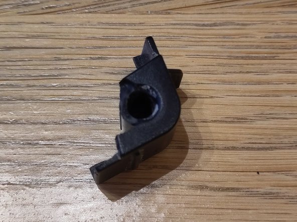

    • After removing the plastic cover, you can easily remove 3 parts. They may also fall out partially when the cover is removed.
    • Remove the marked parts and put them aside.

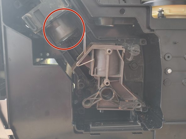

  4. Dismantling the Melitta Caffeo CI brew group in the appliance: crwdns2935265:05crwdnd2935265:01crwdnd2935265:02crwdne2935265:0 Dismantling the Melitta Caffeo CI brew group in the appliance: crwdns2935265:05crwdnd2935265:02crwdnd2935265:02crwdne2935265:0
    • The chamber for the coffee powder is probably in the position shown in picture 1 (red circle). You can carefully try to move the brewing chamber downwards by turning the axle (orange circle) with slight force.
    • It may not be possible to turn the axle accordingly, as it is connected to the motor on the other side.
    • The first goal is to get into the position shown in picture 2. Also in picture 2 you can see the plunger that was in the brewing chamber (red circle).
    • If it is not possible to get the brewing chamber into the position shown in picture 2, then proceed to the next steps.

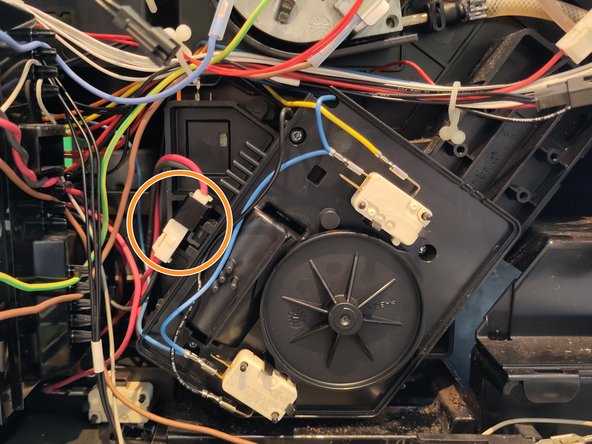

  5. Dismantling the Melitta Caffeo CI brew group in the appliance, (Optional) Releasing the motor connection - Part 1: crwdns2935265:06crwdnd2935265:01crwdnd2935265:03crwdne2935265:0 Dismantling the Melitta Caffeo CI brew group in the appliance, (Optional) Releasing the motor connection - Part 1: crwdns2935265:06crwdnd2935265:02crwdnd2935265:03crwdne2935265:0 Dismantling the Melitta Caffeo CI brew group in the appliance, (Optional) Releasing the motor connection - Part 1: crwdns2935265:06crwdnd2935265:03crwdnd2935265:03crwdne2935265:0
    • Only carry out this step if it is really necessary. In other words, if the brewing chamber could not be brought into position in the previous step. As mentioned at the beginning, it may be necessary to remove the housing depending on the situation. Now you are ready, please follow the instructions linked to previously.

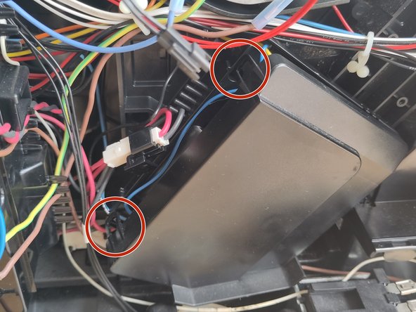

    • The black cover has 4 clips. Pry open the clips at the red mark, then the clips at the orange mark should be easy to open if you bend the cover slightly (Fig. 2).
    • To be on the safe side, take a photo of the position of the wheel, this could be important when reassembling.
    • Pull off the wheel (Fig. 3, orange marking), it could be tight. The two white switches (Fig. 3, yellow marking) are each attached with 2 clips; loosen these.
    • Remove the 3 Tx10 screws (Fig. 3, red marking) and remove the plastic cover. Careful here since parts could fall out.

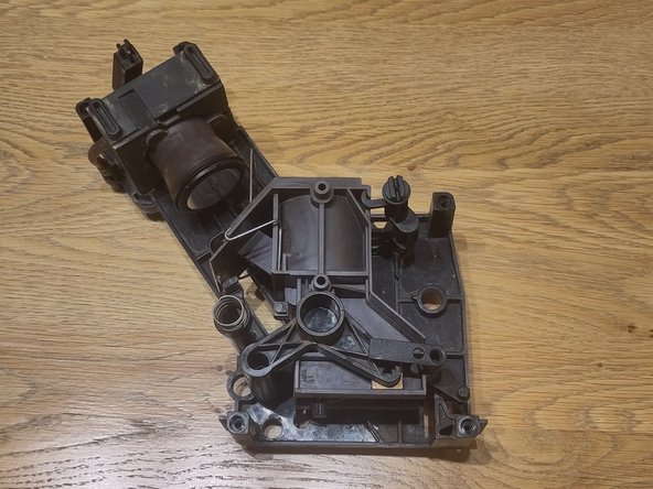

  7. Dismantling the Melitta Caffeo CI brew group in the appliance, Removing the coffee chamber: crwdns2935265:08crwdnd2935265:01crwdnd2935265:02crwdne2935265:0 Dismantling the Melitta Caffeo CI brew group in the appliance, Removing the coffee chamber: crwdns2935265:08crwdnd2935265:02crwdnd2935265:02crwdne2935265:0
    • The coffee chamber (red arrow) can be in various positions. However, it cannot be removed in any position. Please compare both pictures in this step. The coffee chamber can also be so high that the upper sieve (top left in the picture) is not visible.
    • There are 2 adjustment options for the mechanism. Depending on the position, you need both or only one. There is the rotation axis (yellow arrow) and there is a tappet that is somewhat hidden (orange arrow).
    • Use these two adjustment options to set the mechanism so that it can be removed.
    • The second picture shows the position in which the brew group can be removed, including the rear part of the housing.
    • In the next step, you can see all the individual parts that you should then have. This might help with orientation.
  8. Dismantling the Melitta Caffeo CI brew group in the appliance, Overview of individual parts: crwdns2935265:09crwdnd2935265:01crwdnd2935265:01crwdne2935265:0
    • This is just an overview of all the individual parts you have so far. The brew group has now been completely removed from the machine.

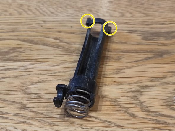

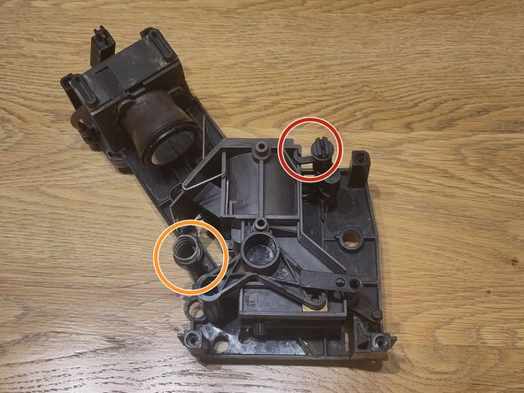

  9. Dismantling the Melitta Caffeo CI brew group in the appliance, Inserting the coffee chamber and bar: crwdns2935265:010crwdnd2935265:01crwdnd2935265:03crwdne2935265:0 Dismantling the Melitta Caffeo CI brew group in the appliance, Inserting the coffee chamber and bar: crwdns2935265:010crwdnd2935265:02crwdnd2935265:03crwdne2935265:0 Dismantling the Melitta Caffeo CI brew group in the appliance, Inserting the coffee chamber and bar: crwdns2935265:010crwdnd2935265:03crwdnd2935265:03crwdne2935265:0
    • The first step is to insert the coffee chamber. The chamber can only be inserted in one position. See Fig. 1, paying particular attention to the red marking to ensure that the chamber is down to the stop. Now turn the chamber to the position shown in picture 2.
    • When the coffee chamber is in the correct position, turn the locking mechanism to the closed position (red circle, Fig. 2).
    • Now put on the bar (orange circle, Fig. 2). Pay attention to the two small pins (yellow circles, fig. 3). These must be inserted into the holes in the housing. There is only one correct position. Turn the bar 180 degrees and you'll see that the tiller is in the housing once and once not. Select the position in which the tiller is in the housing.

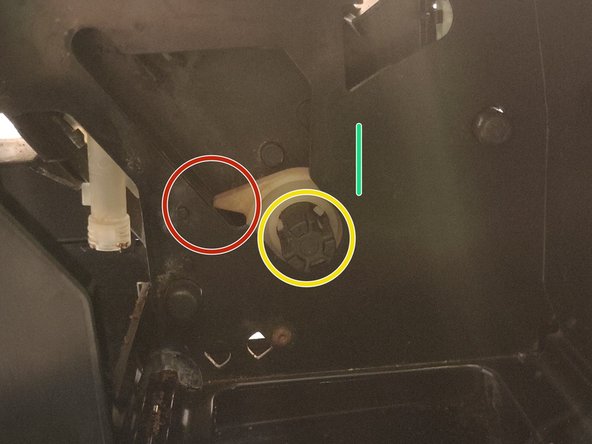

  13. Dismantling the Melitta Caffeo CI brew group in the appliance, Check home position: crwdns2935265:015crwdnd2935265:01crwdnd2935265:03crwdne2935265:0 Dismantling the Melitta Caffeo CI brew group in the appliance, Check home position: crwdns2935265:015crwdnd2935265:02crwdnd2935265:03crwdne2935265:0 Dismantling the Melitta Caffeo CI brew group in the appliance, Check home position: crwdns2935265:015crwdnd2935265:03crwdnd2935265:03crwdne2935265:0
    • The machine has a home position. The brew group can only be inserted or removed in this basic position. If the brew group could not be removed, there are many indications that it cannot be inserted correctly.
    • Even if it can be inserted mechanically, it could be in the wrong position internally. It is advised to not place the machine into operation without further testing.
    • Figure 1 shows the basic position on the motor side. The black wheel has cams, please make sure that they are facing the switches as shown in the red circles in picture 1.
    • Disconnect the plug (orange circle in picture 2) and control the motor with 12V DC voltage. The voltage must be applied to the plug part which is still attached to the black housing. Plus/minus can be swapped for the forward and return of the motor. A 9V block battery may also be sufficient.
    • A certain position must be set on the side of the brewing group at the same time. The yellow circle shows the axis of the motor shaft. This has 3 grooves that engage in the white driver. This means that when the motor is in the basic position, there are only 3 different positions for the white driver.
    • On the picture in the red circle you can see a hook, the actual driver. This position is not the basic position, it is only photographed so that you can see the hook. This hook must be in the approximate position of the green line.
    • It is important that the basic position on the motor side and on the brew group side prevail at the same time. Previously taken photos may help, otherwise try out the 3 possible (as there are 3 grooves) positions. Or pay attention to the photos here and already roughly align the axle when inserting it.

Hallo
Bei mir hat der Haken(Mitnehmer) in der Grundstellung eine komplett andere Lage. Die Brühgruppe lässt sich auch nicht einsetzen.
Was könnte das Problem sein?
Würde mich über Hilfe freuen.
Lh
Laurin - crwdns2934203:0crwdne2934203:0
Siehe Schritt 15, alle Teile müssen in der richtigen Position sein. Sprich auseinander bauen und wieder richtig einbauen. Insbesondere auf den grünen Strich achten im vierten Bild in Schritt 15.
