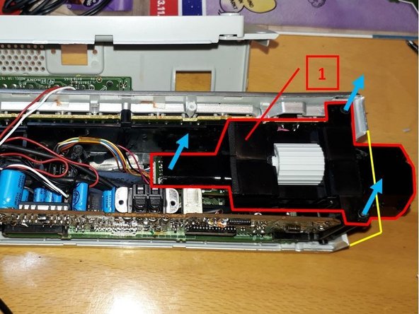

    • First disconnect the cable connector [1] by pulling it out. Below the ribbon cable [2] you can also reach the projector LED, which can be tested e.g. with the diode test of a multimeter. After that, removing the projector unit becomes complicated.
    • I found no other solution than to cut out one side of the case. Since you can't pull off the cover of the magnifier unit outside the housing, you have no choice but to cut the housing at the passage of the rotating magnifier unit so that you can pull the complete projector up afterwards.
    • In the last picture of this step you can see the cut out side part as well as the cover cap for the magnifier unit. The cap can only be removed after disassembling the projector by cutting it on the opposite side from the magnifier. However, the cap does not have to be removed at all to disassemble the projector!

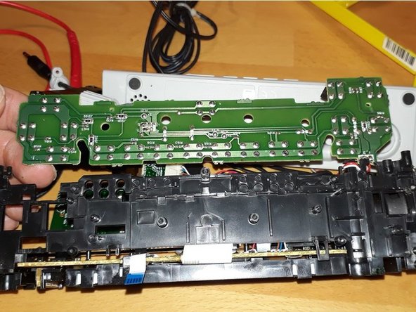

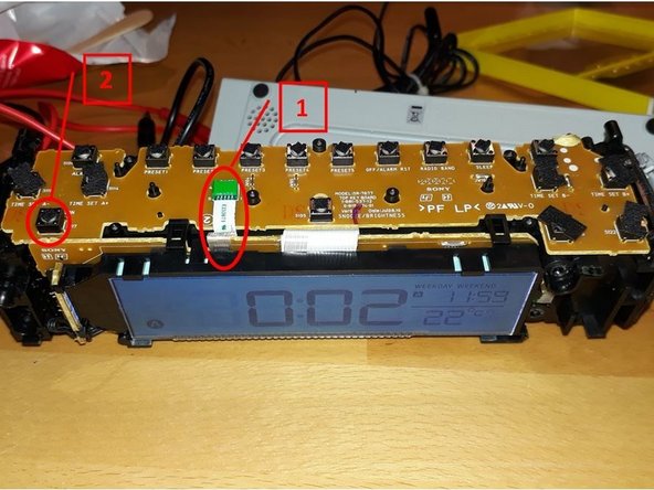

  6. Disassembly of Sony Dream Machine ICF-C717PJ, Exposing the control board: crwdns2935265:06crwdnd2935265:01crwdnd2935265:03crwdne2935265:0 Disassembly of Sony Dream Machine ICF-C717PJ, Exposing the control board: crwdns2935265:06crwdnd2935265:02crwdnd2935265:03crwdne2935265:0 Disassembly of Sony Dream Machine ICF-C717PJ, Exposing the control board: crwdns2935265:06crwdnd2935265:03crwdnd2935265:03crwdne2935265:0
    • To remove the three-part keyboard, unscrew the marked screws. The middle keyboard part can be removed only after removing the small left and right keyboard parts. Attention, some screws may be covered by stickers.
    • The control board with the soldered micro pushbuttons is connected to the control board by means of a five-core ribbon cable [1]. This can easily be pulled out of the green socket. The marked button [2] is the button for switching the projector on and off.
    • When the ribbon cable is pulled out, the control board can be turned over easily and you can replace e.g. micro pushbuttons.
    • On my unit, I found a broken cable in the ribbon cable, which was routed somewhat awkwardly. Replacing the cable is difficult, especially because it is soldered on the motherboard relatively filigree. Therefore, I soldered a bypass only for the defective conductor and left the ribbon cable.

Vielen Dank für die tolle Anleitung! Mein Projektor funktionierte nicht mehr, ich hatte auf eine defekte LED getippt, war aber der Taster. Ich habe allerdings ein Service Manual von Sony im Netz gefunden, nach dem man den Projektor zerstörungsfrei ausbauen kann. Man muss dazu eine 3 mm-Stahlstange (ich hab einen langen Inbus-Schlüssel genommen) zwischen Linse und Gehäuse fest auf den Tubus drücken, dann springt die Linse heraus und der silberne Tubus kann entfernt werden. Danach lässt sich der gesamt Projektor problemlos nach innen herausschwenken.

Vielen Dank, so etwas habe ich damals leider nicht gefunden. Ich habe mir das PDF gleich abgespeichert. Der Projektor läuft bei mir immer noch tadellos. Es hat sich rausgestellt, dass es die Taste war und ich habe da einfach ein paar Lötstellen an den Mikroschaltern erneuert oder sogar den Schalter ausgetauscht.
