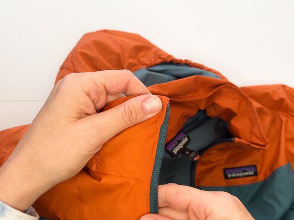

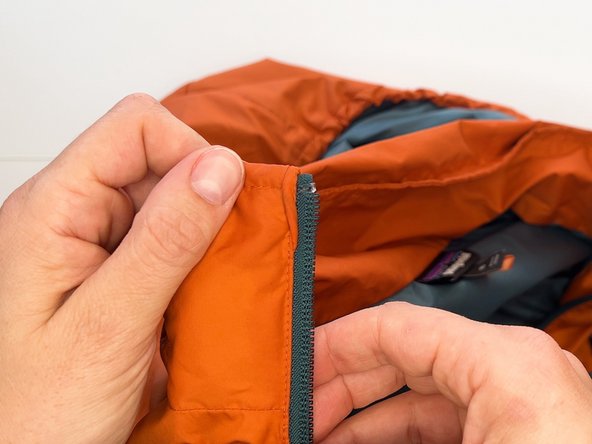

    2. Coil Zipper Slider Replacement, Locate the top stop: crwdns2935265:02crwdnd2935265:01crwdnd2935265:03crwdne2935265:0 Coil Zipper Slider Replacement, Locate the top stop: crwdns2935265:02crwdnd2935265:02crwdnd2935265:03crwdne2935265:0 Coil Zipper Slider Replacement, Locate the top stop: crwdns2935265:02crwdnd2935265:03crwdnd2935265:03crwdne2935265:0
      • Unzip the zipper.
      • Locate the top stop at the top of the zipper on the side with the slider.
      • The top stop is a piece of plastic or metal that keeps the slider from coming off the top of the zipper.
      • Peel back any fabric that is covering the top stop.
      • Wear safety glasses to protect from projectile pieces.
      • Use end nippers or flush cutters to remove the top stop.
      • To avoid cutting the zipper tape, position the nippers to cut off only the very edge of the stop, then peel away the rest of the stop from the zipper tape.
      • Use a lighter to singe frayed or damaged zipper tape.
      • Slide the damaged zipper slider up and off the zipper tape.
      • Discard the zipper slider responsibly.
      • Making sure the new slider is oriented correctly, slide it onto the zipper tape.
      • Patagonia Repair Tech Tip: Maneuver the slider as if parallel parking a car. Start at an angle, back it onto the zipper tape, and then straighten out. This step can take practice, patience, and a little muscle!
      • Once the slider is on the zipper, test zipping up the jacket to make sure it's the right slider type and that the issue is fixed.
      • Place the top stop on the flat, tape side of the zipper, aligning the double-prong side of the stop to face the jacket and the single-prong side to face the zipper teeth.
      • Slide the single-prong beneath the first or second tooth at the top of the zipper tape.
      • Push the double-prongs through the zipper tape so they emerge on the opposite side, on the inside of the coil.
      • Use pliers to bend the prongs of the stop inward, clamping them around the zipper coil. The prongs will grab into the coil, securing it in place.
      • Check that the new stop effectively prevents the new slider from coming off the zipper.
