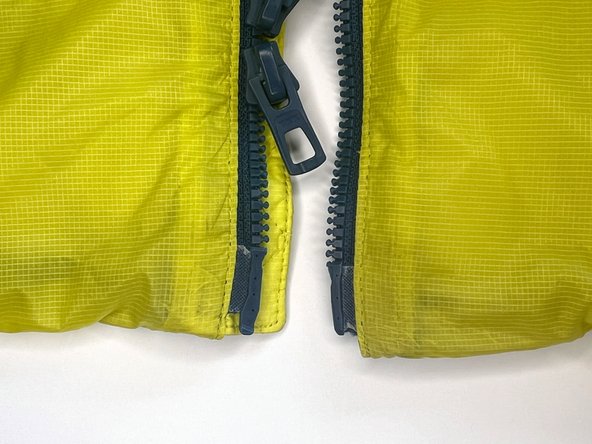

      • The most common jacket zipper sizes are 3, 4, 45, and 5. These numbers are based on the approximate width of the closed zipper teeth in millimeters, so increasing numbers correspond with increasing size.
      • The size is the first number on the back of the slider (reference image #2). Sometimes the size is also on the the zipper box (reference image #3).
      • If there's no identifying number (or the slider is missing) measure the width of the closed zipper teeth in millimeters.
      • Size 3 ~ 3 mm, Size 4 ~ 4 mm, Size 45 ~ 4.5 mm, Size 5 ~ 5 mm

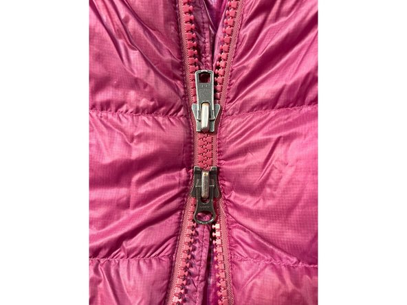

      • Dual zippers (also referred to as two-way zippers) have two sliders:
      • One that unzips from the top
      • One that's oriented upside down and unzips from the bottom
      • Importantly, these zippers don't have a zipper box (reference image #3).
      • If an issue occurs with a dual zipper, first check that both sliders are present at the bottom of the zipper. The top slider can migrate up the zipper tape and the zipper won't fasten with only the bottom slider.

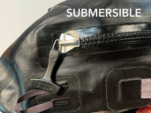

    9. Zipper Identification, Coated and submersible: crwdns2935265:010crwdnd2935265:01crwdnd2935265:02crwdne2935265:0 Zipper Identification, Coated and submersible: crwdns2935265:010crwdnd2935265:02crwdnd2935265:02crwdne2935265:0
      • Coated zippers are coated with TPU so that the tape is water‑resistant.
      • Submersible zippers are fully waterproof and are designed to retain water-tightness when dunked under water. Most often, this technical function can't be maintained in repair.
