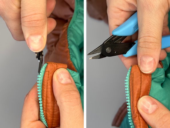

    2. Advanced No-Sew Zipper Repair Techniques, SKILL: Top stop removal: crwdns2935265:03crwdnd2935265:01crwdnd2935265:03crwdne2935265:0 Advanced No-Sew Zipper Repair Techniques, SKILL: Top stop removal: crwdns2935265:03crwdnd2935265:02crwdnd2935265:03crwdne2935265:0 Advanced No-Sew Zipper Repair Techniques, SKILL: Top stop removal: crwdns2935265:03crwdnd2935265:03crwdnd2935265:03crwdne2935265:0
      • Application - Factory-applied top stops can be removed to release sliders from the zipper tape.
      • Skill - Use flush cutters to nip off the edge of the plastic, then peel the rest of the plastic away.
      • Wear safety glasses.
      • Try to avoid cutting or damaging the zipper tape.

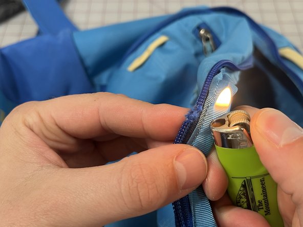

      • Singe frayed or damaged zipper tape with a lighter.

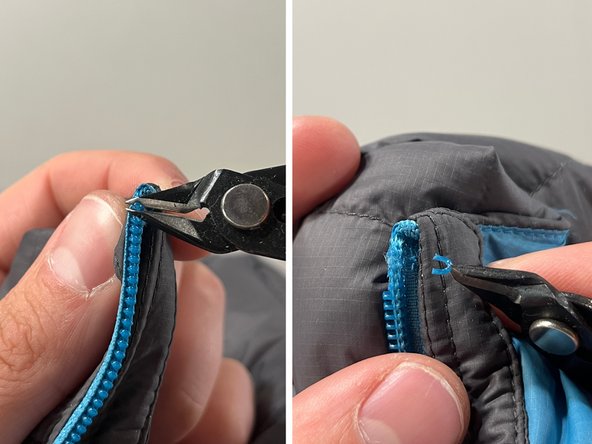

    3. Advanced No-Sew Zipper Repair Techniques, SKILL: Cutting zipper teeth: crwdns2935265:04crwdnd2935265:01crwdnd2935265:03crwdne2935265:0 Advanced No-Sew Zipper Repair Techniques, SKILL: Cutting zipper teeth: crwdns2935265:04crwdnd2935265:02crwdnd2935265:03crwdne2935265:0 Advanced No-Sew Zipper Repair Techniques, SKILL: Cutting zipper teeth: crwdns2935265:04crwdnd2935265:03crwdnd2935265:03crwdne2935265:0
      • Application - Cutting zipper teeth is a valuable skill that can help with all sorts of zipper repairs.
      • Wear safety goggles.
      • Plastic Tooth - Use flush cutters to snip along the edge of the teeth, then peel the rest of the tooth away from the tape.
      • Coil - Use flush cutters to snip along the edge of the teeth, then pull out the back side of each coil with needle nose pliers.

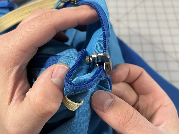

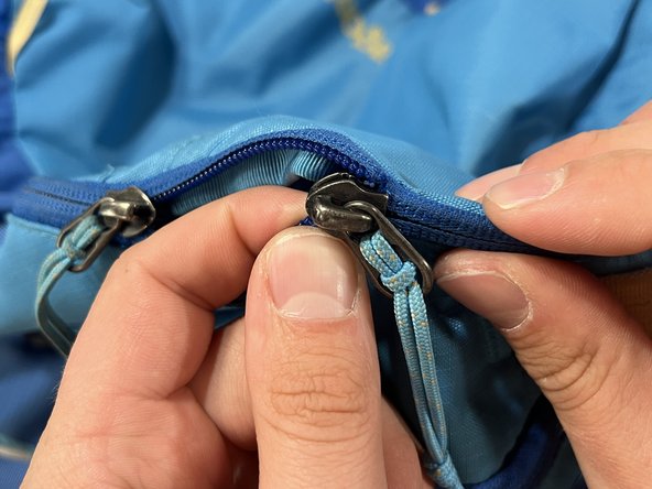

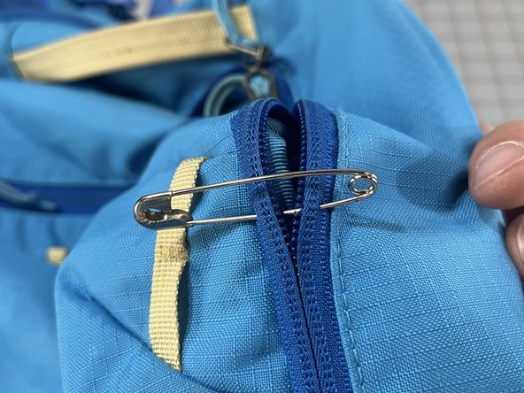

    6. Advanced No-Sew Zipper Repair Techniques, SKILL: Fastening zippers by hand: crwdns2935265:09crwdnd2935265:01crwdnd2935265:03crwdne2935265:0 Advanced No-Sew Zipper Repair Techniques, SKILL: Fastening zippers by hand: crwdns2935265:09crwdnd2935265:02crwdnd2935265:03crwdne2935265:0 Advanced No-Sew Zipper Repair Techniques, SKILL: Fastening zippers by hand: crwdns2935265:09crwdnd2935265:03crwdnd2935265:03crwdne2935265:0
      • Application - Many repair techniques require split zippers to be refastened before the fix is applied. To achieve this, the zipping function of slider can be mimicked by hand.
      • Skill - Begin where the zipper teeth first start to split and use your fingers to manipulate the teeth back together (reference the video in Step 10).
      • Use a safety pin through the tape to capture progress and to keep the zipper from re-separating (reference image #2).
      • A FixnZip is a handy tool that can also be used to fasten a section of zipper back together (reference image #3).
      • Reference this video to see the technique in action.

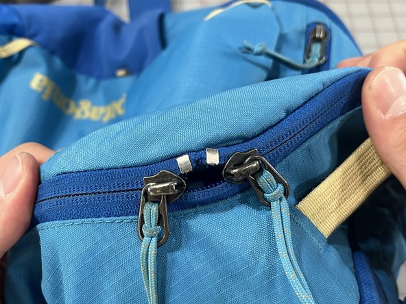

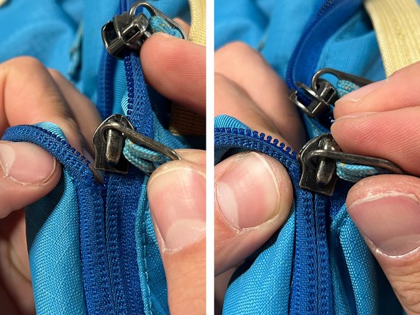

    9. Advanced No-Sew Zipper Repair Techniques, TECHNIQUE: Isolating zipper teeth damage - Packs: crwdns2935265:013crwdnd2935265:01crwdnd2935265:03crwdne2935265:0 Advanced No-Sew Zipper Repair Techniques, TECHNIQUE: Isolating zipper teeth damage - Packs: crwdns2935265:013crwdnd2935265:02crwdnd2935265:03crwdne2935265:0 Advanced No-Sew Zipper Repair Techniques, TECHNIQUE: Isolating zipper teeth damage - Packs: crwdns2935265:013crwdnd2935265:03crwdnd2935265:03crwdne2935265:0
      • Issue - There's damage to the zipper on a backpack.
      • Technique - Isolate each slider to one side of the damage so the damage location will become the place where the sliders meet.
      • It's likely that the sliders have come unconnected from the damaged side.
      • Use the skill in Steps 9 and 10 to refasten the zipper teeth on both sides of the damage.
      • Use the skill in Step 11 to retrack both sliders onto the zipper at the damaged area.
      • Place a coil top stop at the damaged area with the sides of the zipper either together or apart depending on preference.
      • This technique is the quick fix alternative to a Backpack Zipper Replacement.
