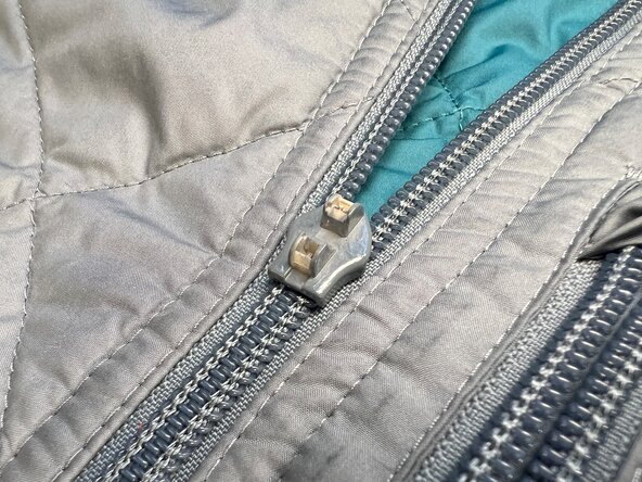

    2. Coil Zipper Issue Diagnosis, ISSUE: Splitting: crwdns2935265:02crwdnd2935265:01crwdnd2935265:02crwdne2935265:0 Coil Zipper Issue Diagnosis, ISSUE: Splitting: crwdns2935265:02crwdnd2935265:02crwdnd2935265:02crwdne2935265:0
      • A common issue is the zipper tape splitting after the slider has been pulled up. This could be because the pin wasn't inserted all the way into the box and the sides of the tape are misaligned.
      • Carefully unzip the zipper and then check for debris in the zipper box.
      • Reinsert the pin into the zipper box, ensuring that it is in as far as possible, and re-zip the zipper.
      • If this method doesn't work or the slider is missing entirely, it's likely that a Coil Zipper Slider Replacement will fix the issue.
      • First, check that Steps 4 - 7 do not apply to the zipper and then proceed with the slider replacement.
    3. Coil Zipper Issue Diagnosis, ISSUE: Damaged slider: crwdns2935265:03crwdnd2935265:01crwdnd2935265:01crwdne2935265:0
      • A common issue for a coil zipper is slider damage:
      • If the slider is missing its pull tab or crown, it will be difficult to pull up.
      • A loose slider won't keep the teeth together effectively and they will split open after the slider has been pulled up.
      • A compacted slider will be too tight and it will be difficult to pull up the slider.
      • If any of these are the case, or if the slider is missing entirely, it's likely that a Coil Zipper Slider Replacement will fix the issue.
      • First check that Steps 4 - 7 do not apply to the zipper and then proceed with the slider replacement.

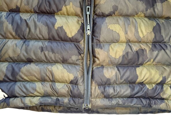

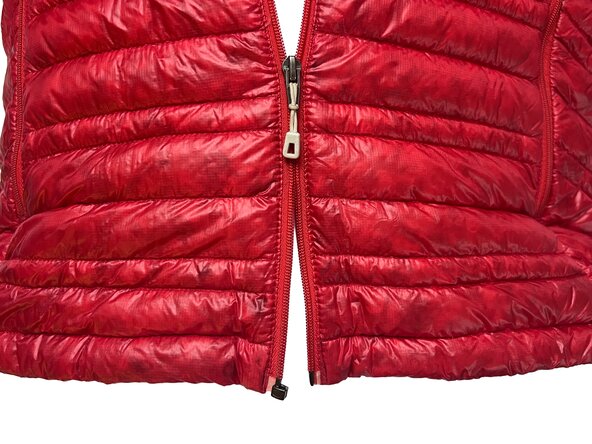

    4. Coil Zipper Issue Diagnosis, ISSUE: Missing zipper box or pin: crwdns2935265:04crwdnd2935265:01crwdnd2935265:02crwdne2935265:0 Coil Zipper Issue Diagnosis, ISSUE: Missing zipper box or pin: crwdns2935265:04crwdnd2935265:02crwdnd2935265:02crwdne2935265:0
      • The zipper in the first photo is missing the zipper box at the bottom where the pin is inserted. The zipper in the second photo is missing the zipper pin. The only way to permanently fix these issues is to replace the entire zipper line.
