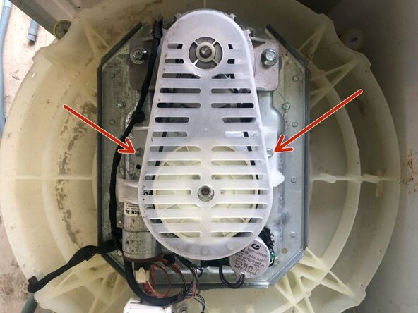

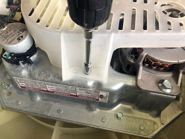

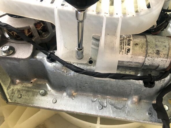

    • Not shown here is that you need to unplug the washer as well as disconnect the water supply hoses prior to working on it! First the pulley cover has to be removed. It is attached via two 5/16 bolts
    • First the pulley cover has to be removed. It is attached via two 5/16 bolts
    • Use an electric screwdriver with a short extension and a 5/16 socket to remove the right screw,
    • followed by the left screw, is easiest. A hand ratchet or a nut driver will of course work as well.

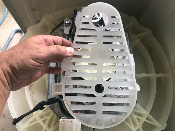

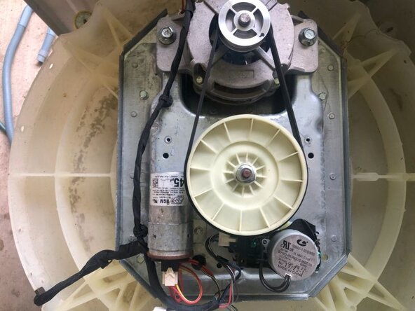

    • Remove the pulley cover
    • Now clearly visible are motor, pulley for the drive (clutch/splutch is underneath), shift actuator and start capacitor for the motor

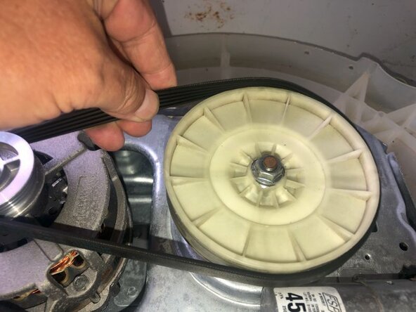

    • To remove the drive belt, lift one side up and then pulling it to the drive pulley while continuing to pull up on it. The belt will eventually run off the pulley
  3. Amana Washing Machine NTW4516FW Motor Replacement: crwdns2935265:03crwdnd2935265:01crwdnd2935265:03crwdne2935265:0 Amana Washing Machine NTW4516FW Motor Replacement: crwdns2935265:03crwdnd2935265:02crwdnd2935265:03crwdne2935265:0 Amana Washing Machine NTW4516FW Motor Replacement: crwdns2935265:03crwdnd2935265:03crwdnd2935265:03crwdne2935265:0

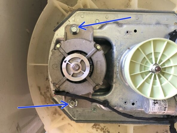

    • Belt is now removed

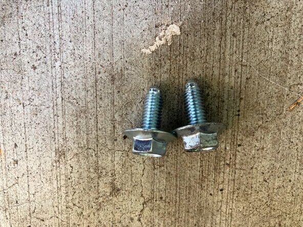

    • The motor is held to the housing by two 13mm machine bolts
    • I am using a 13mm socket to remove one,
  4. Amana Washing Machine NTW4516FW Motor Replacement: crwdns2935265:04crwdnd2935265:01crwdnd2935265:03crwdne2935265:0 Amana Washing Machine NTW4516FW Motor Replacement: crwdns2935265:04crwdnd2935265:02crwdnd2935265:03crwdne2935265:0 Amana Washing Machine NTW4516FW Motor Replacement: crwdns2935265:04crwdnd2935265:03crwdnd2935265:03crwdne2935265:0
    • and then the other bolt

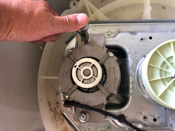

    • Both bolts are identical

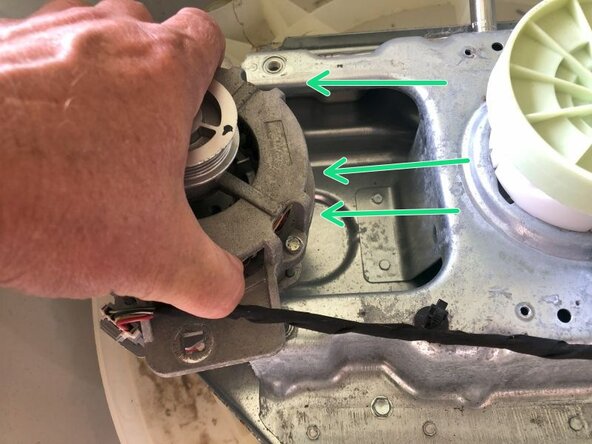

    • The motor is still boxed in the housing. Slide it to the outside
  5. Amana Washing Machine NTW4516FW Motor Replacement: crwdns2935265:05crwdnd2935265:01crwdnd2935265:03crwdne2935265:0 Amana Washing Machine NTW4516FW Motor Replacement: crwdns2935265:05crwdnd2935265:02crwdnd2935265:03crwdne2935265:0 Amana Washing Machine NTW4516FW Motor Replacement: crwdns2935265:05crwdnd2935265:03crwdnd2935265:03crwdne2935265:0
    • and then lift it up. There is enough length of the electrical cable to allow for this movement.

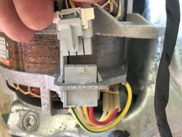

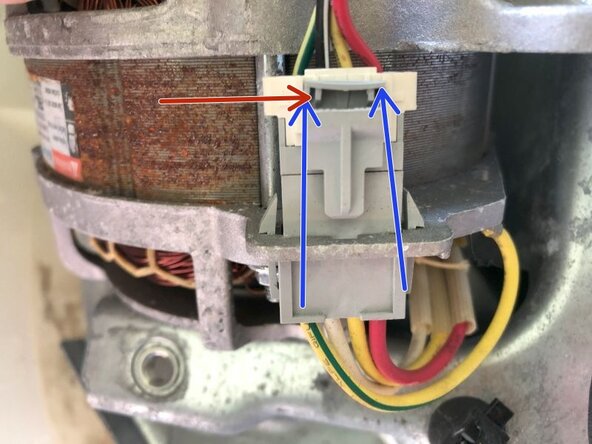

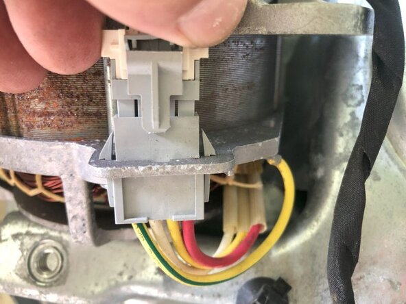

    • Next is to remove the wire connector. It does use a locking tab.
    • Move the locking tab up (you will now see the gap (Red arrow)
  6. Amana Washing Machine NTW4516FW Motor Replacement: crwdns2935265:06crwdnd2935265:01crwdnd2935265:03crwdne2935265:0 Amana Washing Machine NTW4516FW Motor Replacement: crwdns2935265:06crwdnd2935265:02crwdnd2935265:03crwdne2935265:0 Amana Washing Machine NTW4516FW Motor Replacement: crwdns2935265:06crwdnd2935265:03crwdnd2935265:03crwdne2935265:0

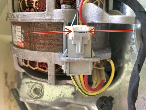

    • lift the locking tab with your fingernail (or a small screwdriver will work as well )
    • pull on the connector, (not the wire!)
    • until the connector comes free
  7. Amana Washing Machine NTW4516FW Motor Replacement: crwdns2935265:07crwdnd2935265:01crwdnd2935265:03crwdne2935265:0 Amana Washing Machine NTW4516FW Motor Replacement: crwdns2935265:07crwdnd2935265:02crwdnd2935265:03crwdne2935265:0 Amana Washing Machine NTW4516FW Motor Replacement: crwdns2935265:07crwdnd2935265:03crwdnd2935265:03crwdne2935265:0

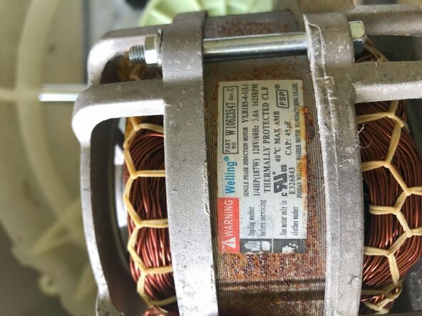

    • Motor can now be repalced.
    • Here is the tag for anybody that will need to know more about the motor.

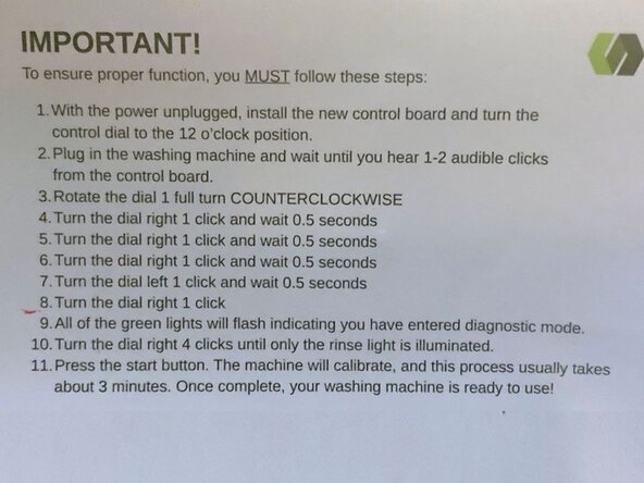

    • The Calibration Cycle must be run whenever a main component i.e. main control, motor, pump etc. has been replaced. To run the cycle, use the instructions received from the seller of a replacement part. Or you can use the Tech Sheet for this washer and follow the instructions on page 4
