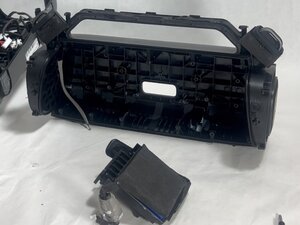

The Anker Boom Plus is a large, rectangular device in black with silver components. The front of the device will say "Soundcore," with two noticeably big speakers and two smaller speakers on the side. The back has the word "Soundcore" engraved in the device, and on the bottom, it has a silicone opening with the words "Motion Boom Plus" engraved. The plastic device measures 16.5 x 7.1 x 7.5 inches and weighs 5.7 lbs. It has a power button on the top and a Bluetooth button with a handle to carry the speaker.
