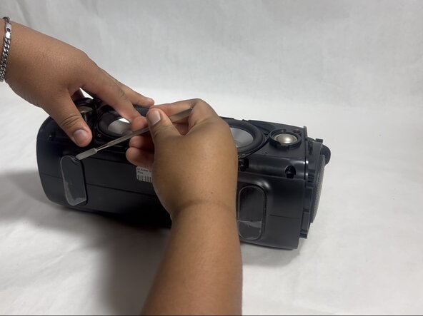

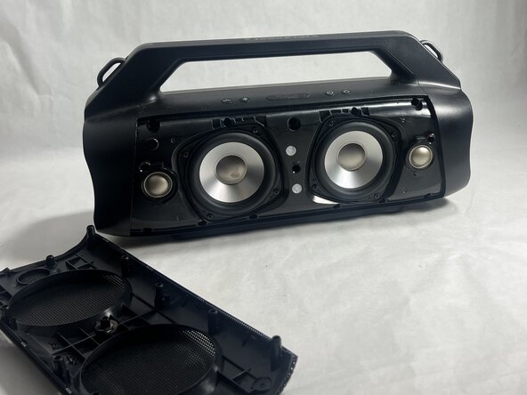

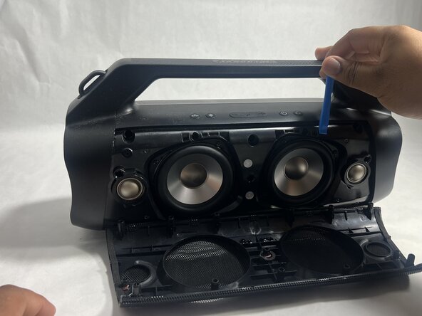

    • Insert an opening tool into the seam between the speaker grille and the chassis.
    • Pry the tool around the top, bottom, and sides until the grille fully releases.
    • Apply gentle pressure to avoid damaging the grille.
    • Remove the grille.

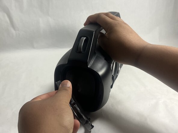

  2. Anker Soundcore Motion Boom Plus Tweeter Replacement: crwdns2935265:02crwdnd2935265:01crwdnd2935265:02crwdne2935265:0 Anker Soundcore Motion Boom Plus Tweeter Replacement: crwdns2935265:02crwdnd2935265:02crwdnd2935265:02crwdne2935265:0

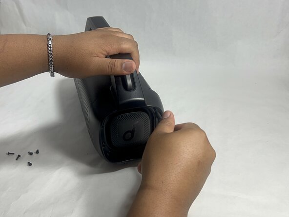

    • Remove the two passive radiators on either side of the device.
    • Avoid pulling too hard or with too much force to prevent breaking the passive radiators.
  3. Anker Soundcore Motion Boom Plus Tweeter Replacement: crwdns2935265:03crwdnd2935265:01crwdnd2935265:02crwdne2935265:0 Anker Soundcore Motion Boom Plus Tweeter Replacement: crwdns2935265:03crwdnd2935265:02crwdnd2935265:02crwdne2935265:0

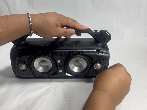

    • Remove the sixteen 14 mm Phillips screws, eight on each end of the speaker.

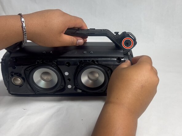

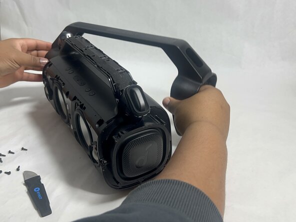

  4. Anker Soundcore Motion Boom Plus Tweeter Replacement: crwdns2935265:04crwdnd2935265:01crwdnd2935265:03crwdne2935265:0 Anker Soundcore Motion Boom Plus Tweeter Replacement: crwdns2935265:04crwdnd2935265:02crwdnd2935265:03crwdne2935265:0 Anker Soundcore Motion Boom Plus Tweeter Replacement: crwdns2935265:04crwdnd2935265:03crwdnd2935265:03crwdne2935265:0
    • Gently remove the handle from the device by clicking off the handles from the sides and then pulling it off.

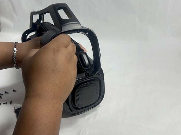

  5. Anker Soundcore Motion Boom Plus Tweeter Replacement: crwdns2935265:05crwdnd2935265:01crwdnd2935265:02crwdne2935265:0 Anker Soundcore Motion Boom Plus Tweeter Replacement: crwdns2935265:05crwdnd2935265:02crwdnd2935265:02crwdne2935265:0
    • Flip the speaker onto its side and use a spudger to remove the two rubber feet on the bottom of the device.

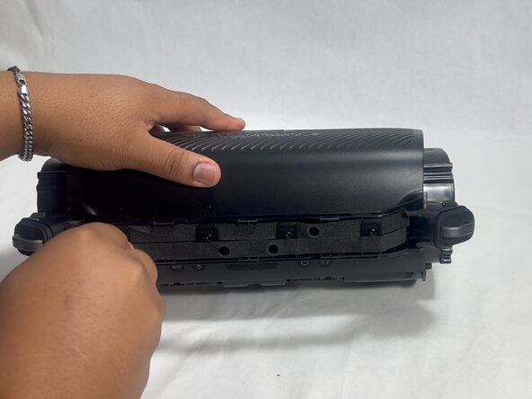

  9. Anker Soundcore Motion Boom Plus Tweeter Replacement: crwdns2935265:09crwdnd2935265:01crwdnd2935265:01crwdne2935265:0
    • Insert a spudger into the seam on top of the device.
    • Gently pry the casing open.

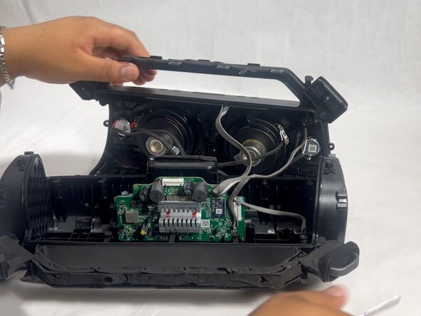

  10. Anker Soundcore Motion Boom Plus Tweeter Replacement: crwdns2935265:010crwdnd2935265:01crwdnd2935265:03crwdne2935265:0 Anker Soundcore Motion Boom Plus Tweeter Replacement: crwdns2935265:010crwdnd2935265:02crwdnd2935265:03crwdne2935265:0 Anker Soundcore Motion Boom Plus Tweeter Replacement: crwdns2935265:010crwdnd2935265:03crwdnd2935265:03crwdne2935265:0
    • Disconnect each of the three cables by gently pulling the connectors out of their sockets.
    • Do not pull with force. The ribbon cables are fragile and easily break.

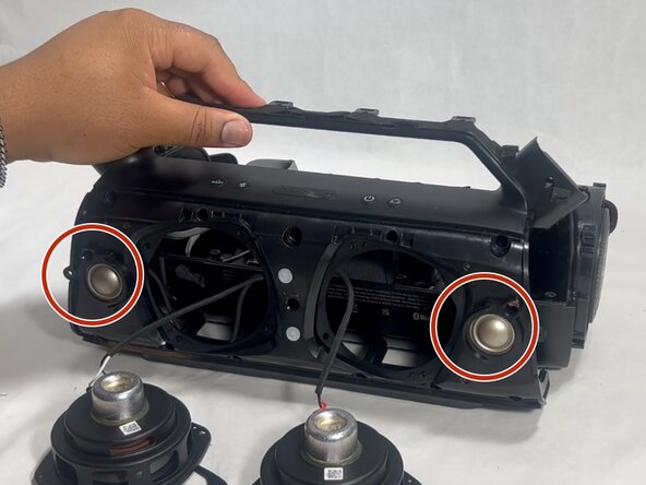

  11. Anker Soundcore Motion Boom Plus Tweeter Replacement, Tweeter: crwdns2935265:011crwdnd2935265:01crwdnd2935265:02crwdne2935265:0 Anker Soundcore Motion Boom Plus Tweeter Replacement, Tweeter: crwdns2935265:011crwdnd2935265:02crwdnd2935265:02crwdne2935265:0
    • Disconnect the ribbon cables attached to the tweeters by pulling them off gently.
    • Avoid pulling too hard on the ribbon cables as they are fragile and easily break.
  12. Anker Soundcore Motion Boom Plus Tweeter Replacement: crwdns2935265:012crwdnd2935265:01crwdnd2935265:01crwdne2935265:0
    • Push the tweeters from the front side, and the tweeters should pop out. Remove and replace the tweeters with new ones.
