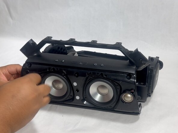

    • Insert an opening tool into the seam between the speaker grille and the chassis.
    • Pry the tool around the top, bottom, and sides until the grille fully releases.
    • Apply gentle pressure to avoid damaging the grille.
    • Remove the grille.

    • Remove the sixteen 14 mm Phillips screws, eight on each end of the speaker.
  4. Anker Soundcore Motion Boom Plus Subwoofer Replacement: crwdns2935265:04crwdnd2935265:01crwdnd2935265:03crwdne2935265:0 Anker Soundcore Motion Boom Plus Subwoofer Replacement: crwdns2935265:04crwdnd2935265:02crwdnd2935265:03crwdne2935265:0 Anker Soundcore Motion Boom Plus Subwoofer Replacement: crwdns2935265:04crwdnd2935265:03crwdnd2935265:03crwdne2935265:0
    • Gently remove the handle from the device by clicking off the handles from the sides and then pulling it off.

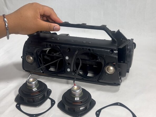

    • Remove the four 11 mm Phillips screws securing the right subwoofer.
    • Gently pull the subwoofer out of the device.
  12. Anker Soundcore Motion Boom Plus Subwoofer Replacement: crwdns2935265:012crwdnd2935265:01crwdnd2935265:01crwdne2935265:0
    • Detach the cables connected to the subwoofer.
    • Do not pull with force, as the cables are fragile and easily break.
    • Remove the right subwoofer.
    • Repeat the previous two steps for the left subwoofer.
