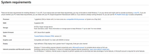

This image may help. I’m not sure I’ve heard needing an 8th CPU.
Microsoft specifically says 8th gen-present is officially supported. It also lacks a TPM, so I need to see how dead I am here beyond Win10 unless that requirement is satisfied somehow elsehow.
