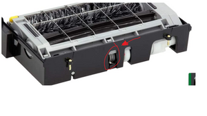

Late to the game but if it helps anyone else in the future, I just dealt with this even after I made sure the brushes were clean. I have long hair and a dog so I knew there had to be little some pocket of hair in there that I couldn’t find.
What fixed it:
I took the whole thing apart to give a good cleaning but two things made a WORLD of difference
1. While disassembled, I popped the front wheel assembly off and then took the front wheel out of the assembly. The metal posts that hold that ball in the assembly where completely twisted with hair (like a spool of thread). I was able to slip the hair right off and then pop the wheel back in the assembly
2. This one was HUGE: On my particular model, when you remove the brushes to clean them, there’s the square end and then there’s the other end with the two plastic prongs (mine is green and yellow). On a whim, I pulled off the yellow prong part (the side opposite of the square end) and BAM: dense spool of hair. I have no idea how it got into that tiny little space but removing it from both brush assemblies completely fixed it for me. Good luck!

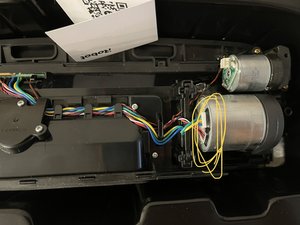

I had to pull of the brush cage and re solder a wire that was loose on little engine (that's beneath the brush cage when the roomba is up side down) that seams to lift/lower the brushes (I'm not sure about that)..
Now it works like a charm

there is a little tether on the motor under the assembly, it looks like a tiny metal wire with a brass head, Once i removed that the brushes started working fine.

So this is what I found in my Roomba 805.
One thing was not mentioned, and that's why I am putting this here, it was the "gear mechanism" in the brushes dock.
So I took it apart, like one of the fellows mentioned, and put a video here about it, but mine was not full of gunk like he showed in the video. Probably because it's a different model and that compartment is properly sealed on my 805, but I found that one of the plastic gear, was rubbing against the plastic cover of the motor/gear assembly, and because of so much friction, it kind of "melted" the area and became stuck. Reason for the computer board to read that the motor is drawing more amps therefore popping the error code 2, "clean brushes" "clean brushes""clean brushes""clean brushes".
By scraping off the excess plastic build up, and adding extra grease, I made it work, and the error code didn't pop anymore. But this is a manufacturer issue, and I am pretty sure sooner or later the grease will wear off and the issue will hunt me again.
So basically, buying a new brush dock will fix that for as long as it will work (God knows).
