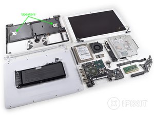

Hello, I just got one of these, and when I turn it on, there is no boot chime. I haven't had the chance to install an os, but I popped in a snow leopard drive from another macbook to test it out. Once it's booted, the audio is very quiet and tinny. Output through the headphone jack sounds fine. I have already tried doing an SMC and PRAM reset, and nothing changed. It currently doesn't have a battery, in case that might change anything. Thanks!
The early MacBooks never had that great a speaker system. Your system has two speakers just under the keyboard and a third in the back. Try using the balance control to bias the left and then the right to see if you can tell which speaker is having a hard time If you don't notice a difference you'll need to try a bass & treble recording to see if the rear is blown.
Often liquid spillage into the keyboard would damage the speakers. Sadly you would need to replace the upper case if either the left or right are blown Top Case with Keyboard Apple P/N: 661-5396 Follow this IFIXIT guide: MacBook Unibody Model A1342 Logic Board Replacement which will get you mostly there.
Here is the IFIXIT guide to replace the rear speaker which is a lot easier: MacBook Unibody Model A1342 Rear Speaker Replacement
While it is able to run the latest version of MacOS Sierra, Apple has made it clear this will be the last OS for it. So do consider the costs to fix the speakers as well as anything else it might need before going to deep here.

Here's the best image of the speakers:

Where are the left and right speakers located? Are they attached to the unibody case? I would think that these speakers could be blown, but the fact that there is no hint at a boot chime throws me off, since these speakers can make some sound. Both speakers sounded equally bad when testing them individually. Also, out of curiosity, where is it stated that it won't be able to run a newer os?
I have the same Problem... I've changed the middle/rear speaker but that didn't fix it. There is no signal on the connection on the Logicboard. Does anybody know this problem?
Then the Amp is bad within the logic board
