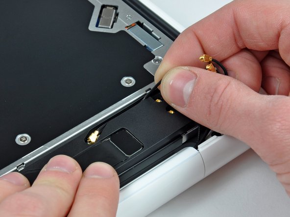

    • Pry the AirPort and Bluetooth antenna connectors (3 total) up off the AirPort/Bluetooth card.
    • De-route the long antenna from its channel in the rear speaker housing.

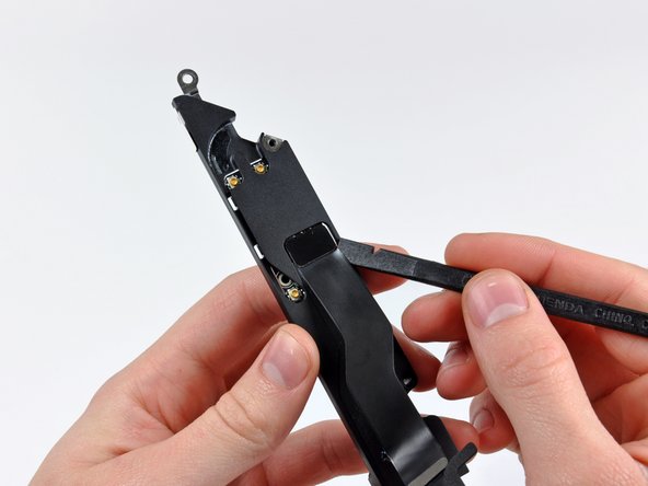

    • Carefully peel the AirPort/Bluetooth cable from its channel within the rear speaker assembly.
    • Use the flat end of a spudger to pry the AirPort/Bluetooth cable up off the rear speaker.
