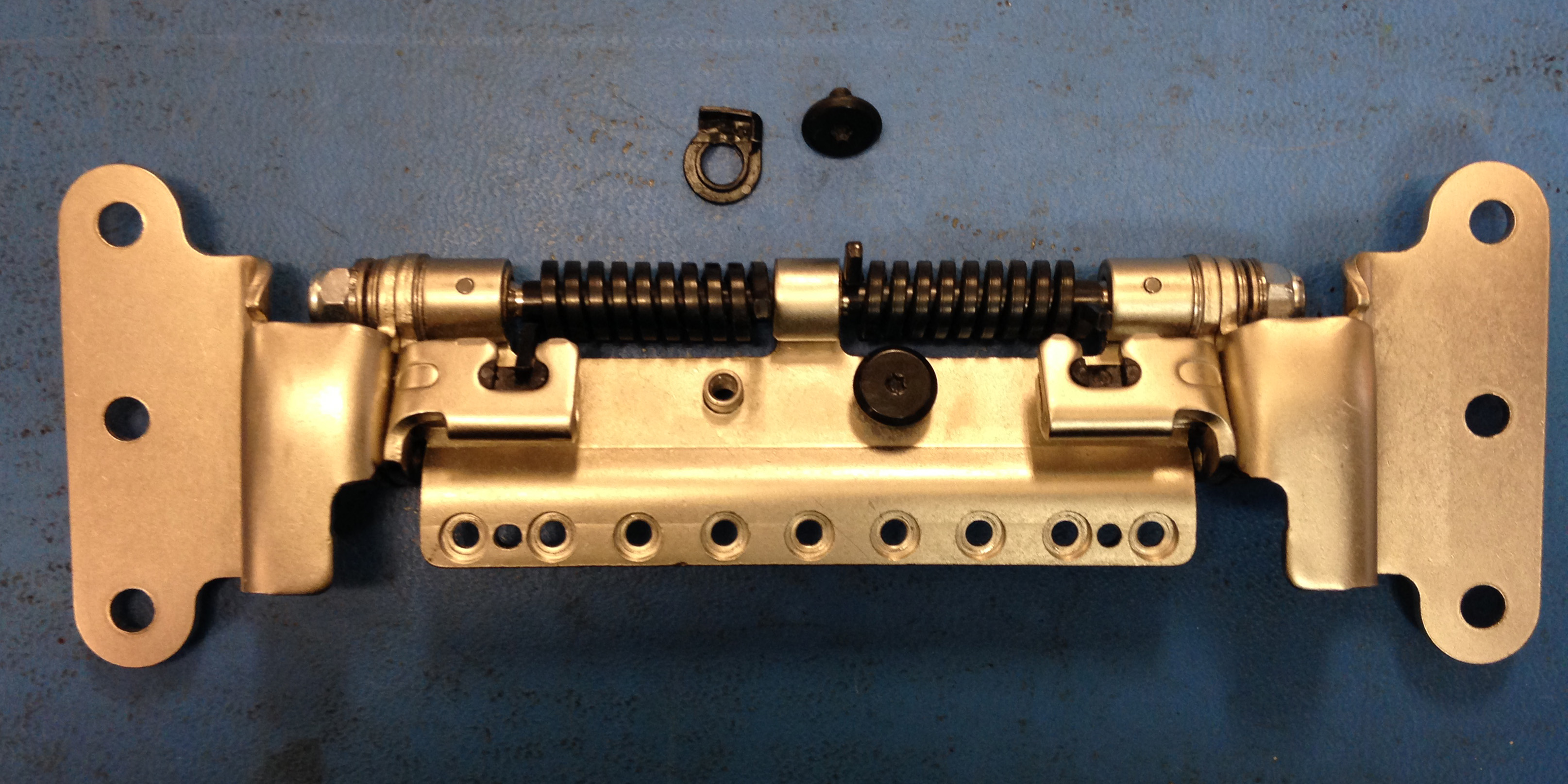

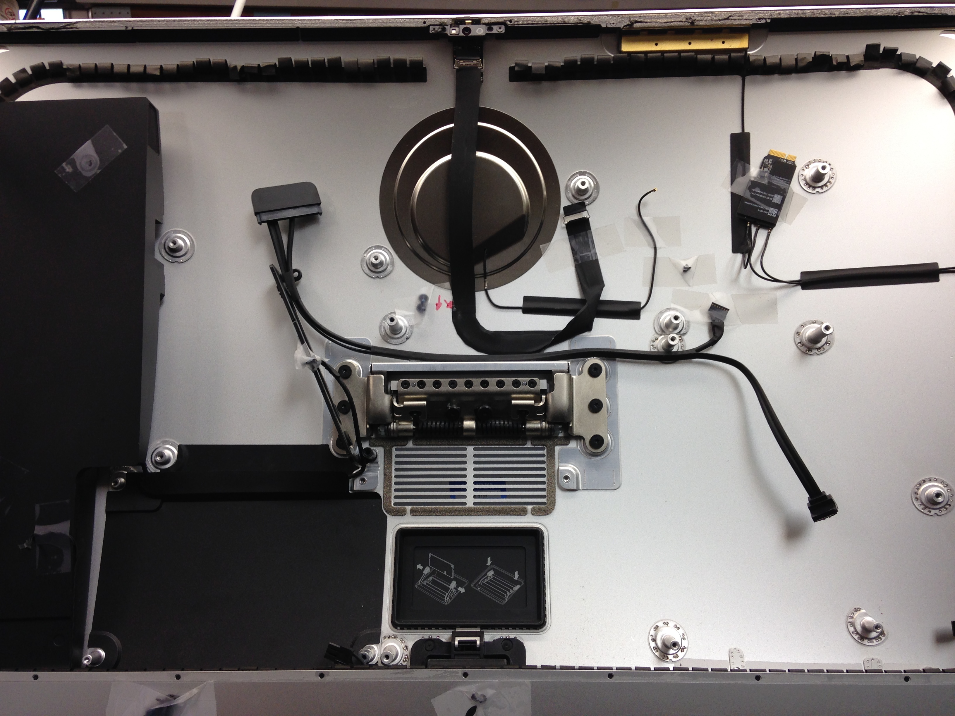

Regarding the 2013 27" iMac, and it leaning forward as if it's been in captivity too long...
I have swapped the hinge mechanism on several 27" iMacs, all 2013.
Not to be confused with earlier models where you can insert a credit card in the backto release the mechanism or any modified Vesa mount, the above models were just factory standard.
The issue is a really poor design, where 2 high tension metal springs are held in place by 2 plastic couplers. The cheap plastic couplers (if that's the correct term), eventually break, and the screen leans forward. Many users report hearing a loud crack when it breaks.
You can't adjust anything here. You can't tighten ANYTHING to fix it.
The temporary fix is to wedge some foam between the back of the display and the screen. I’ve also seen users inadvertently cover the rear vent when propping the up a screen, which cooks the machine…
You have to purchase a new hinge assembly (see photo), it has the same cheap plastic couplers while the whole assembly is metal. I was unable to find just the couplers on their own, but a little imagination or a few episodes of MacGyver might help with some small washer ideas...
See the attached 2 images below
• You can see that pretty much everything has to come out of the iMac to get to the hinge.
• The second photo shows the metal hinge, with the screw that holds the "coupler" in place. The high tension metal springs (1 each side) are held in place by the flimsy plastic couplers!
A new hinge assembly is approximately $80 -$100Don't forget the adhesive strips for the screen
Hope that helps (and makes sense).

If you want to replace the hinge mechanism, there is also a simple way of repairing the old one. Just disassemble the complete hinge. Now replace the plastic couplers by metal washers. It is very hard to press thru the high tension of the metal springs. To avoid this remove the two bolds and attachment braces at both sides of the hinge. It is much easier to attach the new washers with the screws now. After attaching these assemble the braces again. Altogether no problem here, everything is working perfect again.
I fix this problem all the time. It’s the spring tensioner its made out of plastic. I fix it by using a metal washer in place of the plastic piece.
