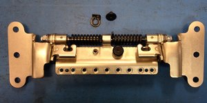

You have to purchase a new hinge assembly (see photo), it has the same cheap plastic couplers while the whole assembly is metal. I was unable to find just the couplers on their own, but a little imagination or a few episodes of MacGyver might help with some small washer ideas...

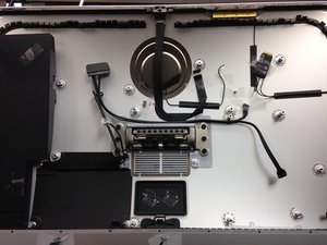

See the attached 2 images below
• You can see that pretty much everything has to come out of the iMac to get to the hinge.
• The second photo shows the metal hinge, with the screw that holds the "coupler" in place. The high tension metal springs (1 each side) are held in place by the flimsy plastic couplers!
A new hinge assembly is approximately $80 -$100Don't forget the adhesive strips for the screen

If you want to replace the hinge mechanism, there is also a simple way of repairing the old one. Just disassemble the complete hinge. Now replace the plastic couplers by metal washers. It is very hard to press thru the high tension of the metal springs. To avoid this remove the two bolds and attachment braces at both sides of the hinge. It is much easier to attach the new washers with the screws now. After attaching these assemble the braces again. Altogether no problem here, everything is working perfect again.
I fix this problem all the time. It’s the spring tensioner its made out of plastic. I fix it by using a metal washer in place of the plastic piece.
