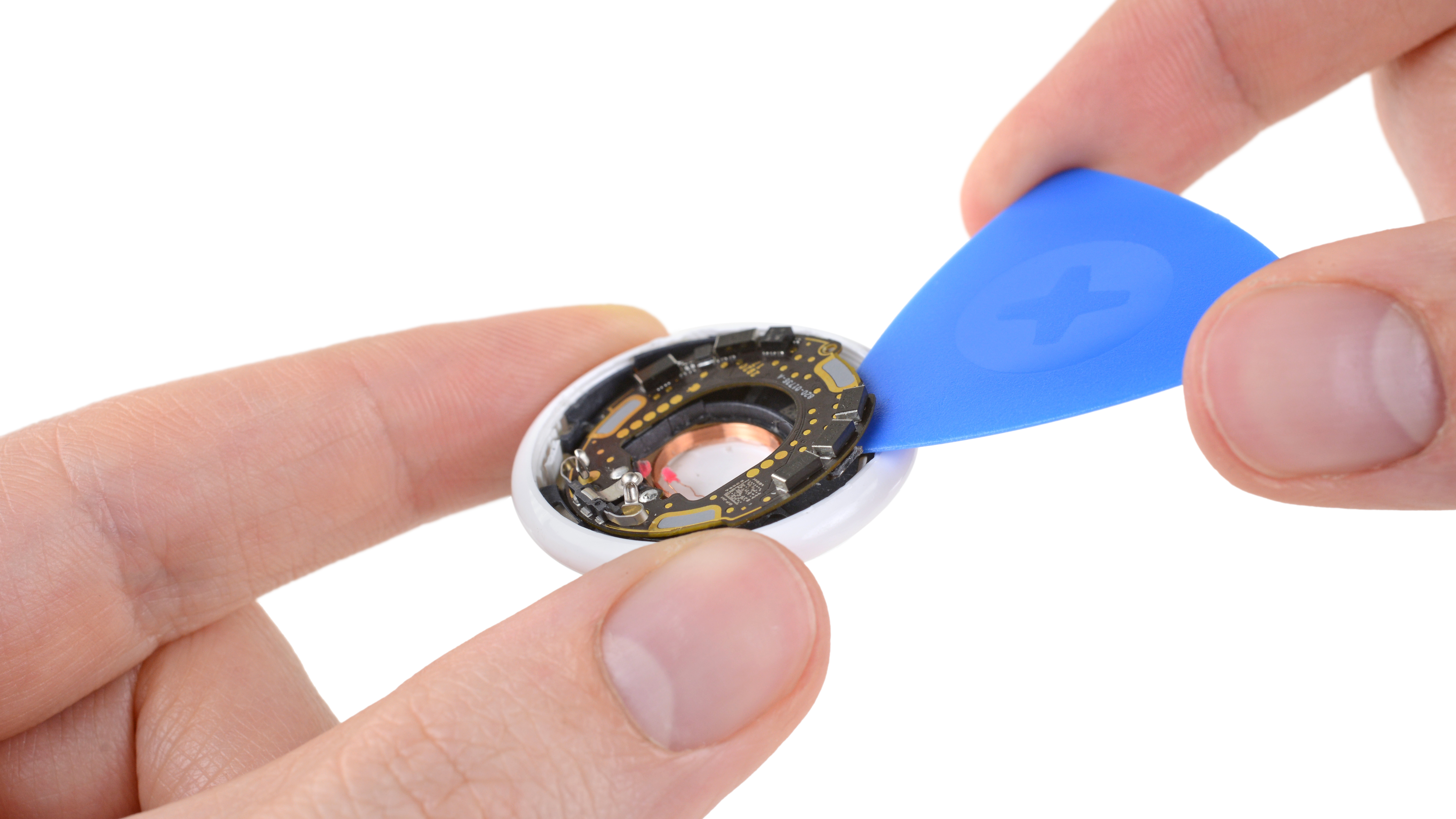

Opening salvo
All three trackers open up with finger power—no other tools required! That said, the AirTag is by far the most difficult, especially if you indulged in a snack earlier and have greasy digits. Imagine opening a stubborn pickle jar with just two slippery thumbs, and you’ve got the idea. The other trackers have dedicated divots for separating the pieces with a fingernail—moisturize to your heart’s content!

Battery replacement marks the end of the user-serviceable portion of all these devices—from here, we’ll need more than our fingers.
The Tile and SmartTag come apart readily with a spudger and a splash of heat, while the AirTag requires more persuasion. That said, Apple showed surprising restraint in sealing the AirTag. It’s no tool-free wonderland, but three clips and some glue isn’t too bad. It helps to squeeze the AirTag gently with a vise to open up the seams a bit—from there, a poke from a plastic pick convinces it to come apart. If you plan to venture this far into an AirTag, tread carefully! The gluey clips are prone to break rather than release.

It’s circles all the way down as you head inside the AirTag. Did you notice the “button” on the underside of the cover? That’s not a clickable button, like the Mate and SmartTag have, but rather the magnet we saw earlier in the X-ray. It sits right inside the donut-shaped logic board, nested into a coil of copper to form a speaker. You read that right—the AirTag’s body is essentially a speaker driver. Power is sent to the voice coil, which drives the magnet mounted to the diaphragm—in this case, the plastic cover where the battery lives—which makes the sounds that lead you to your lost luggage.
But why bother putting a real driver in here at all? Magnets not only add weight, they take up a lot of space. The dinky piezoelectric speakers in the Mate and SmartTag made just as much, if not more, noise in our testing, so pure volume isn’t the answer. Looks like one corner Apple refused to cut on this tiny disk is sound quality. Piezo speakers are tiny and cheap, and sound like it—we’re talking McDonald’s happy meal speakers here. Knowing Apple, and knowing how seriously they take their noisemakers, sound quality can never be compromised, not even here.
