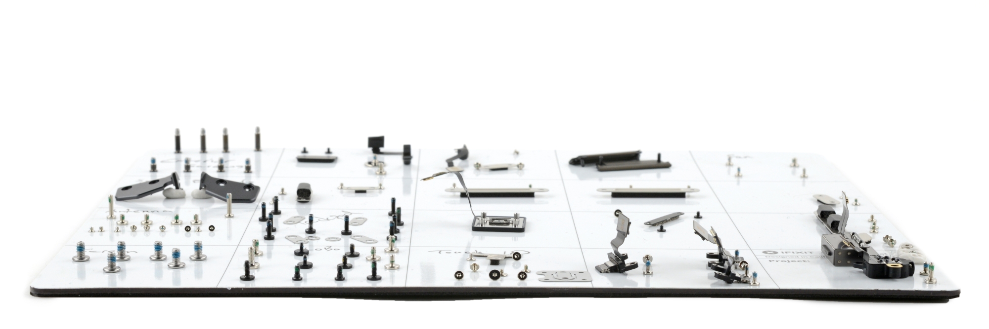

Changing an M5 MacBook Pro battery the Apple way
This is everything Apple wants you to remove to change a M5 MacBook Pro battery. Tedious and expensive!

Apple’s official replacement process requires swapping the entire top case, keyboard and all, just to replace this single consumable component. And it has for a long time. That’s a massive and unreasonable job, requiring complete disassembly and reassembly of the entire device. We’re talking screws, shields, logic board, display, Touch ID, trackpad, everything. In fact, the only thing that doesn’t get transferred are the keyboard and speakers. The keyboard is more or less permanently affixed to this top aluminum, and the speakers are glued in—which, I guess, according to Apple means that the repair is out of the scope of DIY (we disagree).
Though parts haven’t yet been released for this refresh, the Self Service Repair store still only sells full “top case with battery and keyboard” assemblies (for a whopping $527) for the M4 MacBook Pro. An “important information” tooltip says, “The Top Case replacement part includes a battery. In the future, a battery replacement part will be available.” But for now, this tedious and insanely expensive process is the only offering they make for changing out a dead battery. Is it just a byproduct of this nearly half-a-decade-old chassis design, something that won’t change until the next rethink? We don’t know.

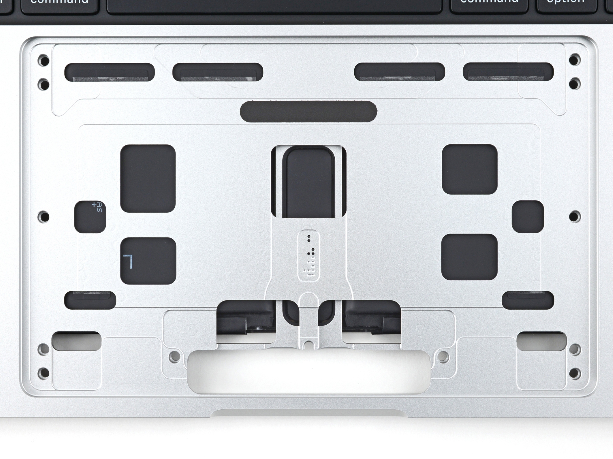

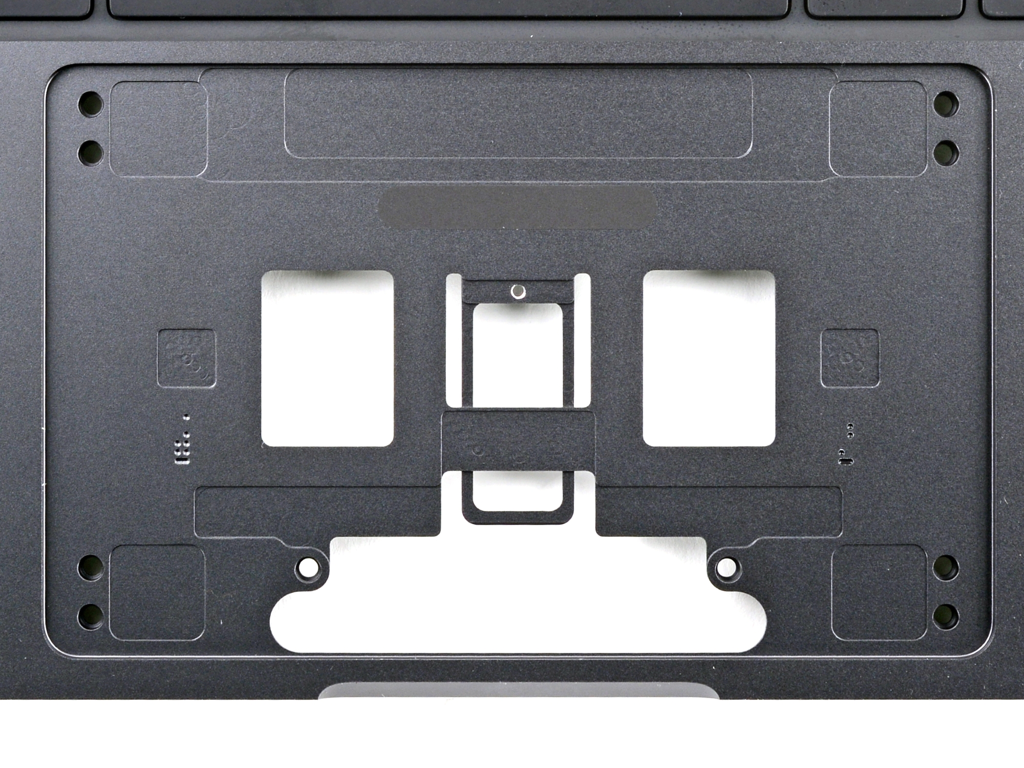

The good news? For the first time in a MacBook Pro, you don’t have to remove the trackpad to access the pull tabs that release the central battery cells. It’s a sign of some of the same sort of improvements we were excited to see in the iPhone 17 Air design, prioritizing access to components that will need to be replaced first. Those pull tabs under the battery are still finicky (and get worse with age), but at least now they’re quickly within reach. Trackpad removals were never that difficult in MacBooks, but we’ll take the streamlining.
Compare the M4 MacBook Pro’s trackpad cutouts against the M5’s yourself below:
