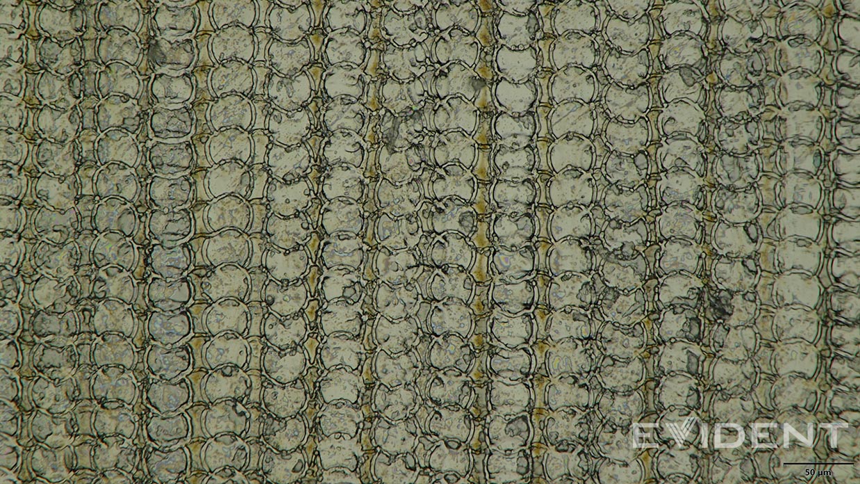

Once we’d taken apart the iPhone Air, we had to put the USB-C port under our Evident DSX2000 microscope. Magnified images of the USB-C port revealed a perplexing detail: a chainlink-like, circular surface pattern that stumped 3D printing veterans. At the 50µm scale, this pattern seemed highly unusual.
A close up of the surface of the USB-C port. Note the scale on the bottom right.

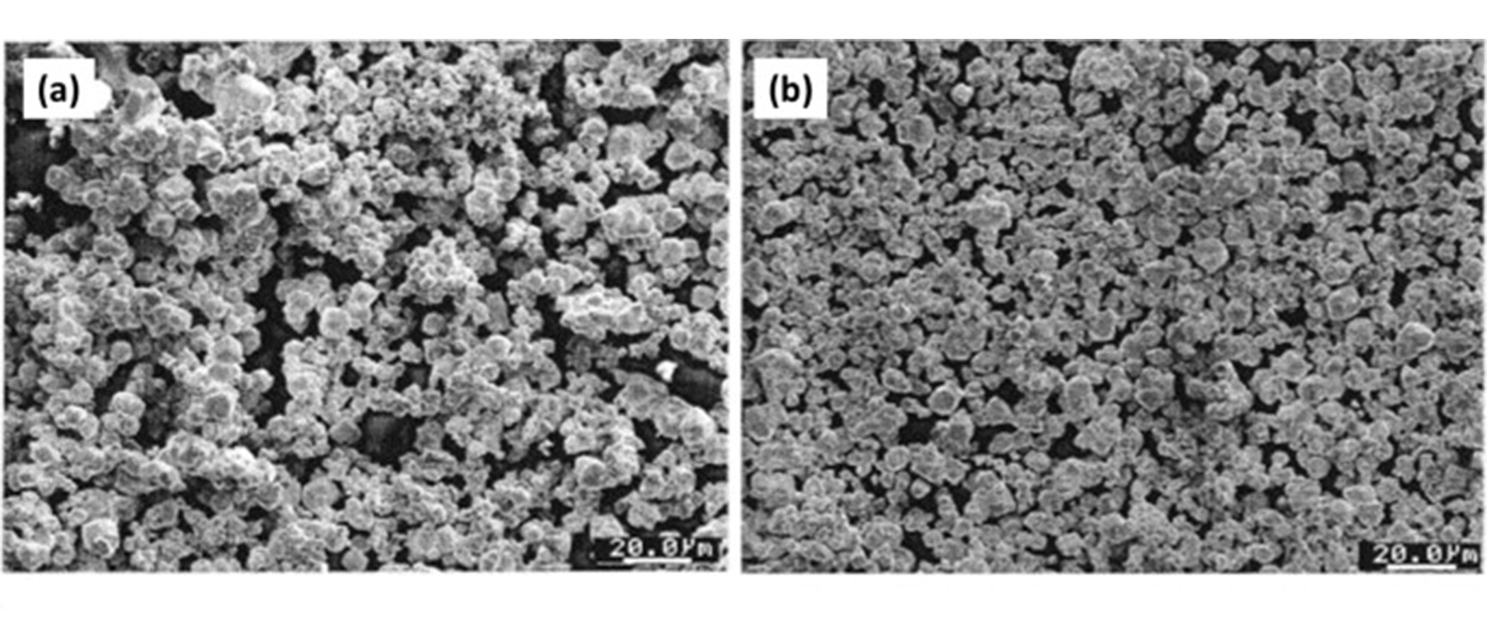

Early reports had suggested that Apple might be using binder jetting, a 3D printing process that involves joining a powder with a binder material, which acts as an adhesive. Two years ago, when it was first reported that Apple was experimenting with using 3D printing for Apple Watch cases, a Chinese company called EasyMFG showed off smartwatch cases printed via binder jetting.
But under a microscope, binder jetting tends to look far less regular than the crop circle pattern we were seeing in the USB-C port housing. So our industry contacts doubted that was the process we were seeing here.
At the 20 µm scale, binder jetting doesn’t appear to be a match for what we’re seeing on the iPhone Air (source)

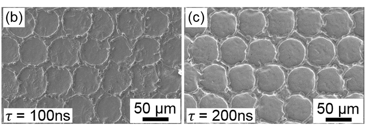

We found a potential clue to its origins in an unlikely place: a six-year-old Nature article from the medical field. It highlights the benefits of creating 10-50µm structures on titanium surfaces using pulsed laser ablation to introduce anti-bacterial properties in prosthetics.
Binder jetting builds parts layer by layer by selectively depositing a liquid binder onto powdered material, which is later sintered or infiltrated to achieve full strength. On the other hand, pulsed laser ablation uses intense, short laser pulses to vaporize material from a solid target, ejecting atoms or clusters that can redeposit as thin films or coatings. In short, binder jetting bonds powder with a liquid adhesive to create 3D structures, while pulsed laser ablation removes or deposits material using concentrated laser energy.
Scanning Electron Microscope images of pulsed laser ablation, resulting in very similar structures to what we saw when we looked closely at the iPhone Air USB-C port (source)

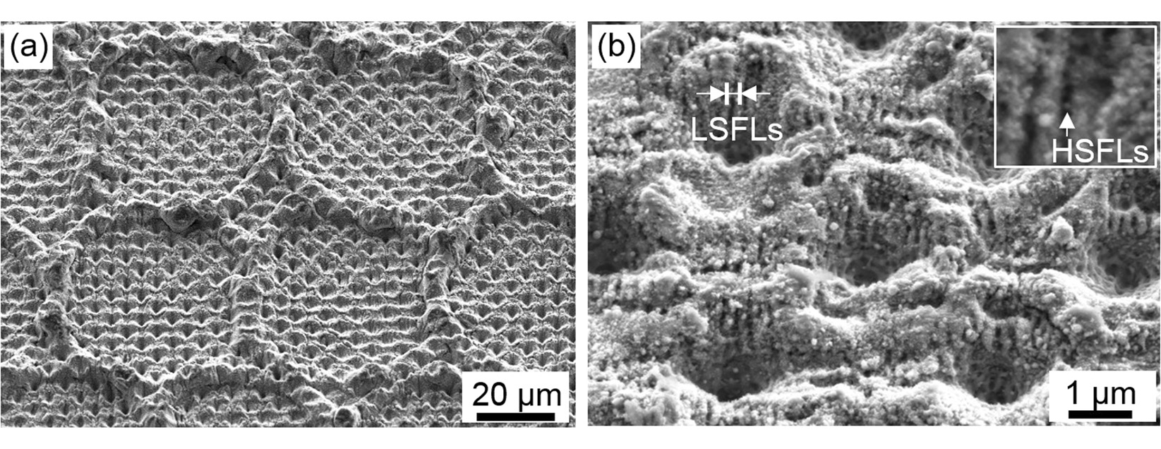

I need to make a crucial clarification here: Despite the fascinating parallel, the USB-C port does not have antibacterial properties. The roughly 30µm circular structures we see are not small enough; they would require additional indentations at the 5-10µm scale to repel bacteria, as shown in related research.
Images showing 5µm indentations within a 30µm diameter crater. The ability to create an artificial structure that dissuades bacteria like E. Coli from promulgating on a surface is mind-blowingly cool (source)
However, the similar pattern and size, while not definitive proof, suggest that a pulsed laser methodology may have been used. Furthermore, images show outlines of a subsurface layer with the same patterns, suggesting the technique was used throughout the printing process, not just on the outer layer.

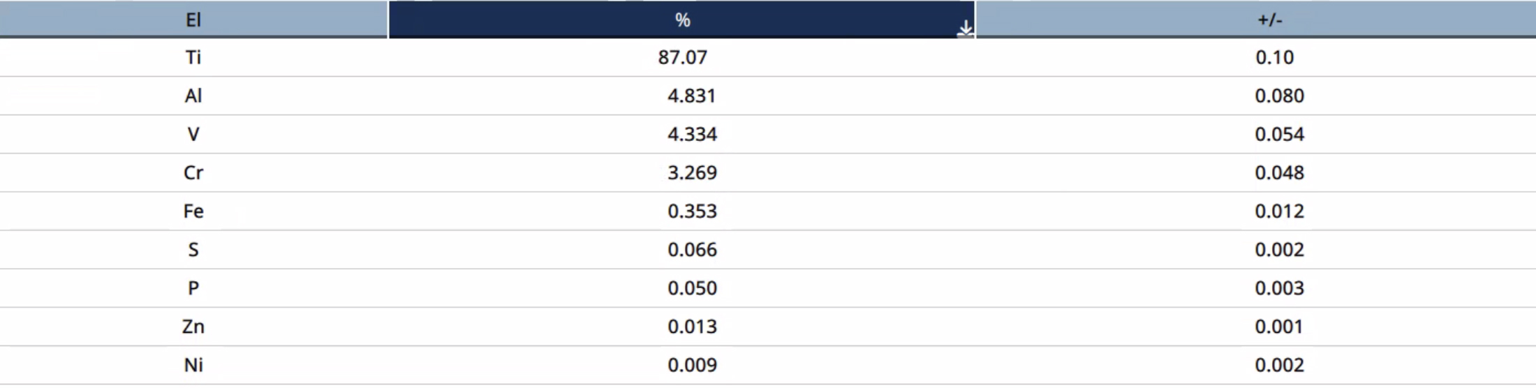

It’s perhaps even a little misleading, as X-ray fluorescence (XRF) analysis shows that the alloy being used is based on T6Al4V (one of several “aerospace grade” titanium alloys) but not one that would typically be used for aerospace applications due to the use of ferrochrome. The use of chromium introduces brittleness at high temperatures while the iron content reduces the corrosion resistance of the alloy, neither of which are desirable in aerospace applications.
XRF results from the USB-C port, courtesy of Evident Scientific
What’s more interesting still is that the ferrochrome content is apparently a byproduct of the titanium recycling process. According to one of our industry experts, it specifically suggests that Apple is recycling the titanium waste produced by its own manufacturing process, adding ferrochrome to create this funky custom alloy to make it suitable for 3D printing, and then upcycling the now-modified titanium for use in other products.
