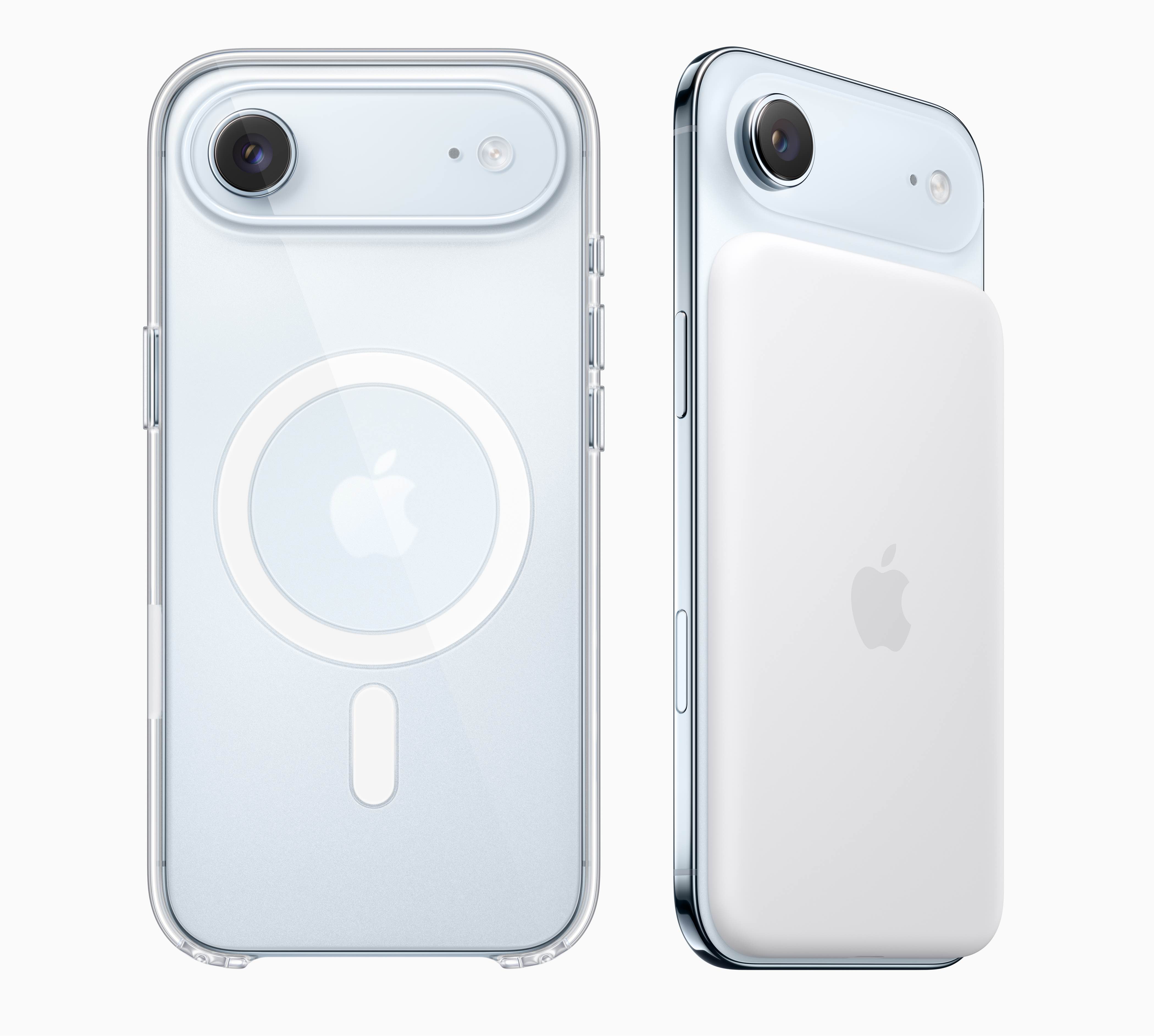

Apple knows this, which is why it has introduced a new MagSafe battery pack, which takes the claimed max video playback from 27 hours to 40. Of course, this means that you have a battery stuck to the back of your phone, and despite the promise in the keynote that you can still slip the package into a pocket, what’s the point? After all, the entire reason for buying the iPhone Air is that it’s slim and light. If you’re going to use the battery all the time then why not get the 17 Pro, which has better cameras too?
Plus, that MagSafe battery is itself inefficient. Any charger that transfers power through magnetic induction wastes around 25% of electricity as heat. On its blog, Anker, maker of batteries, cables, and other charging products, says that “The efficiency rate of inductive chargers usually falls between 70% and 80%.” This figure can climb nearer 90% with optimized practices, which includes lining things up with magnets like MagSafe.
