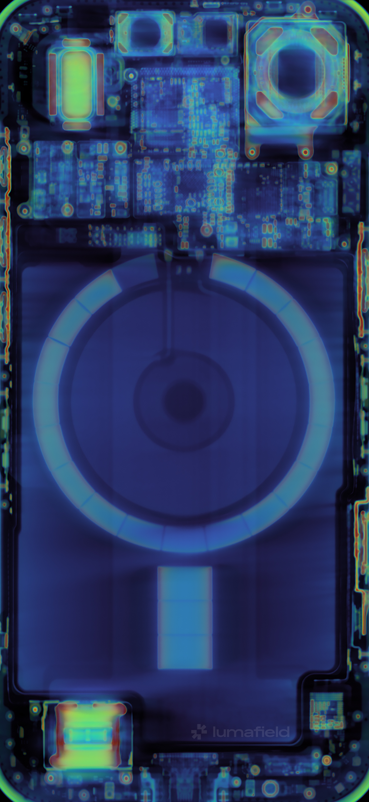

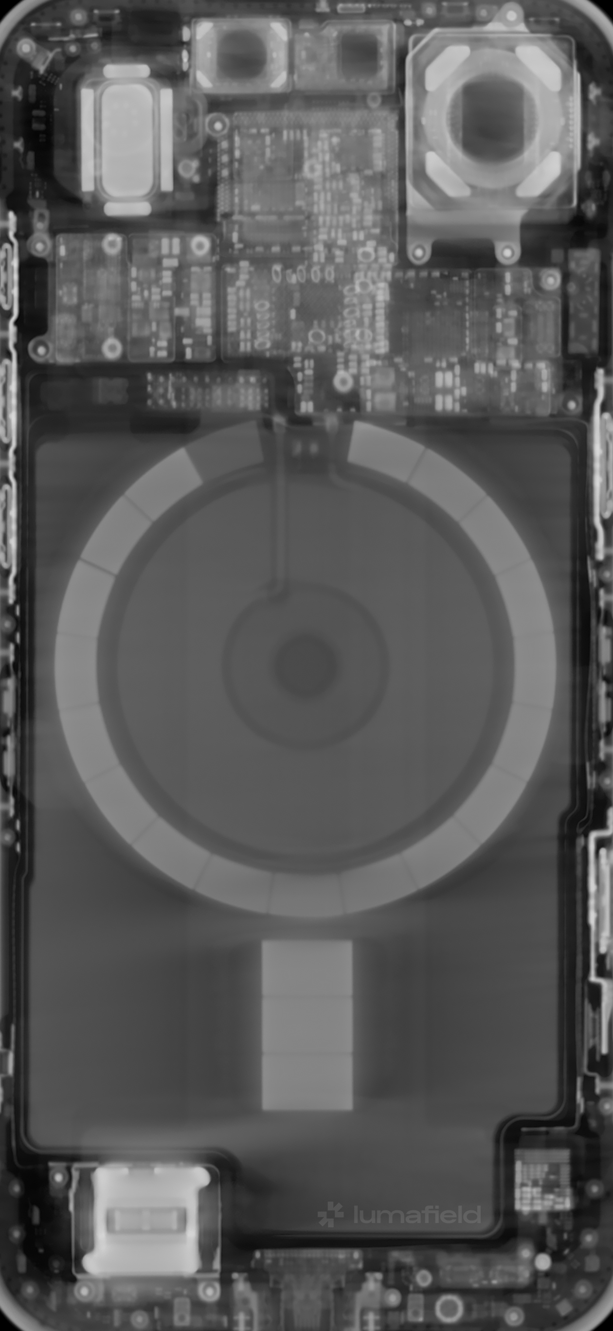

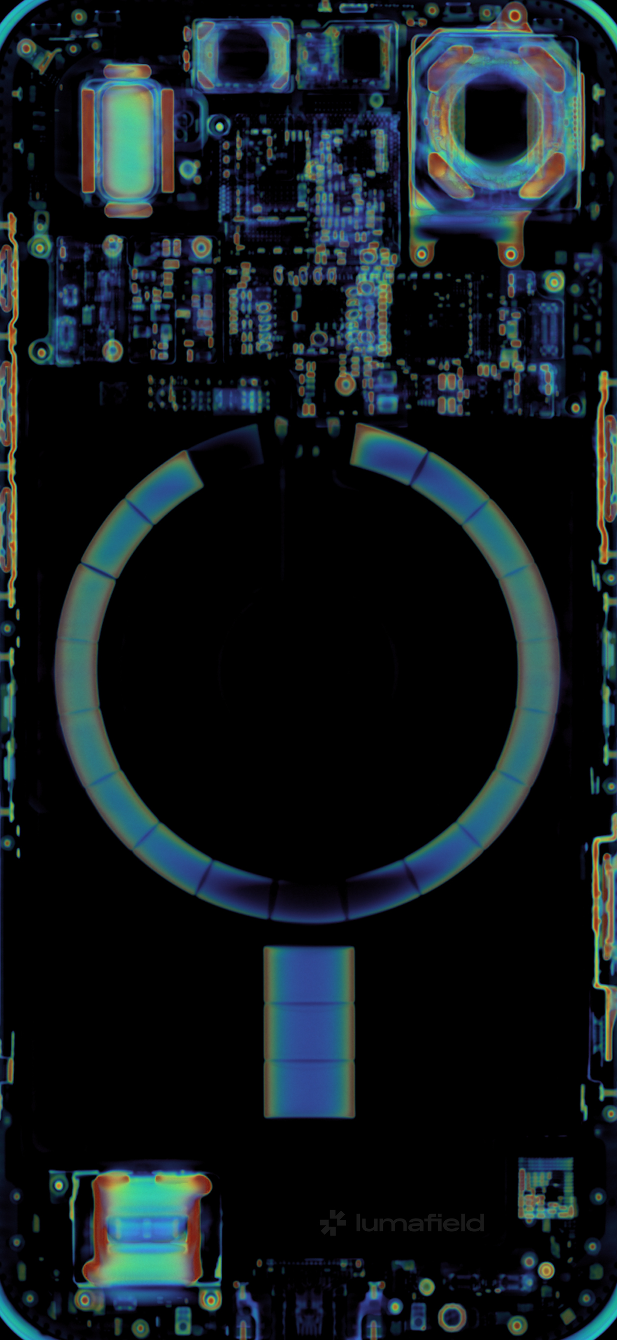

Apple made one huge design shift in the Air, which they teased in their keynote and we confirmed with our Lumafield Neptune CT scanner: The middle of this phone is basically just a battery with a frame around it. Apple popped the logic board up above the battery, a large part of how their design got thinner without compromising repair.
When we score repairability, 80% of our score is determined by the ease of replacing the parts that are most important and most likely to break. To figure this out, we build a model of the repair process. What’s the path you have to take to get to the battery, or to the screen? We call this the “disassembly tree.” The ideal (if unlikely) disassembly tree is flat. No parts in the way of other parts.
A thin device often means, advantageously, a flat disassembly tree. Stacked parts are thicker than parts side-by-side. Our friends over at Framework have been saying this for a long time: It’s totally possible to make a thin and light device that’s also built for repair. The Framework Laptop has done this from the start, with nearly all major components accessible when you remove the cover.
And that’s exactly what we’re seeing in the Air. The logic board shift freed up room for the battery and helped the phone stay thin without cramming parts on top of each other. It also conveniently puts less stress on the board if the phone flexes in your pocket. It’s a smart workaround for the “bendgate” problems that haunted earlier slim iPhone designs. Not that the Air’s really going to be bending much, as Zack’s test at Jerry Rig Everything suggests.

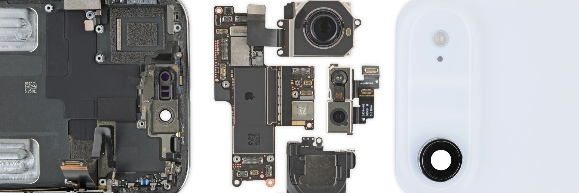

The Air trims a few extras compared to the Plus line it succeeds, losing the lower speaker and a rear camera. Like the 16e, it’s got just a single rear camera.
Inside, though, it packs the upgraded C1X modem, a new N1 WiFi chip, and the A19 Pro system-on-chip, all tucked into the logic board sandwich. It’s a lean, efficient setup that makes the most of limited space. This reduced complexity also contributes to quicker disassembly—fewer features, fewer parts, and fewer points of failure.

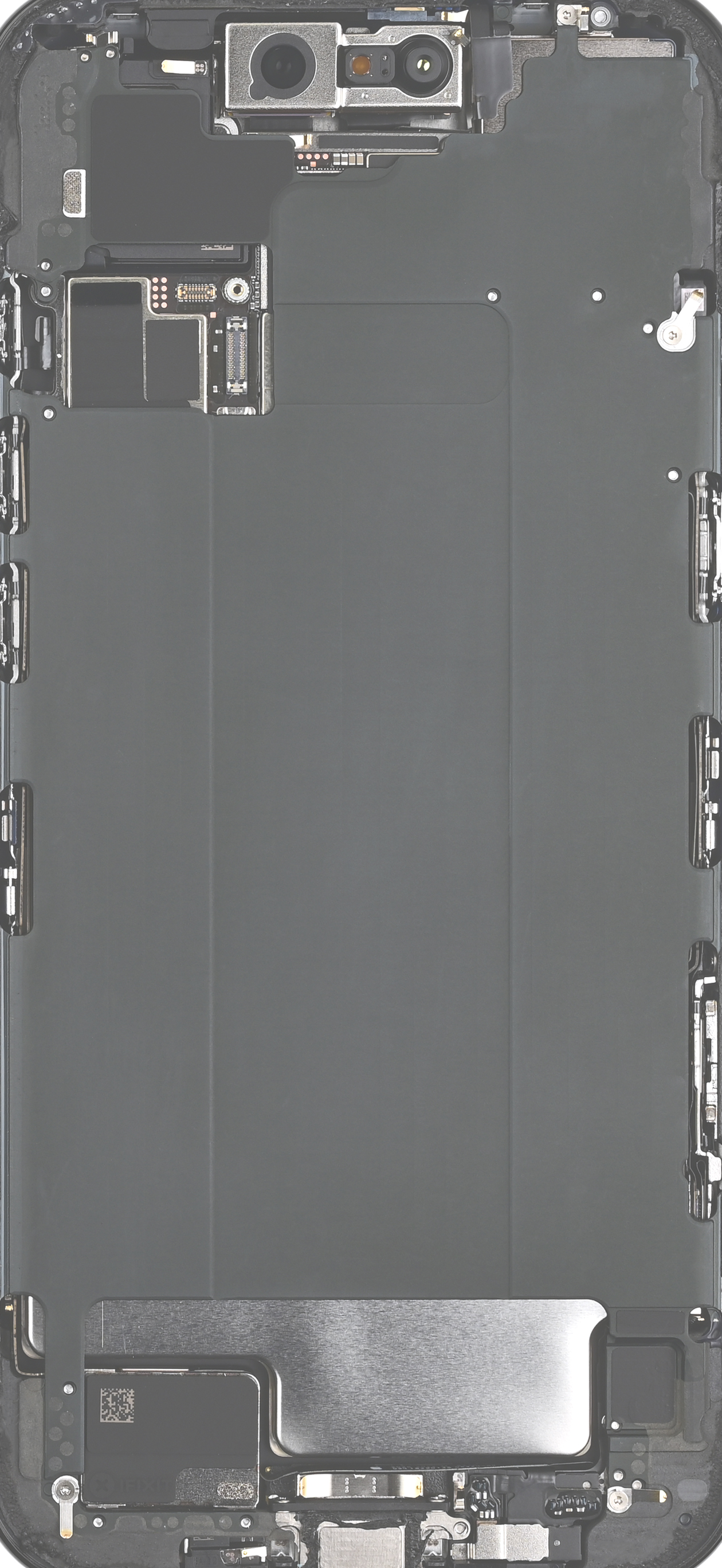

But no battery lasts forever, so how difficult will swaps be? We’re relieved to see that the Air has all the greatest hits of the last few iPhone battery designs.
The Air’s battery is easy to find and accessible through the back glass thanks to Apple’s dual entry design. Even better, it’s a metal-encased battery. This thin layer of armor makes it more bend resistant and safer to replace. Even better than that, it’s mounted with electrically debonding adhesive strips. Hook them up to a power source and the battery lifts right out, no dangerous prying required. We used our FixHub Portable Power Station for an easy 12 V, and each strip freed after about 70 seconds.
Even though it’s comparably a small battery, its heft accounts for 28% of the phone’s total weight, more than any other component.
And in a fun twist, we’ve confirmed that it’s the exact same cell found in Apple’s MagSafe battery pack. You can swap between them and the phone still boots up just fine. Like a rear-mounted spare tire on an SUV, an iPhone Air with a MagSafe battery pack is ready for an on-the-go swap, if you will. Granted it’ll take a bit more than a tire iron to make it happen.
