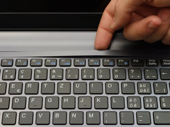

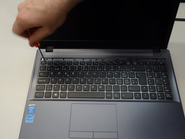

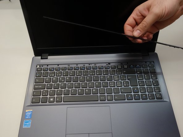

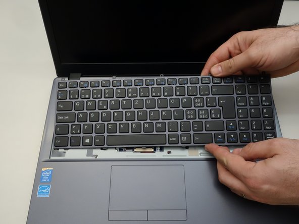

  3. why! W650SZ Keyboard Replacement, Keyboard: crwdns2935265:03crwdnd2935265:01crwdnd2935265:03crwdne2935265:0 why! W650SZ Keyboard Replacement, Keyboard: crwdns2935265:03crwdnd2935265:02crwdnd2935265:03crwdne2935265:0 why! W650SZ Keyboard Replacement, Keyboard: crwdns2935265:03crwdnd2935265:03crwdnd2935265:03crwdne2935265:0
    • Press gently at the points indicated to release the LED cover strip.
    • Turn the laptop over, then lift the LED cover.
    • Remove the LED cover.

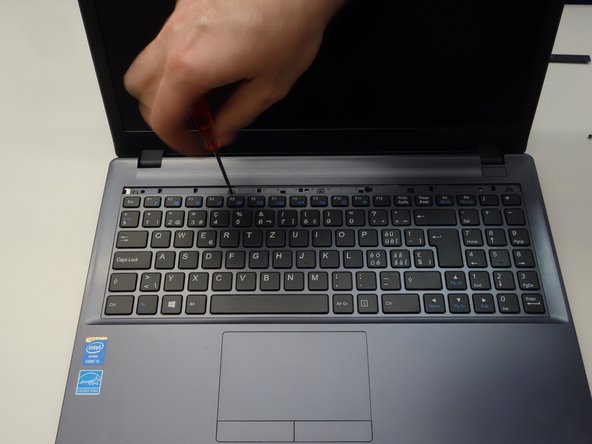

  4. why! W650SZ Keyboard Replacement: crwdns2935265:04crwdnd2935265:01crwdnd2935265:03crwdne2935265:0 why! W650SZ Keyboard Replacement: crwdns2935265:04crwdnd2935265:02crwdnd2935265:03crwdne2935265:0 why! W650SZ Keyboard Replacement: crwdns2935265:04crwdnd2935265:03crwdnd2935265:03crwdne2935265:0
    • The five screws that anchor the keyboard are now visible.
    • Start by removing the first screw.
    • Remove the remaining screws (2-5).

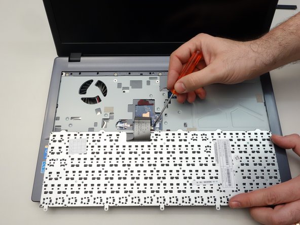

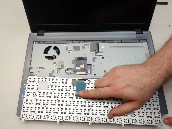

  5. why! W650SZ Keyboard Replacement: crwdns2935265:05crwdnd2935265:01crwdnd2935265:03crwdne2935265:0 why! W650SZ Keyboard Replacement: crwdns2935265:05crwdnd2935265:02crwdnd2935265:03crwdne2935265:0 why! W650SZ Keyboard Replacement: crwdns2935265:05crwdnd2935265:03crwdnd2935265:03crwdne2935265:0
    • Dismount the keyboard from the chassis.
    • Flip the keyboard forward, taking care as it is still connected by a cable to the motherboard.
    • Release the cable latch on the right side of the motherboard connector with a small flat blade screwdriver.

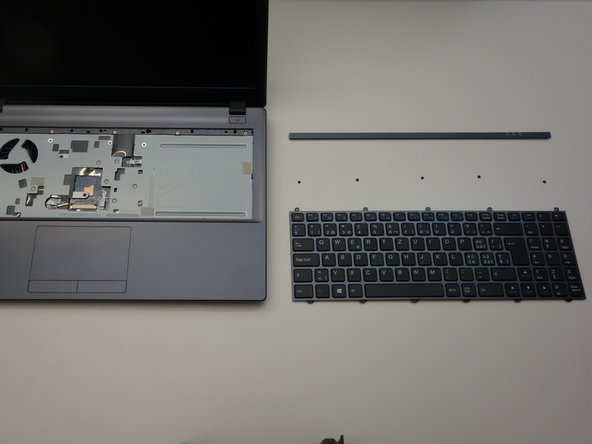

  6. why! W650SZ Keyboard Replacement: crwdns2935265:06crwdnd2935265:01crwdnd2935265:03crwdne2935265:0 why! W650SZ Keyboard Replacement: crwdns2935265:06crwdnd2935265:02crwdnd2935265:03crwdne2935265:0 why! W650SZ Keyboard Replacement: crwdns2935265:06crwdnd2935265:03crwdnd2935265:03crwdne2935265:0
    • Release the cable latch on the left side of the motherboard connector.
    • Slide the cable straight out from its connector.
    • Remove the keyboard.
