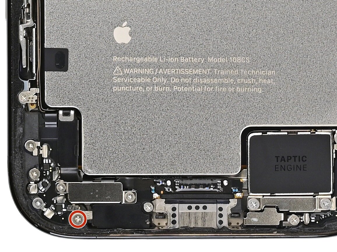

  4. iPhone Air Battery Replacement, Remove the pentalobe screws: crwdns2935265:04crwdnd2935265:01crwdnd2935265:01crwdne2935265:0
    • Use a P2 pentalobe driver to remove the two 4.9 mm-long screws on either side of the USB-C port.

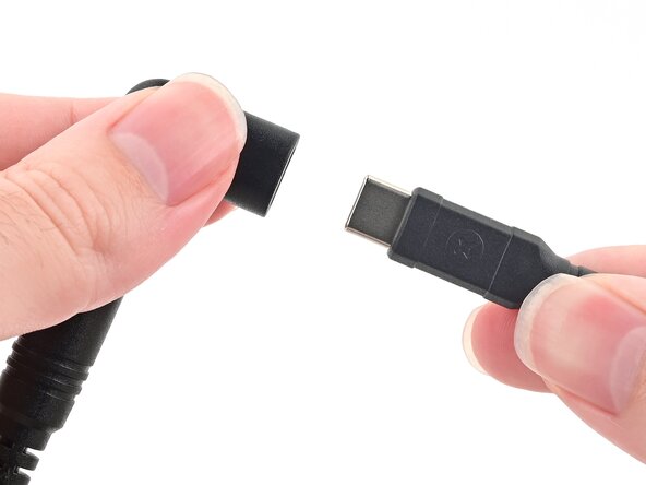

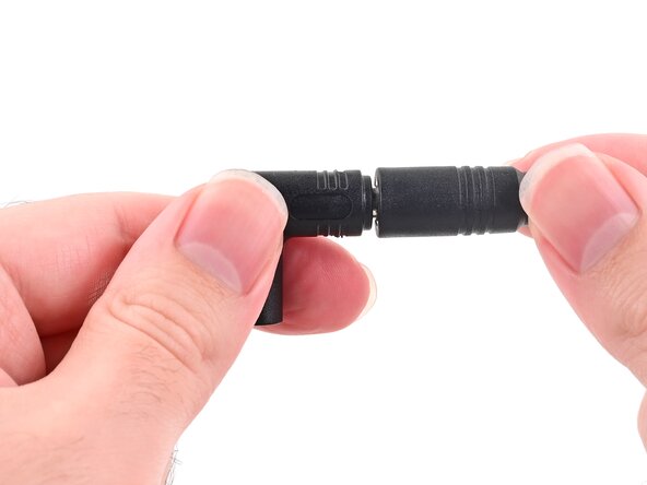

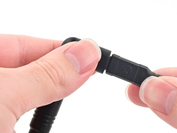

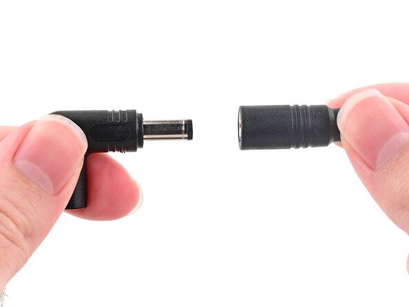

  23. iPhone Air Battery Replacement, Assemble the VoltClip: crwdns2935265:023crwdnd2935265:01crwdnd2935265:02crwdne2935265:0 iPhone Air Battery Replacement, Assemble the VoltClip: crwdns2935265:023crwdnd2935265:02crwdnd2935265:02crwdne2935265:0
    VoltClip
    $10.95
    • The guide uses the VoltClip to release the adhesive. If you're using a different method, such as a 9V battery, follow the guide normally and supplement your power source's operating procedures during the necessary steps.
    • Plug the VoltClip's barrel connector into the USB-C elbow.
    • Don't connect the VoltClip to a power source just yet. The loose alligator clips may accidentally touch each other and cause an electrical short.

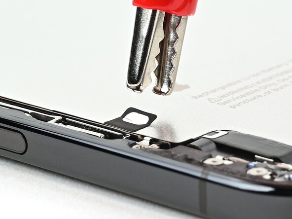

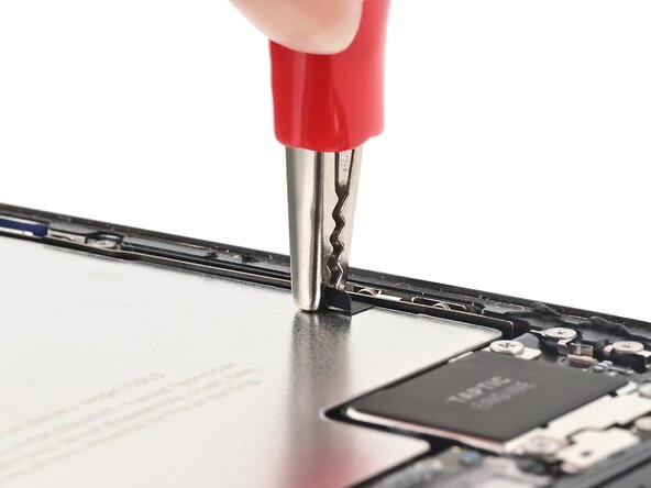

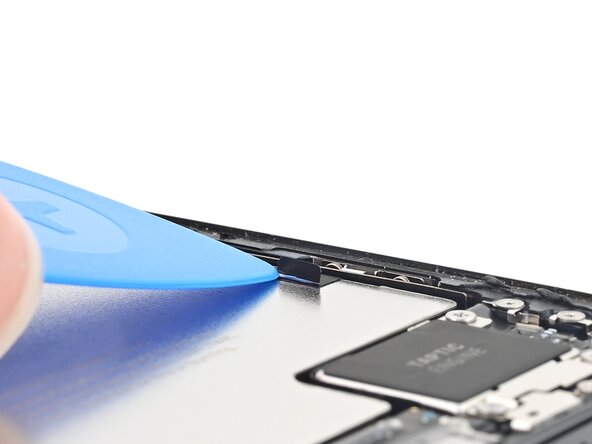

  24. iPhone Air Battery Replacement, Peel up the silver tab: crwdns2935265:024crwdnd2935265:01crwdnd2935265:02crwdne2935265:0 iPhone Air Battery Replacement, Peel up the silver tab: crwdns2935265:024crwdnd2935265:02crwdnd2935265:02crwdne2935265:0
    • Use a clean fingernail or an opening pick to peel up one of the silver tabs on the battery.

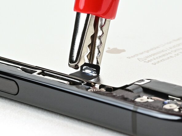

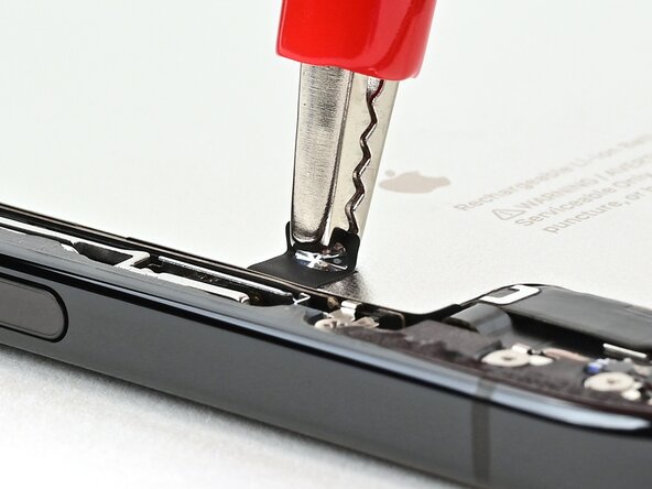

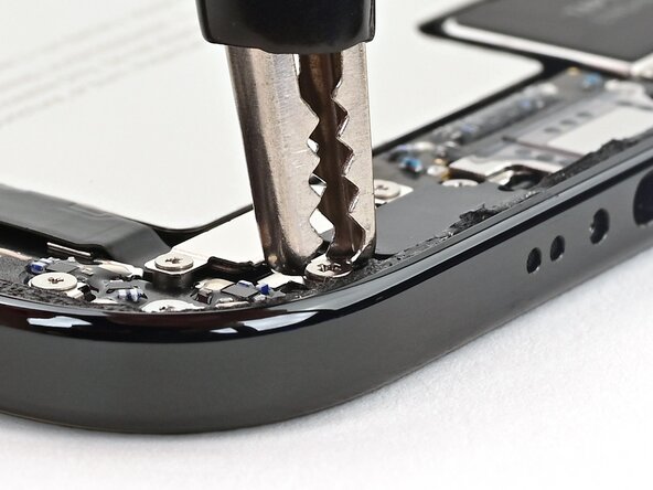

  25. iPhone Air Battery Replacement, Attach the alligator clips: crwdns2935265:025crwdnd2935265:01crwdnd2935265:03crwdne2935265:0 iPhone Air Battery Replacement, Attach the alligator clips: crwdns2935265:025crwdnd2935265:02crwdnd2935265:03crwdne2935265:0 iPhone Air Battery Replacement, Attach the alligator clips: crwdns2935265:025crwdnd2935265:03crwdnd2935265:03crwdne2935265:0
    • Attach the red alligator clip to the lifted silver tab on the battery.
    • Attach the black alligator clip to the grounding screw located on the left side of the bottom edge.

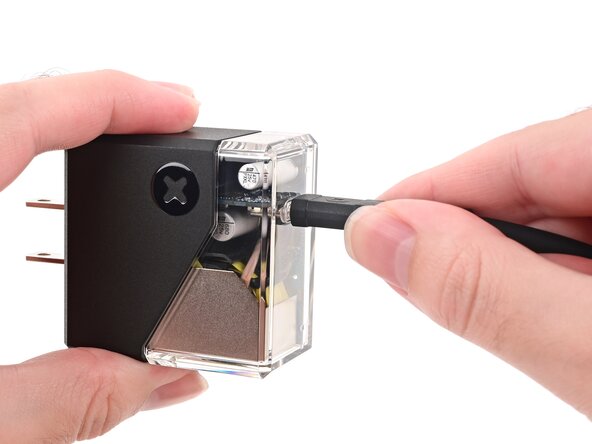

  26. iPhone Air Battery Replacement, Connect power to the VoltClip: crwdns2935265:026crwdnd2935265:01crwdnd2935265:03crwdne2935265:0 iPhone Air Battery Replacement, Connect power to the VoltClip: crwdns2935265:026crwdnd2935265:02crwdnd2935265:03crwdne2935265:0 iPhone Air Battery Replacement, Connect power to the VoltClip: crwdns2935265:026crwdnd2935265:03crwdnd2935265:03crwdne2935265:0
    • Make sure the red alligator clip is secured. If the black alligator clip pops off its screw, disconnect the USB-C cable, reseat the clip, and try again.
    • Connect the USB‑C elbow to a power source (via a USB‑C cable) and wait 90 seconds for the adhesive to loosen.

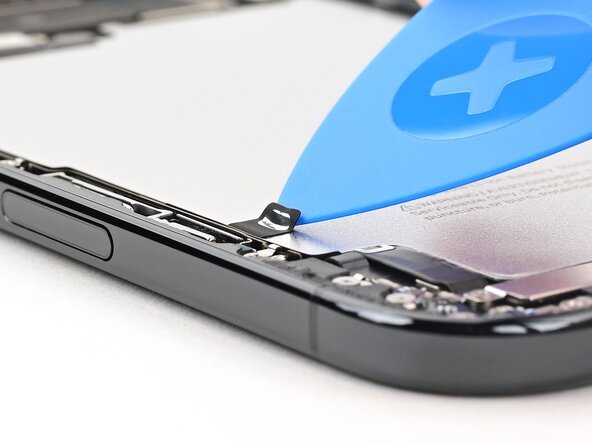

  28. iPhone Air Battery Replacement, Loosen the second strip: crwdns2935265:028crwdnd2935265:01crwdnd2935265:03crwdne2935265:0 iPhone Air Battery Replacement, Loosen the second strip: crwdns2935265:028crwdnd2935265:02crwdnd2935265:03crwdne2935265:0 iPhone Air Battery Replacement, Loosen the second strip: crwdns2935265:028crwdnd2935265:03crwdnd2935265:03crwdne2935265:0
    • Repeat this procedure on the other silver tab to loosen the second adhesive strip.

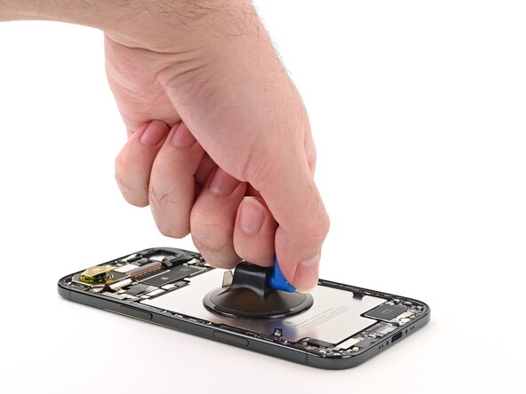

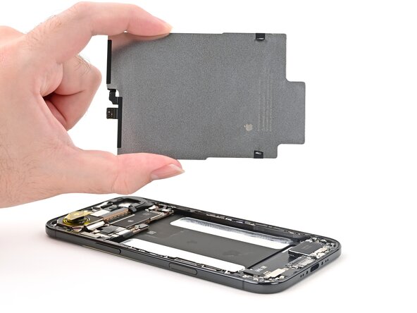

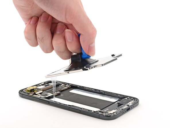

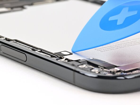

  29. iPhone Air Battery Replacement, Remove the battery: crwdns2935265:029crwdnd2935265:01crwdnd2935265:03crwdne2935265:0 iPhone Air Battery Replacement, Remove the battery: crwdns2935265:029crwdnd2935265:02crwdnd2935265:03crwdne2935265:0 iPhone Air Battery Replacement, Remove the battery: crwdns2935265:029crwdnd2935265:03crwdnd2935265:03crwdne2935265:0
    • Apply a suction handle to the center of the battery and lift it out with slow, steady force to remove it.
    • If the battery doesn't come out easily, don't force it—reconnect the VoltClip for one minute on each adhesive strip.
    • During reassembly, if your replacement battery doesn't come with pre-installed adhesive, follow this guide to install it. Afterwards, follow this guide to install the back glass.
