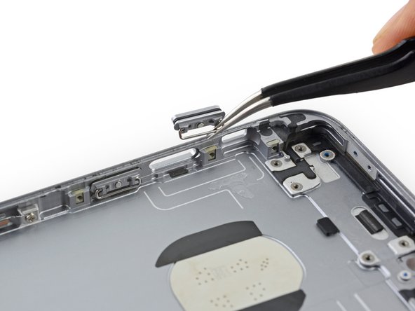

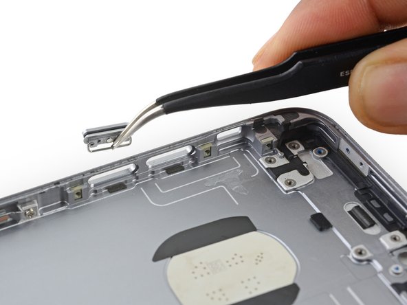

  61. iPhone 6s Volume Control Button Covers Replacement, Volume Control Button Covers: crwdns2935265:061crwdnd2935265:01crwdnd2935265:03crwdne2935265:0 iPhone 6s Volume Control Button Covers Replacement, Volume Control Button Covers: crwdns2935265:061crwdnd2935265:02crwdnd2935265:03crwdne2935265:0 iPhone 6s Volume Control Button Covers Replacement, Volume Control Button Covers: crwdns2935265:061crwdnd2935265:03crwdnd2935265:03crwdne2935265:0
    • Grasp the metal bar behind either of the two volume control button covers, and pull the button cover out of its housing in the rear case.
    • Repeat for the second volume control button cover.
    • Check for proper orientation when reinstalling the button covers. The metal bar should swing downward, towards the rear case of the iPhone.
    I changed the backcover and the buttons. The new buttons had no little round metal knobs in the middle. If these knobs are missing, you can't use the switches. I removed the metal knobs carefully with a scalpel and glued them to the new buttons.
    Michael - crwdns2934203:0crwdne2934203:0
