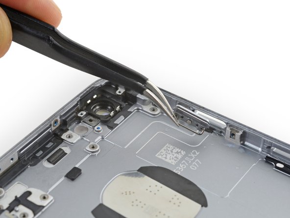

iPhone 6s Power Button Cover Replacement
    1. iPhone 6s Power Button Cover Replacement, Pentalobe Screws: crwdns2935265:01crwdnd2935265:01crwdnd2935265:01crwdne2935265:0
      • Before disassembling your iPhone, discharge the battery below 25%. A charged lithium-ion battery can catch fire and/or explode if accidentally punctured.
      • Power off your iPhone before beginning disassembly.
      • Remove the two 3.4 mm P2 Pentalobe screws on the bottom edge of the iPhone, on either side of the Lightning connector.

    1. iPhone 6s Power Button Cover Replacement, Battery Connector: crwdns2935265:015crwdnd2935265:01crwdnd2935265:01crwdne2935265:0
      Magnetic Project Mat
      $19.95
      • Remove two Phillips screws securing the battery connector bracket, of the following lengths:
      • One 2.9 mm screw
      • One 2.2 mm screw
      • Throughout this repair, keep track of each screw and make sure it goes back exactly where it came from to avoid damaging your iPhone.
    2. iPhone 6s Power Button Cover Replacement: crwdns2935265:016crwdnd2935265:01crwdnd2935265:02crwdne2935265:0 iPhone 6s Power Button Cover Replacement: crwdns2935265:016crwdnd2935265:02crwdnd2935265:02crwdne2935265:0
      • Remove the battery connector bracket from the iPhone.
    3. iPhone 6s Power Button Cover Replacement: crwdns2935265:017crwdnd2935265:01crwdnd2935265:03crwdne2935265:0 iPhone 6s Power Button Cover Replacement: crwdns2935265:017crwdnd2935265:02crwdnd2935265:03crwdne2935265:0 iPhone 6s Power Button Cover Replacement: crwdns2935265:017crwdnd2935265:03crwdnd2935265:03crwdne2935265:0
      • Use the point of a spudger to disconnect the battery connector by prying it straight up from the logic board.
    4. iPhone 6s Power Button Cover Replacement: crwdns2935265:018crwdnd2935265:01crwdnd2935265:02crwdne2935265:0 iPhone 6s Power Button Cover Replacement: crwdns2935265:018crwdnd2935265:02crwdnd2935265:02crwdne2935265:0
      • Push the battery connector away from the logic board until it stays separated from its socket, so as to avoid any accidental connection to the battery while you work.
    1. iPhone 6s Power Button Cover Replacement, Unfasten the display cable bracket: crwdns2935265:019crwdnd2935265:01crwdnd2935265:01crwdne2935265:0

    1. iPhone 6s Power Button Cover Replacement, Logic Board: crwdns2935265:032crwdnd2935265:01crwdnd2935265:01crwdne2935265:0
      • Remove the two 2.3 mm Phillips screws securing the upper component cable connector bracket.
    2. iPhone 6s Power Button Cover Replacement: crwdns2935265:033crwdnd2935265:01crwdnd2935265:02crwdne2935265:0 iPhone 6s Power Button Cover Replacement: crwdns2935265:033crwdnd2935265:02crwdnd2935265:02crwdne2935265:0
      • Remove the upper component cable connector bracket.
    3. iPhone 6s Power Button Cover Replacement: crwdns2935265:034crwdnd2935265:01crwdnd2935265:02crwdne2935265:0 iPhone 6s Power Button Cover Replacement: crwdns2935265:034crwdnd2935265:02crwdnd2935265:02crwdne2935265:0
      • Remove the following five Phillips screws securing the top left Wi-Fi antenna:
      • Two 1.5mm screws
      • One 2.3 mm screw
      • One 1.9 mm screw
      • One 2.0 mm screw
    4. iPhone 6s Power Button Cover Replacement: crwdns2935265:035crwdnd2935265:01crwdnd2935265:02crwdne2935265:0 iPhone 6s Power Button Cover Replacement: crwdns2935265:035crwdnd2935265:02crwdnd2935265:02crwdne2935265:0
      • Remove the top left Wi-Fi antenna.
    5. iPhone 6s Power Button Cover Replacement: crwdns2935265:036crwdnd2935265:01crwdnd2935265:02crwdne2935265:0 iPhone 6s Power Button Cover Replacement: crwdns2935265:036crwdnd2935265:02crwdnd2935265:02crwdne2935265:0
      • Use the flat end of a spudger to disconnect the audio control cable from its socket on the logic board.
    6. iPhone 6s Power Button Cover Replacement: crwdns2935265:037crwdnd2935265:01crwdnd2935265:02crwdne2935265:0 iPhone 6s Power Button Cover Replacement: crwdns2935265:037crwdnd2935265:02crwdnd2935265:02crwdne2935265:0
      • Use the pointed tip of a spudger to disconnect the antenna cable from its socket on the upper right corner of the logic board.
    7. iPhone 6s Power Button Cover Replacement: crwdns2935265:038crwdnd2935265:01crwdnd2935265:02crwdne2935265:0 iPhone 6s Power Button Cover Replacement: crwdns2935265:038crwdnd2935265:02crwdnd2935265:02crwdne2935265:0
      • Use the pointed tip of a spudger to disconnect the antenna cable from its socket on the lower left corner of the logic board.
    8. iPhone 6s Power Button Cover Replacement: crwdns2935265:039crwdnd2935265:01crwdnd2935265:02crwdne2935265:0 iPhone 6s Power Button Cover Replacement: crwdns2935265:039crwdnd2935265:02crwdnd2935265:02crwdne2935265:0
      • Insert the flat end of a spudger underneath the Lightning connector ribbon cable. Lift up to disconnect it from its socket on the logic board.
    9. iPhone 6s Power Button Cover Replacement: crwdns2935265:040crwdnd2935265:01crwdnd2935265:02crwdne2935265:0 iPhone 6s Power Button Cover Replacement: crwdns2935265:040crwdnd2935265:02crwdnd2935265:02crwdne2935265:0
      • Gently pull up on the antenna cable to de-route it from the two clips on the right side of the logic board.
    10. iPhone 6s Power Button Cover Replacement: crwdns2935265:041crwdnd2935265:01crwdnd2935265:01crwdne2935265:0
      • Remove the 1.3 mm Phillips screw securing the NFC bracket to the logic board.
    11. iPhone 6s Power Button Cover Replacement: crwdns2935265:042crwdnd2935265:01crwdnd2935265:02crwdne2935265:0 iPhone 6s Power Button Cover Replacement: crwdns2935265:042crwdnd2935265:02crwdnd2935265:02crwdne2935265:0
      • Remove the NFC bracket.

    1. iPhone 6s Power Button Cover Replacement, Power Button Cover: crwdns2935265:061crwdnd2935265:01crwdnd2935265:02crwdne2935265:0 iPhone 6s Power Button Cover Replacement, Power Button Cover: crwdns2935265:061crwdnd2935265:02crwdnd2935265:02crwdne2935265:0
      • Grasp the metal bar on the back of the power button cover.
      • Remove the power button cover.
      • Check for proper orientation when reinstalling the button cover. The metal bar should swing downward, towards the rear case of the iPhone.
