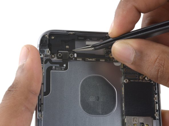

  29. iPhone 6s Plus Volume Control Button Covers Replacement, Volume Control Cable: crwdns2935265:029crwdnd2935265:01crwdnd2935265:01crwdne2935265:0
    • Remove the two 2.7 mm Phillips screws over the audio control cable bracket.
  30. iPhone 6s Plus Volume Control Button Covers Replacement: crwdns2935265:030crwdnd2935265:01crwdnd2935265:02crwdne2935265:0 iPhone 6s Plus Volume Control Button Covers Replacement: crwdns2935265:030crwdnd2935265:02crwdnd2935265:02crwdne2935265:0
    • Remove the audio control cable bracket.
  31. iPhone 6s Plus Volume Control Button Covers Replacement: crwdns2935265:031crwdnd2935265:01crwdnd2935265:02crwdne2935265:0 iPhone 6s Plus Volume Control Button Covers Replacement: crwdns2935265:031crwdnd2935265:02crwdnd2935265:02crwdne2935265:0
    • Disconnect the audio control flex cable from its socket on the logic board.
  32. iPhone 6s Plus Volume Control Button Covers Replacement: crwdns2935265:032crwdnd2935265:01crwdnd2935265:02crwdne2935265:0 iPhone 6s Plus Volume Control Button Covers Replacement: crwdns2935265:032crwdnd2935265:02crwdnd2935265:02crwdne2935265:0
    • Remove the circular sticker covering the third screw securing the cellular antenna to the rear case.
  33. iPhone 6s Plus Volume Control Button Covers Replacement: crwdns2935265:033crwdnd2935265:01crwdnd2935265:01crwdne2935265:0
    • Remove the following three Phillips screws:
    • One 2.7 mm screw
    • One 1.7 mm screw
    • One 1.3 mm screw

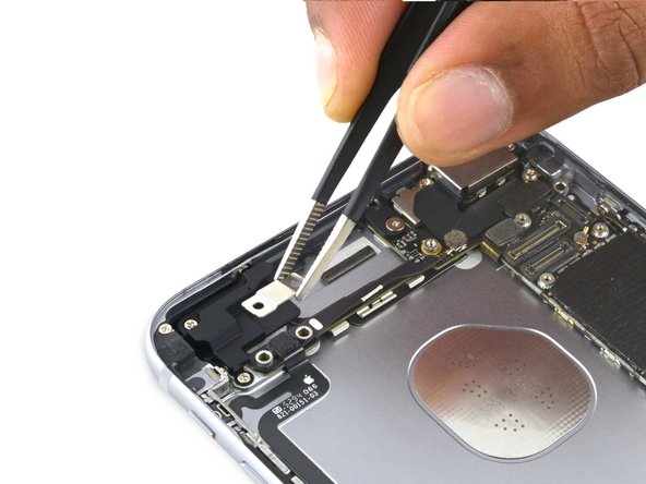

  34. iPhone 6s Plus Volume Control Button Covers Replacement: crwdns2935265:034crwdnd2935265:01crwdnd2935265:02crwdne2935265:0 iPhone 6s Plus Volume Control Button Covers Replacement: crwdns2935265:034crwdnd2935265:02crwdnd2935265:02crwdne2935265:0
    • Lift, but do not remove, the cellular antenna to reveal the third screw securing the audio control cable to the rear case.
  35. iPhone 6s Plus Volume Control Button Covers Replacement: crwdns2935265:035crwdnd2935265:01crwdnd2935265:01crwdne2935265:0
    • Remove the three 2.4 mm Phillips screws over the audio control cable bracket.
  36. iPhone 6s Plus Volume Control Button Covers Replacement: crwdns2935265:036crwdnd2935265:01crwdnd2935265:02crwdne2935265:0 iPhone 6s Plus Volume Control Button Covers Replacement: crwdns2935265:036crwdnd2935265:02crwdnd2935265:02crwdne2935265:0
    • Use the flat end of a spudger to peel the volume control flex cable off the rear case.
  37. iPhone 6s Plus Volume Control Button Covers Replacement: crwdns2935265:037crwdnd2935265:01crwdnd2935265:02crwdne2935265:0 iPhone 6s Plus Volume Control Button Covers Replacement: crwdns2935265:037crwdnd2935265:02crwdnd2935265:02crwdne2935265:0
    • Remove the volume control flex cable.
    • The cable assembly has two separate pieces connected by a ribbon cable—the volume control buttons and silent switch.
  38. iPhone 6s Plus Volume Control Button Covers Replacement, Volume Control Button Covers: crwdns2935265:038crwdnd2935265:01crwdnd2935265:03crwdne2935265:0 iPhone 6s Plus Volume Control Button Covers Replacement, Volume Control Button Covers: crwdns2935265:038crwdnd2935265:02crwdnd2935265:03crwdne2935265:0 iPhone 6s Plus Volume Control Button Covers Replacement, Volume Control Button Covers: crwdns2935265:038crwdnd2935265:03crwdnd2935265:03crwdne2935265:0
    • Gently nudge the volume control button covers out of their slots in the rear case.
  39. iPhone 6s Plus Volume Control Button Covers Replacement: crwdns2935265:039crwdnd2935265:01crwdnd2935265:02crwdne2935265:0 iPhone 6s Plus Volume Control Button Covers Replacement: crwdns2935265:039crwdnd2935265:02crwdnd2935265:02crwdne2935265:0
    • Remove the two button covers.
