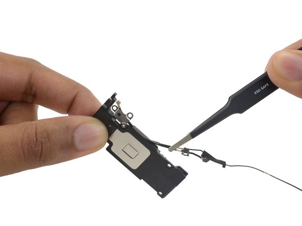

  35. iPhone 6s Plus Speaker Replacement, Wi-Fi Diversity Antenna: crwdns2935265:035crwdnd2935265:01crwdnd2935265:03crwdne2935265:0 iPhone 6s Plus Speaker Replacement, Wi-Fi Diversity Antenna: crwdns2935265:035crwdnd2935265:02crwdnd2935265:03crwdne2935265:0 iPhone 6s Plus Speaker Replacement, Wi-Fi Diversity Antenna: crwdns2935265:035crwdnd2935265:03crwdnd2935265:03crwdne2935265:0
    • Use a pair of tweezers to begin peeling the antenna cables off of the speaker.
    The shorter cable is disconnected at both ends and will come free. If you followed my earlier recommendation, the longer cable is still connected at the logic board end and so needs to be separated from the speaker but left in place in the phone.
    Mark Cousins - crwdns2934203:0crwdne2934203:0

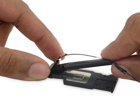

  36. iPhone 6s Plus Speaker Replacement: crwdns2935265:036crwdnd2935265:01crwdnd2935265:03crwdne2935265:0 iPhone 6s Plus Speaker Replacement: crwdns2935265:036crwdnd2935265:02crwdnd2935265:03crwdne2935265:0 iPhone 6s Plus Speaker Replacement: crwdns2935265:036crwdnd2935265:03crwdnd2935265:03crwdne2935265:0
    • Continue peeling the antenna cables off the long side of the speaker
    • At this point, the clip holding the antenna cables may fall off the speaker. If it does, be sure to keep track of it for reassembly.
