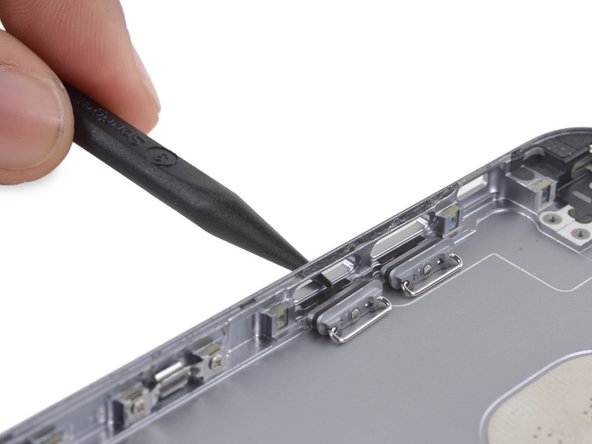

iPhone 6s Plus Rear Case Replacement
Use this guide to replace a bent or damaged rear case, or to swap out the rear case for cosmetic reasons. The rear case serves as the chassis for the entire phone, so replacing it involves removing all the iPhone's components.
You can also use this guide to replace the following parts:
  • IFC Bracket
  • Loudspeaker Mount
  • Microphone Mount
  • Front Panel Clips

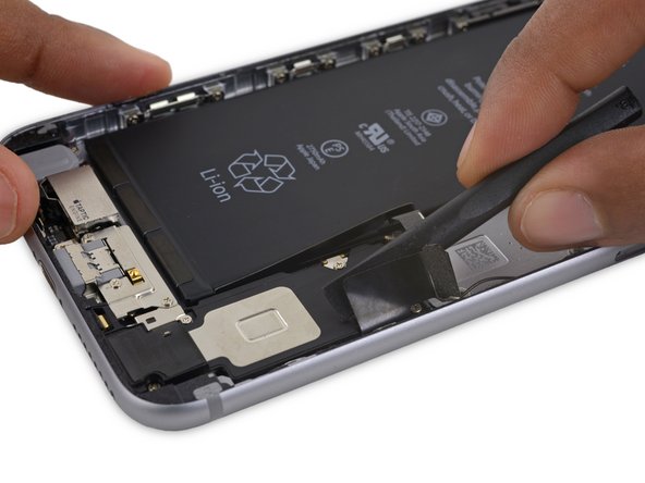

    1. iPhone 6s Plus Rear Case Replacement, Battery Connector: crwdns2935265:015crwdnd2935265:01crwdnd2935265:01crwdne2935265:0
      Magnetic Project Mat
      $19.95
      • Use a Phillips #000 driver to remove the two screws securing the battery connector bracket to the logic board, of the following lengths:
      • One 2.9 mm screw
      • One 2.3 mm screw
      • Throughout this guide, keep careful track of your screws so that each one goes back where it came from during reassembly. Installing a screw in the wrong place can cause permanent damage.
    2. iPhone 6s Plus Rear Case Replacement: crwdns2935265:016crwdnd2935265:01crwdnd2935265:02crwdne2935265:0 iPhone 6s Plus Rear Case Replacement: crwdns2935265:016crwdnd2935265:02crwdnd2935265:02crwdne2935265:0
      • Remove the battery connector bracket.
    3. iPhone 6s Plus Rear Case Replacement: crwdns2935265:017crwdnd2935265:01crwdnd2935265:03crwdne2935265:0 iPhone 6s Plus Rear Case Replacement: crwdns2935265:017crwdnd2935265:02crwdnd2935265:03crwdne2935265:0 iPhone 6s Plus Rear Case Replacement: crwdns2935265:017crwdnd2935265:03crwdnd2935265:03crwdne2935265:0
      • Use a spudger or a clean fingernail to disconnect the battery connector by prying it straight up off the logic board.
    4. iPhone 6s Plus Rear Case Replacement: crwdns2935265:018crwdnd2935265:01crwdnd2935265:03crwdne2935265:0 iPhone 6s Plus Rear Case Replacement: crwdns2935265:018crwdnd2935265:02crwdnd2935265:03crwdne2935265:0 iPhone 6s Plus Rear Case Replacement: crwdns2935265:018crwdnd2935265:03crwdnd2935265:03crwdne2935265:0
      • Bend the connector back to ensure it doesn't make contact and power the iPhone on while you're working on it.

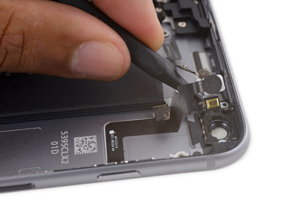

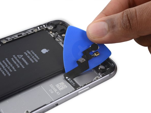

    1. iPhone 6s Plus Rear Case Replacement, iSight Camera: crwdns2935265:025crwdnd2935265:01crwdnd2935265:03crwdne2935265:0 iPhone 6s Plus Rear Case Replacement, iSight Camera: crwdns2935265:025crwdnd2935265:02crwdnd2935265:03crwdne2935265:0 iPhone 6s Plus Rear Case Replacement, iSight Camera: crwdns2935265:025crwdnd2935265:03crwdnd2935265:03crwdne2935265:0
      • Peel up any tape covering the iSight camera bracket screws.
    2. iPhone 6s Plus Rear Case Replacement: crwdns2935265:026crwdnd2935265:01crwdnd2935265:01crwdne2935265:0
      • Remove the following Phillips screws over the camera bracket:
      • One 1.9 mm screw
      • One 2.4 mm screw
    3. iPhone 6s Plus Rear Case Replacement: crwdns2935265:027crwdnd2935265:01crwdnd2935265:02crwdne2935265:0 iPhone 6s Plus Rear Case Replacement: crwdns2935265:027crwdnd2935265:02crwdnd2935265:02crwdne2935265:0
      • Remove the iSight camera bracket.
    4. iPhone 6s Plus Rear Case Replacement: crwdns2935265:028crwdnd2935265:01crwdnd2935265:02crwdne2935265:0 iPhone 6s Plus Rear Case Replacement: crwdns2935265:028crwdnd2935265:02crwdnd2935265:02crwdne2935265:0
      • Disconnect the iSight camera connector from its socket on the logic board.
      • Be sure to pry up only the connector and not the socket on the logic board.
    5. iPhone 6s Plus Rear Case Replacement: crwdns2935265:029crwdnd2935265:01crwdnd2935265:02crwdne2935265:0 iPhone 6s Plus Rear Case Replacement: crwdns2935265:029crwdnd2935265:02crwdnd2935265:02crwdne2935265:0
      • Insert the flat end of the spudger between the iSight camera and rear casing.
      • Gently pry the camera out from its housing.
    6. iPhone 6s Plus Rear Case Replacement: crwdns2935265:030crwdnd2935265:01crwdnd2935265:02crwdne2935265:0 iPhone 6s Plus Rear Case Replacement: crwdns2935265:030crwdnd2935265:02crwdnd2935265:02crwdne2935265:0
      • Remove the iSight camera.

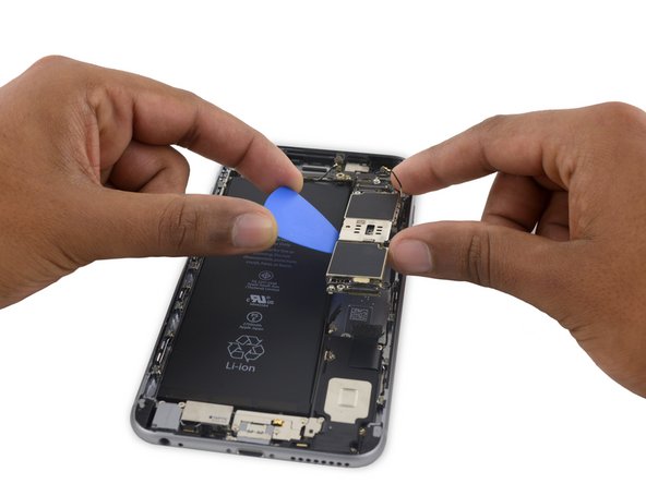

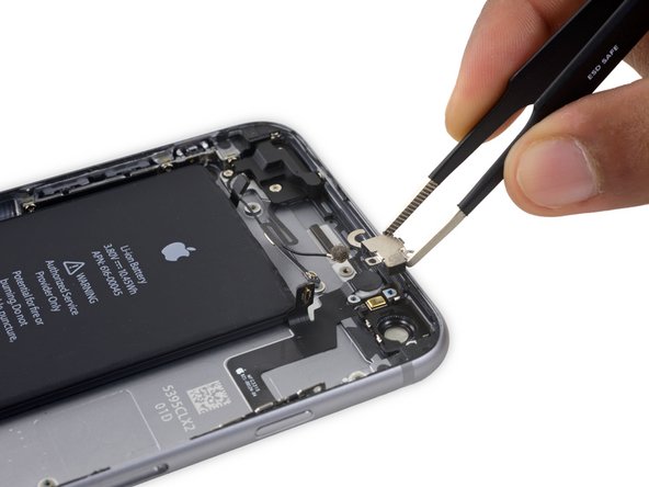

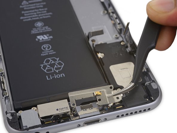

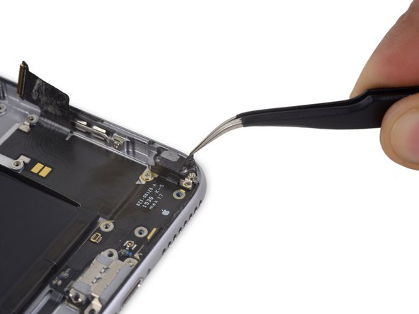

    1. iPhone 6s Plus Rear Case Replacement, Logic Board: crwdns2935265:033crwdnd2935265:01crwdnd2935265:01crwdne2935265:0
      • Remove the single 1.4 mm Phillips screw holding the NFC bracket in place.
    2. iPhone 6s Plus Rear Case Replacement: crwdns2935265:034crwdnd2935265:01crwdnd2935265:02crwdne2935265:0 iPhone 6s Plus Rear Case Replacement: crwdns2935265:034crwdnd2935265:02crwdnd2935265:02crwdne2935265:0
      • Remove the NFC bracket.

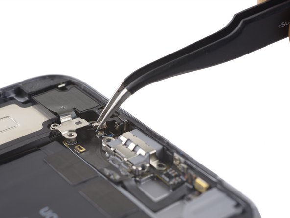

    3. iPhone 6s Plus Rear Case Replacement: crwdns2935265:035crwdnd2935265:01crwdnd2935265:01crwdne2935265:0
      • Remove the two 2.7 mm Phillips screws securing the audio control cable bracket to the logic board.
    4. iPhone 6s Plus Rear Case Replacement: crwdns2935265:036crwdnd2935265:01crwdnd2935265:02crwdne2935265:0 iPhone 6s Plus Rear Case Replacement: crwdns2935265:036crwdnd2935265:02crwdnd2935265:02crwdne2935265:0
      • Remove the audio control cable bracket.
    5. iPhone 6s Plus Rear Case Replacement: crwdns2935265:037crwdnd2935265:01crwdnd2935265:02crwdne2935265:0 iPhone 6s Plus Rear Case Replacement: crwdns2935265:037crwdnd2935265:02crwdnd2935265:02crwdne2935265:0

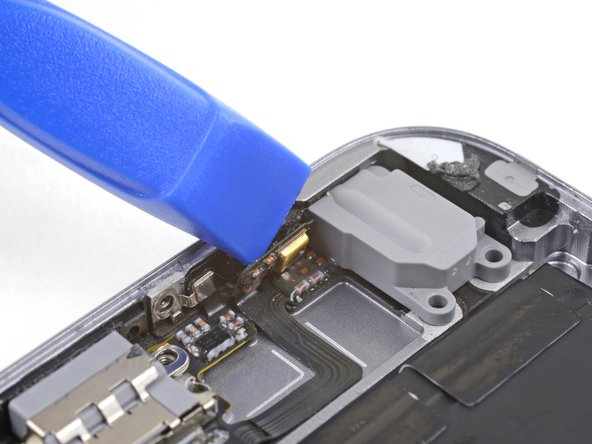

      • Disconnect the audio control cable by prying its connector straight up from its socket on the logic board.
    6. iPhone 6s Plus Rear Case Replacement: crwdns2935265:038crwdnd2935265:01crwdnd2935265:02crwdne2935265:0 iPhone 6s Plus Rear Case Replacement: crwdns2935265:038crwdnd2935265:02crwdnd2935265:02crwdne2935265:0

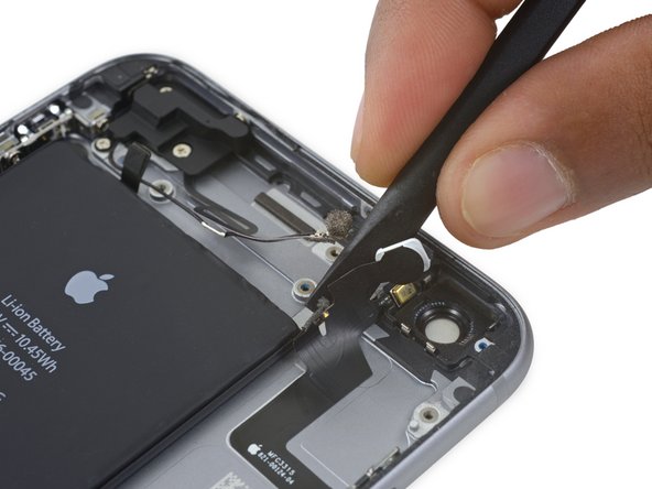

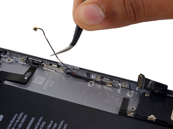

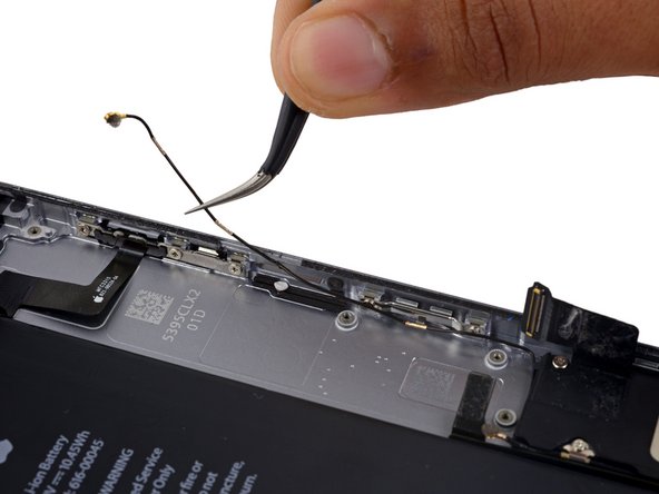

      • Disconnect the cellular antenna cable by prying its connector straight up from its respective socket on the logic board.
    7. iPhone 6s Plus Rear Case Replacement: crwdns2935265:039crwdnd2935265:01crwdnd2935265:02crwdne2935265:0 iPhone 6s Plus Rear Case Replacement: crwdns2935265:039crwdnd2935265:02crwdnd2935265:02crwdne2935265:0
      • Disconnect the Wi-Fi diversity antenna cable by prying its connector up from the logic board.
    8. iPhone 6s Plus Rear Case Replacement: crwdns2935265:040crwdnd2935265:01crwdnd2935265:02crwdne2935265:0 iPhone 6s Plus Rear Case Replacement: crwdns2935265:040crwdnd2935265:02crwdnd2935265:02crwdne2935265:0

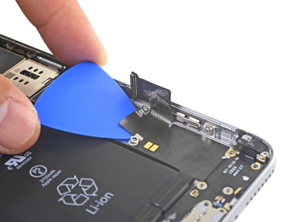

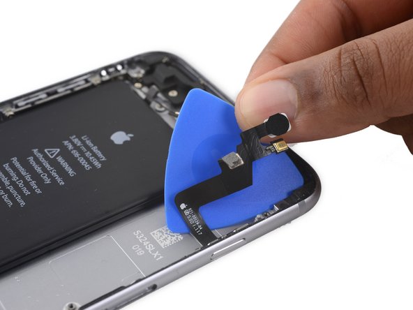

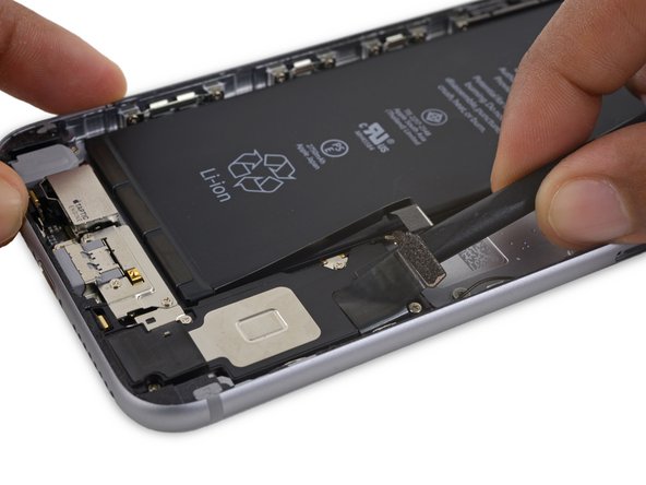

      • Disconnect the power button flex cable from its socket on the logic board.
    9. iPhone 6s Plus Rear Case Replacement: crwdns2935265:041crwdnd2935265:01crwdnd2935265:02crwdne2935265:0 iPhone 6s Plus Rear Case Replacement: crwdns2935265:041crwdnd2935265:02crwdnd2935265:02crwdne2935265:0

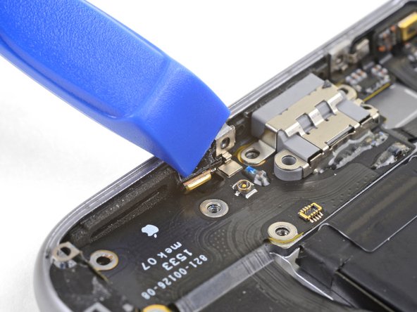

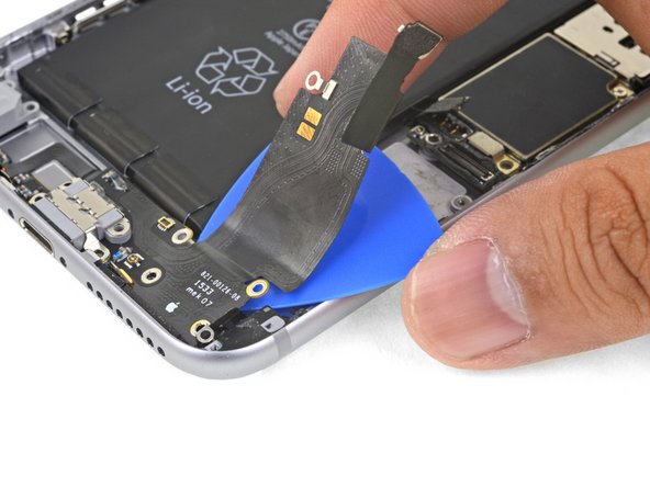

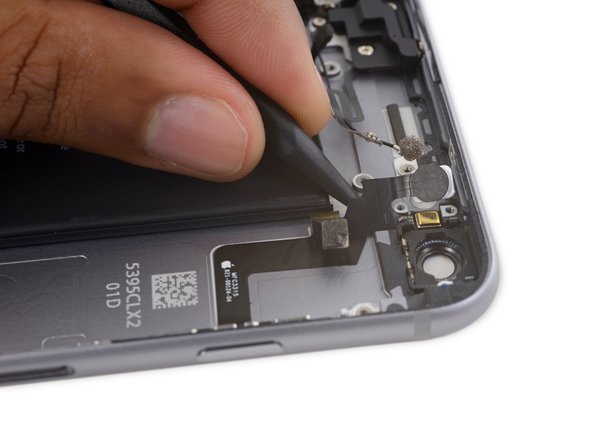

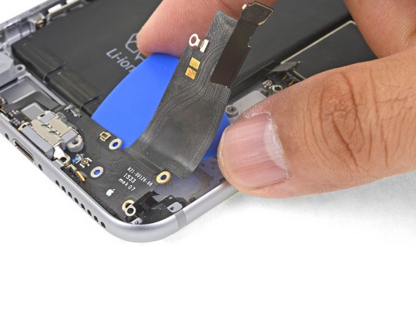

      • Disconnect the antenna cable by prying it up from the logic board.
    10. iPhone 6s Plus Rear Case Replacement: crwdns2935265:042crwdnd2935265:01crwdnd2935265:02crwdne2935265:0 iPhone 6s Plus Rear Case Replacement: crwdns2935265:042crwdnd2935265:02crwdnd2935265:02crwdne2935265:0

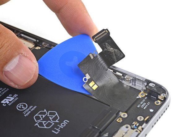

      • Use the flat end of a spudger to disconnect the Lightning connector flex cable from the logic board.

      • Remove the bracket.

      • Deroute the upper left cellular antenna cable from the first logic board clip by nudging it out from under the clip, towards the battery.
    15. iPhone 6s Plus Rear Case Replacement: crwdns2935265:047crwdnd2935265:01crwdnd2935265:03crwdne2935265:0 iPhone 6s Plus Rear Case Replacement: crwdns2935265:047crwdnd2935265:02crwdnd2935265:03crwdne2935265:0 iPhone 6s Plus Rear Case Replacement: crwdns2935265:047crwdnd2935265:03crwdnd2935265:03crwdne2935265:0
      • Continue derouting the cellular antenna cable from the second and third logic board clips.
      • Use the pointed tip of a spudger to gently pry the cellular antenna cable from the middle logic board clip.
      • Don't try to remove it by pulling on the cable, as it will tear easily.
      • In order for the cable to reach its socket on the logic board, you must route it above the logic board and underneath the audio control flex cable, as shown in the first photo.

      • Carefully raise—but do not remove—the logic board, lifting it from the bottom edge nearest the Lightning connector.
    18. iPhone 6s Plus Rear Case Replacement: crwdns2935265:050crwdnd2935265:01crwdnd2935265:03crwdne2935265:0 iPhone 6s Plus Rear Case Replacement: crwdns2935265:050crwdnd2935265:02crwdnd2935265:03crwdne2935265:0 iPhone 6s Plus Rear Case Replacement: crwdns2935265:050crwdnd2935265:03crwdnd2935265:03crwdne2935265:0
      • Tip the logic board up to a vertical position to expose the single antenna connector on the underside, near the top edge of the board.
      • Do not attempt to fully remove the logic board yet, as the Wi-Fi/Bluetooth antenna is still connected to the underside of the board.

    1. iPhone 6s Plus Rear Case Replacement, Speaker Assembly: crwdns2935265:053crwdnd2935265:01crwdnd2935265:03crwdne2935265:0 iPhone 6s Plus Rear Case Replacement, Speaker Assembly: crwdns2935265:053crwdnd2935265:02crwdnd2935265:03crwdne2935265:0 iPhone 6s Plus Rear Case Replacement, Speaker Assembly: crwdns2935265:053crwdnd2935265:03crwdnd2935265:03crwdne2935265:0
      • Use the flat end of a spudger to peel the Lightning connector flex cable off the speaker.
    2. iPhone 6s Plus Rear Case Replacement: crwdns2935265:054crwdnd2935265:01crwdnd2935265:02crwdne2935265:0 iPhone 6s Plus Rear Case Replacement: crwdns2935265:054crwdnd2935265:02crwdnd2935265:02crwdne2935265:0
      • Remove the following three Phillips screws from the Taptic Engine cable bracket:
      • Two 3.5 mm screws
      • One 2.7 mm screw

      • Deroute the Wi-Fi diversity antenna cable from its rubber sleeve.
      • If the white water damage indicator sticker makes it difficult to deroute the antenna cable, gently peel the sticker back for better access.
    5. iPhone 6s Plus Rear Case Replacement: crwdns2935265:057crwdnd2935265:01crwdnd2935265:02crwdne2935265:0 iPhone 6s Plus Rear Case Replacement: crwdns2935265:057crwdnd2935265:02crwdnd2935265:02crwdne2935265:0
      • Use a pair of tweezers to disconnect the Wi-Fi diversity antenna cable from the Lightning connector flex cable.

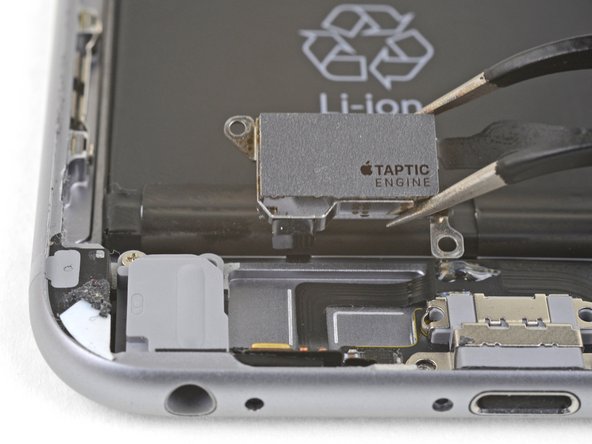

      • Use the point of a spudger to disconnect the Taptic Engine flex cable from the lower flex cable.
    2. iPhone 6s Plus Rear Case Replacement: crwdns2935265:061crwdnd2935265:01crwdnd2935265:02crwdne2935265:0 iPhone 6s Plus Rear Case Replacement: crwdns2935265:061crwdnd2935265:02crwdnd2935265:02crwdne2935265:0
      • Remove the two Phillips screws securing the Taptic Engine to the rear case:
      • One 3.1 mm screw
      • One 2.1 mm screw
      • Remove the Taptic Engine.

    5. iPhone 6s Plus Rear Case Replacement: crwdns2935265:064crwdnd2935265:01crwdnd2935265:01crwdne2935265:0
      • Prepare an iOpener and lay it across the bottom of the phone to soften the adhesive holding the Lightning connector flex cable in place.
      • Wait about a minute for the adhesive to soften before removing the iOpener and continuing.
    6. iPhone 6s Plus Rear Case Replacement: crwdns2935265:065crwdnd2935265:01crwdnd2935265:03crwdne2935265:0 iPhone 6s Plus Rear Case Replacement: crwdns2935265:065crwdnd2935265:02crwdnd2935265:03crwdne2935265:0 iPhone 6s Plus Rear Case Replacement: crwdns2935265:065crwdnd2935265:03crwdnd2935265:03crwdne2935265:0
      • Insert an opening pick under the Lightning connector flex cable and slowly slice through the adhesive holding the cable to the rear case.
    7. iPhone 6s Plus Rear Case Replacement: crwdns2935265:066crwdnd2935265:01crwdnd2935265:03crwdne2935265:0 iPhone 6s Plus Rear Case Replacement: crwdns2935265:066crwdnd2935265:02crwdnd2935265:03crwdne2935265:0 iPhone 6s Plus Rear Case Replacement: crwdns2935265:066crwdnd2935265:03crwdnd2935265:03crwdne2935265:0
      • Continue sliding the opening pick underneath the flex cable.
    8. iPhone 6s Plus Rear Case Replacement: crwdns2935265:067crwdnd2935265:01crwdnd2935265:03crwdne2935265:0 iPhone 6s Plus Rear Case Replacement: crwdns2935265:067crwdnd2935265:02crwdnd2935265:03crwdne2935265:0 iPhone 6s Plus Rear Case Replacement: crwdns2935265:067crwdnd2935265:03crwdnd2935265:03crwdne2935265:0

      • Insert the point of a spudger into the headphone jack and wiggle it slightly to loosen the headphone jack from the bottom edge of the case.
    10. iPhone 6s Plus Rear Case Replacement: crwdns2935265:069crwdnd2935265:01crwdnd2935265:03crwdne2935265:0 iPhone 6s Plus Rear Case Replacement: crwdns2935265:069crwdnd2935265:02crwdnd2935265:03crwdne2935265:0 iPhone 6s Plus Rear Case Replacement: crwdns2935265:069crwdnd2935265:03crwdnd2935265:03crwdne2935265:0
      • Remove the Lightning connector assembly.
      • If your replacement part did not come with a headphone jack gasket, use tweezers to remove the gasket from the old part and transfer it to the replacement part.
      • Before re-installation, use a spudger to scour any remaining adhesive residue from the rear case. You can use high concentration isopropyl alcohol to help with the process.

      • Use the pointed end of a spudger to lift the flash out of its housing in the rear case.
    4. iPhone 6s Plus Rear Case Replacement: crwdns2935265:073crwdnd2935265:01crwdnd2935265:02crwdne2935265:0 iPhone 6s Plus Rear Case Replacement: crwdns2935265:073crwdnd2935265:02crwdnd2935265:02crwdne2935265:0
      • Use the flat end of a spudger to peel the power button flex cable off the rear case.
    5. iPhone 6s Plus Rear Case Replacement: crwdns2935265:074crwdnd2935265:01crwdnd2935265:03crwdne2935265:0 iPhone 6s Plus Rear Case Replacement: crwdns2935265:074crwdnd2935265:02crwdnd2935265:03crwdne2935265:0 iPhone 6s Plus Rear Case Replacement: crwdns2935265:074crwdnd2935265:03crwdnd2935265:03crwdne2935265:0
      • Insert the tip of a spudger underneath the microphone portion of the flex cable and gently pry it off of the rear case.
    6. iPhone 6s Plus Rear Case Replacement: crwdns2935265:075crwdnd2935265:01crwdnd2935265:03crwdne2935265:0 iPhone 6s Plus Rear Case Replacement: crwdns2935265:075crwdnd2935265:02crwdnd2935265:03crwdne2935265:0 iPhone 6s Plus Rear Case Replacement: crwdns2935265:075crwdnd2935265:03crwdnd2935265:03crwdne2935265:0
      • Slide an opening pick underneath the power button flex cable to pry the cable off the rear case.
    7. iPhone 6s Plus Rear Case Replacement: crwdns2935265:076crwdnd2935265:01crwdnd2935265:02crwdne2935265:0 iPhone 6s Plus Rear Case Replacement: crwdns2935265:076crwdnd2935265:02crwdnd2935265:02crwdne2935265:0
      • Remove the power button flex cable.

    1. iPhone 6s Plus Rear Case Replacement, Rear Case: crwdns2935265:079crwdnd2935265:01crwdnd2935265:01crwdne2935265:0
      • Remove the following screws holding the cellular antenna in place:
      • One 2.7 mm Phillips screw
      • One 1.7 mm Phillips screw
      • One 1.3 mm Phillips screw
    2. iPhone 6s Plus Rear Case Replacement: crwdns2935265:080crwdnd2935265:01crwdnd2935265:02crwdne2935265:0 iPhone 6s Plus Rear Case Replacement: crwdns2935265:080crwdnd2935265:02crwdnd2935265:02crwdne2935265:0
      • Remove the cellular antenna.
    3. iPhone 6s Plus Rear Case Replacement: crwdns2935265:081crwdnd2935265:01crwdnd2935265:01crwdne2935265:0
      • Remove the single 1.3 mm Phillips screw securing the Wi-Fi/Bluetooth antenna to the rear case.
    4. iPhone 6s Plus Rear Case Replacement: crwdns2935265:082crwdnd2935265:01crwdnd2935265:02crwdne2935265:0 iPhone 6s Plus Rear Case Replacement: crwdns2935265:082crwdnd2935265:02crwdnd2935265:02crwdne2935265:0
      • Remove the Wi-Fi/Bluetooth antenna.
    5. iPhone 6s Plus Rear Case Replacement: crwdns2935265:083crwdnd2935265:01crwdnd2935265:03crwdne2935265:0 iPhone 6s Plus Rear Case Replacement: crwdns2935265:083crwdnd2935265:02crwdnd2935265:03crwdne2935265:0 iPhone 6s Plus Rear Case Replacement: crwdns2935265:083crwdnd2935265:03crwdnd2935265:03crwdne2935265:0
      • Use a pair of tweezers to peel back the tips of the three battery adhesive strips along the bottom edge of the battery.
    6. iPhone 6s Plus Rear Case Replacement: crwdns2935265:084crwdnd2935265:01crwdnd2935265:01crwdne2935265:0
      • Gather all three tips of the battery adhesive strips in one hand.
      • Be sure to not wrinkle any of the strips during this procedure—they will become very difficult to deal with and will not straighten out again.
    7. iPhone 6s Plus Rear Case Replacement: crwdns2935265:085crwdnd2935265:01crwdnd2935265:03crwdne2935265:0 iPhone 6s Plus Rear Case Replacement: crwdns2935265:085crwdnd2935265:02crwdnd2935265:03crwdne2935265:0 iPhone 6s Plus Rear Case Replacement: crwdns2935265:085crwdnd2935265:03crwdnd2935265:03crwdne2935265:0
      • Pull the adhesive strips straight out, keeping the strips flat and wide until they are completely removed. For best results, pull the strips at a 60º angle or less.
      • The strips will stretch to many times their original length. Continue pulling until you completely remove all three strips.
      • Hold down the battery with one hand as you're pulling, or the elastic strips will fling the battery from the phone once they're separated from the rear case.
    8. iPhone 6s Plus Rear Case Replacement: crwdns2935265:086crwdnd2935265:01crwdnd2935265:02crwdne2935265:0 iPhone 6s Plus Rear Case Replacement: crwdns2935265:086crwdnd2935265:02crwdnd2935265:02crwdne2935265:0

      • Prepare an iOpener and apply it to the back of the rear case, directly over the battery. Alternatively, you can apply heat using a heat gun or hair dryer.
      • After about a minute, flip the phone over and use a plastic card to tear through any remaining adhesive.
    9. iPhone 6s Plus Rear Case Replacement: crwdns2935265:087crwdnd2935265:01crwdnd2935265:01crwdne2935265:0
      • Remove the battery.

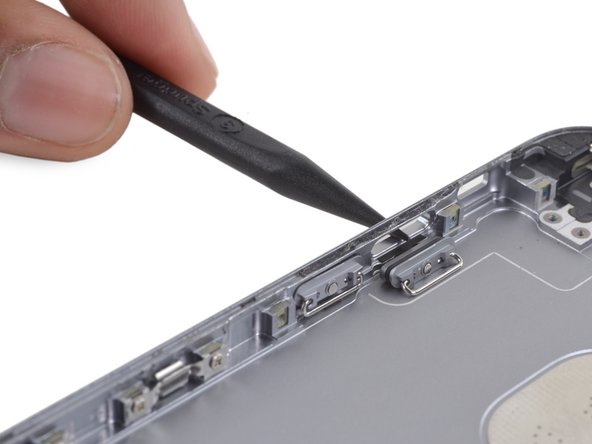

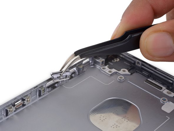

      • Use the pointed tip of a spudger to nudge the volume control button covers out of their slots in the rear case.
    14. iPhone 6s Plus Rear Case Replacement: crwdns2935265:092crwdnd2935265:01crwdnd2935265:02crwdne2935265:0 iPhone 6s Plus Rear Case Replacement: crwdns2935265:092crwdnd2935265:02crwdnd2935265:02crwdne2935265:0
      • Remove the volume control button covers.
