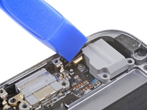

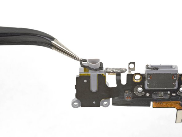

  27. iPhone 6s Lightning Connector Assembly Replacement, Speaker: crwdns2935265:027crwdnd2935265:01crwdnd2935265:02crwdne2935265:0 iPhone 6s Lightning Connector Assembly Replacement, Speaker: crwdns2935265:027crwdnd2935265:02crwdnd2935265:02crwdne2935265:0
    • Use the point of a spudger to lift and disconnect the antenna cable from the bottom end of the logic board.
    • To reconnect antenna cables like these to the socket, carefully align the connector to the socket, then use the flat end of a spudger to press down. It should click in place. If not, check for alignment. Do not use excessive force.
    Do not remove the isolation on top of the antenna or it will stop working. If you already removed it, use a piece of isolation tape to isolate it again.
    Jan - crwdns2934203:0crwdne2934203:0
    There is no instruction on how to reconnect this antenna cable, and it is proving extremely difficult, at least for myself… Please help!
    Brennan Lutkewitte - crwdns2934203:0crwdne2934203:0
    Arthur Shi -
    What does this cable do?
    Because accidentaly broke mine, but everything working fine, just want to be sure , what does it for!
    I broke at the end, when the gold round is. Somehow i placed the cable with that round ring , just to be sure , thst there is some contact with it, and pluged in!
    I know, i need to change the whole bracket with charging port etc., to fix the cable, cause i cant solder the conector back. But maybe i can just ignore the cable?
    sekuent - crwdns2934203:0crwdne2934203:0
    Hi Sekuent,
    That cable attaches to possibly cellular antennas. It may be that certain bands are impacted by the break.
    Arthur Shi -
    Some more research may indicate that it may instead be the 2.4GHz Wi-Fi bands.
    Arthur Shi -
    I also broke this antenna off. I left it off as per suggestion. Everything seems to still work fine.
    garyrclark -
    Can i solder the wire with the plug round myself? Is it safe to do that?
    If you have soldering skills, definitely! Note that you have to solder the wire to wire. You can’t solder the wire to the round plug as it’s ground and not signal.
    Arthur Shi -
    When installing my new lightning port board, I had to rescue the isolation from my previous one. It came off fairly easily with tweezers.
    Edward Coe - crwdns2934203:0crwdne2934203:0
    When reassembling, this is where I’m spending most of my time. Really tedious to reconnect. Ended up using a loop to precisely set the connector.
    step inthelight - crwdns2934203:0crwdne2934203:0
    I placed small piece of plastic on the top to assist with the alignment. It was thin enough to fill the gap.
    moredtails - crwdns2934203:0crwdne2934203:0

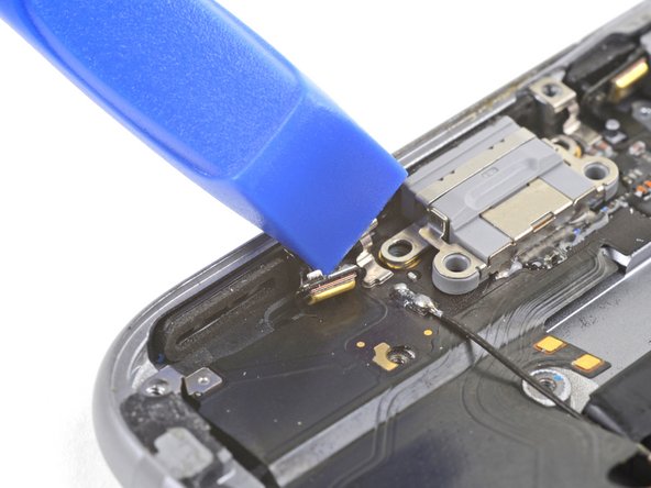

  29. iPhone 6s Lightning Connector Assembly Replacement: crwdns2935265:029crwdnd2935265:01crwdnd2935265:02crwdne2935265:0 iPhone 6s Lightning Connector Assembly Replacement: crwdns2935265:029crwdnd2935265:02crwdnd2935265:02crwdne2935265:0
    • If you are following this guide to replace the Lightning connector, you can choose to keep the antenna cable connected and skip this step and the next one. Be very careful not to strain the delicate antenna cable when you move the loudspeaker around.
    • Use the point of a spudger to lift and disconnect the antenna cable from its socket near the top of the logic board.
    The note here should read “you can choose to keep the antenna cable connected and skip this step and the next one” (steps 27 and 28). The way it reads now, “you can choose to keep the antenna cable connected and skip the next two steps”, makes it seem that you should skip steps 27, 28, and 29, which is clearly incorrect.
    Bom Tomdabil - crwdns2934203:0crwdne2934203:0
    Hi Bom,
    That’s a great suggestion! Thanks! I will update the step.
    Arthur Shi -
    Hi Daniel,
    This should be the Wi-Fi diversity antenna, which improves Wi-Fi performance.
    Arthur Shi -
    Ah alright, on mine I've got this black foam on on top of it, is it true that if I remove it will stop working?
    Daniel Gyabaah -
    It might! The foam acts as an electrical insulator. Keep it on the connector.
    Arthur Shi -

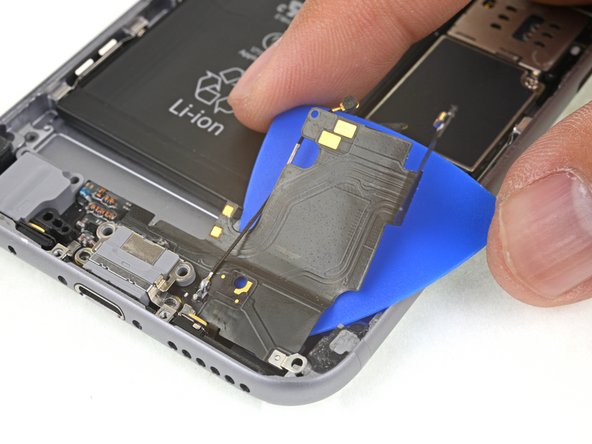

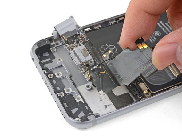

  30. iPhone 6s Lightning Connector Assembly Replacement: crwdns2935265:030crwdnd2935265:01crwdnd2935265:03crwdne2935265:0 iPhone 6s Lightning Connector Assembly Replacement: crwdns2935265:030crwdnd2935265:02crwdnd2935265:03crwdne2935265:0 iPhone 6s Lightning Connector Assembly Replacement: crwdns2935265:030crwdnd2935265:03crwdnd2935265:03crwdne2935265:0
    • Carefully lift the antenna cable and de-route it from the edge of the phone. Use the point of a spudger to help lift the cable to free it from the retaining clips.
    • If the cable does not have enough room to lift up, loosen this Phillips screw securing the logic board so that the board can give more wiggle room.
    • Be sure to re-tighten this screw during re-installation.
    • During re-installation, be sure to route the antenna cable underneath the logic board corner.
    • During re-installation, you can also re-insert the SIM card tray after re-routing the antenna cable.
    • If you feel any resistance, stop and make sure that the tray isn't snagging the antenna cable.
    Why would it be necessary to remove the antenna cable from the top for this repair? I did it whilst leaving it in.
    Edwin - crwdns2934203:0crwdne2934203:0
    The antenna cable is taped to the speaker module in an inaccessible location. While it is possible to pull the cable out of the tape binding, doing so may break the cable. We opted to remove the cable with the speaker as a workaround.
    Arthur Shi -
    is it necessary to somehow try to get the antenna back into the retaining clips? I can’t say I can even see where they are.
    Tawn - crwdns2934203:0crwdne2934203:0
    Hi Tonya,
    It is not necessary for the general operation of the phone. Keeping the antenna in the clips may help with grounding and keeps it in place so that you can easily insert/remove the SIM tray without snagging it. Wherever the antenna cable turns silver on the strand, there should be a corresponding clip underneath it.
    Arthur Shi -
    What if when taking the antenna out, it looks to have removed a tiny section of the black shielding? Do I need to replace the antenna?
    Martin - crwdns2934203:0crwdne2934203:0
    HI Martin,
    The antenna has specific areas where the shielding is intentionally missing. These areas snap into corresponding clips on the phone frame.
    Arthur Shi -
    It’s not where the clips are, it’s right where it goes under the motherboard, so I am worried it might short the motherboard.
    Martin -
    You are most likely fine. You can use some electrical tape on the cable to help prevent any accidental contact.
    Arthur Shi -
    Same here - I replaced the speaker without taking the antenna cable out (which would have had me break the cable for sure).
    Richard Guenther - crwdns2934203:0crwdne2934203:0
    I ended up snapping the antenna cable. What do I do now?
    Nolan Ferox - crwdns2934203:0crwdne2934203:0
    Is there a repair guide for the antenna cable for the 6s
    k s - crwdns2934203:0crwdne2934203:0

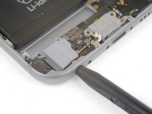

  32. iPhone 6s Lightning Connector Assembly Replacement: crwdns2935265:032crwdnd2935265:01crwdnd2935265:03crwdne2935265:0 iPhone 6s Lightning Connector Assembly Replacement: crwdns2935265:032crwdnd2935265:02crwdnd2935265:03crwdne2935265:0 iPhone 6s Lightning Connector Assembly Replacement: crwdns2935265:032crwdnd2935265:03crwdnd2935265:03crwdne2935265:0
    • Insert the flat end of a spudger between the long edge of the speaker module and the case wall.
    • Pry gently to loosen the speaker module.
    • Once the module is loose, lift and remove the speaker module from the phone.
    I could not completely remove the antenna cable (attached to the speaker) without removing other components. I just left the speaker and antenna cable dangling while I replaced the lightning connector.
    Tyler Clayton - crwdns2934203:0crwdne2934203:0

  35. iPhone 6s Lightning Connector Assembly Replacement: crwdns2935265:035crwdnd2935265:01crwdnd2935265:01crwdne2935265:0
    • Remove the plastic microphone bracket.

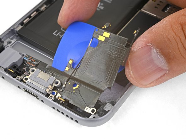

  37. iPhone 6s Lightning Connector Assembly Replacement: crwdns2935265:037crwdnd2935265:01crwdnd2935265:03crwdne2935265:0 iPhone 6s Lightning Connector Assembly Replacement: crwdns2935265:037crwdnd2935265:02crwdnd2935265:03crwdne2935265:0 iPhone 6s Lightning Connector Assembly Replacement: crwdns2935265:037crwdnd2935265:03crwdnd2935265:03crwdne2935265:0
    • Insert a plastic opening pick between the edge of the rear case and the Lightning connector flex cable.
    • Press the pick underneath the flex cable to break up the adhesive holding it in place.
  38. iPhone 6s Lightning Connector Assembly Replacement: crwdns2935265:038crwdnd2935265:01crwdnd2935265:03crwdne2935265:0 iPhone 6s Lightning Connector Assembly Replacement: crwdns2935265:038crwdnd2935265:02crwdnd2935265:03crwdne2935265:0 iPhone 6s Lightning Connector Assembly Replacement: crwdns2935265:038crwdnd2935265:03crwdnd2935265:03crwdne2935265:0
    • Insert the flat end of a spudger between the Lightning connector assembly and rear case to break up the remaining adhesive.
    The replacement lightning assembly has a factory plastic seal over the new adhesive—be sure to remove it before installing the new one.
    Alexander Anderson - crwdns2934203:0crwdne2934203:0
    The new ribbon cable needs to be smoothed down over the plastic piece at the bottom of the case, this lets it fit comfortably around that screw pillar.
    Alex.McHardy - crwdns2934203:0crwdne2934203:0
  39. iPhone 6s Lightning Connector Assembly Replacement: crwdns2935265:039crwdnd2935265:01crwdnd2935265:03crwdne2935265:0 iPhone 6s Lightning Connector Assembly Replacement: crwdns2935265:039crwdnd2935265:02crwdnd2935265:03crwdne2935265:0 iPhone 6s Lightning Connector Assembly Replacement: crwdns2935265:039crwdnd2935265:03crwdnd2935265:03crwdne2935265:0
    • Use an opening tool to separate the microphones from the bottom edge of the rear case.
    There’s a rubber “o-ring” type gasket that goes between the plastic tube of the 3.5 mm housing and the bottom of the iphone where it leads out. Carefully remove it and replace it on the new lighting connector/3.5 mm housing tube before installing.
  40. iPhone 6s Lightning Connector Assembly Replacement: crwdns2935265:040crwdnd2935265:01crwdnd2935265:02crwdne2935265:0 iPhone 6s Lightning Connector Assembly Replacement: crwdns2935265:040crwdnd2935265:02crwdnd2935265:02crwdne2935265:0
    • Insert the point of a spudger into the headphone jack and push to loosen the jack from the rear case.
    Theres a little buffer/washer thing on the back of this piece. Make sure to pull it off and re-use it on the replacement piece! The microphone won't work well without it.
    Jeff - crwdns2934203:0crwdne2934203:0
    On the replacement lightning assembly, this microphone has a factory plastic seal—remove it before putting on the buffer/washer thing mentioned above.
    During replacement assembly, insert a not powered lightning cable to align the module and guarantee the cable plugs in.
    Chris X. - crwdns2934203:0crwdne2934203:0
  41. iPhone 6s Lightning Connector Assembly Replacement: crwdns2935265:041crwdnd2935265:01crwdnd2935265:03crwdne2935265:0 iPhone 6s Lightning Connector Assembly Replacement: crwdns2935265:041crwdnd2935265:02crwdnd2935265:03crwdne2935265:0 iPhone 6s Lightning Connector Assembly Replacement: crwdns2935265:041crwdnd2935265:03crwdnd2935265:03crwdne2935265:0
    • Remove the Lightning connector assembly.
    • If your replacement part does not come with a gasket, use tweezers to remove it from the old part and transfer it onto the replacement part.
    • Before installing or replacing the Lightning connector assembly, use a plastic tool to scour any bits of adhesive residue from the rear case behind the cable.
    There is a small plastic spacer for the microphone that might come off with Lightning connector assembly. If it does you can simply pull it off and apply it to the new assembly.
    Huntster - crwdns2934203:0crwdne2934203:0
    The lightning connector does not have a gasket but instead some adhesive. You will need to replace this as it creates a seal between the connector and the frame.
    Bryan Solo - crwdns2934203:0crwdne2934203:0
    Putting it back together, I did Step 38 first, then put the yellow, green and blue screws from Step 32 to hold everything in the right place. This forced the microphone ribbon cables to flex, moving the microphones into exactly the right place - I could then remove the film to expose the adhesive on the microphones and be confident they were sticking to the right spot. I then put in the spacer as in Step 33 and then the remaining three screws from Step 32. Somebody might point out a problem with this - but it seemed to work out ok for me. I could still take the film off the main adhesive backing for the whole assembly and stick it down in the right place.
    Quintin Cutts - crwdns2934203:0crwdne2934203:0
    There is an additional part between the lightening connector charging port and the body of the iphone, which may come away with the old part. Don’t forget to remove this and put it in place before replacing with the new lightening connector assembly.
    James Sanders - crwdns2934203:0crwdne2934203:0
Compare your new replacement part to the original part. You may need to transfer remaining components or remove adhesive backings from the new part before installing.
