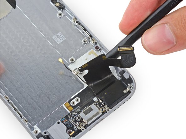

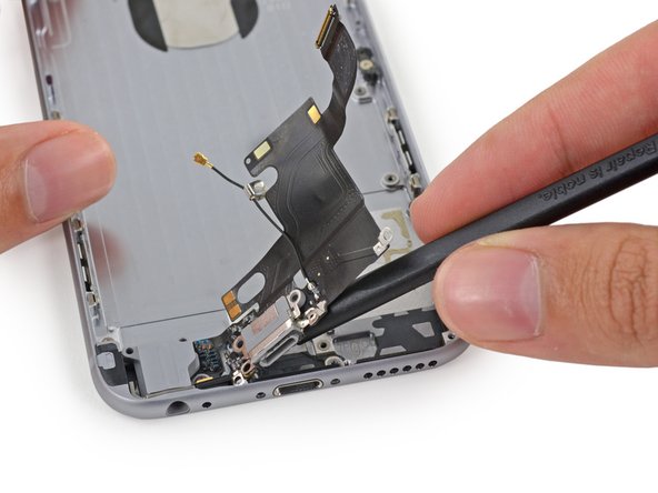

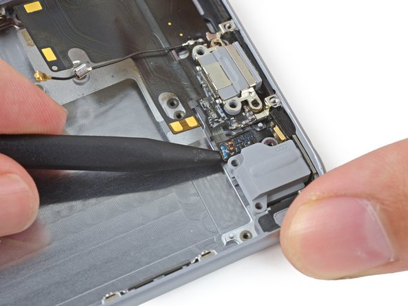

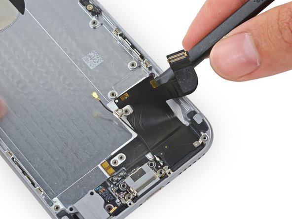

  21. iPhone 6 Rear Case Replacement, Logic Board: crwdns2935265:021crwdnd2935265:01crwdnd2935265:02crwdne2935265:0 iPhone 6 Rear Case Replacement, Logic Board: crwdns2935265:021crwdnd2935265:02crwdnd2935265:02crwdne2935265:0
    • Use the flat end of a spudger to disconnect the Lightning connector assembly cable and fold it out of the way of the speaker.

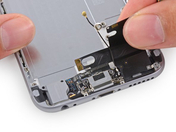

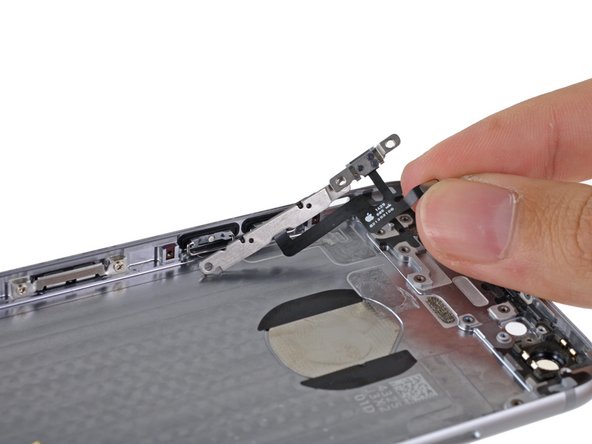

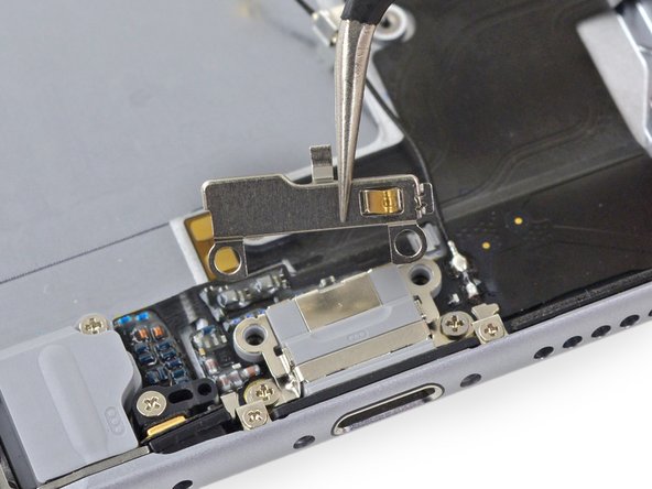

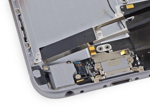

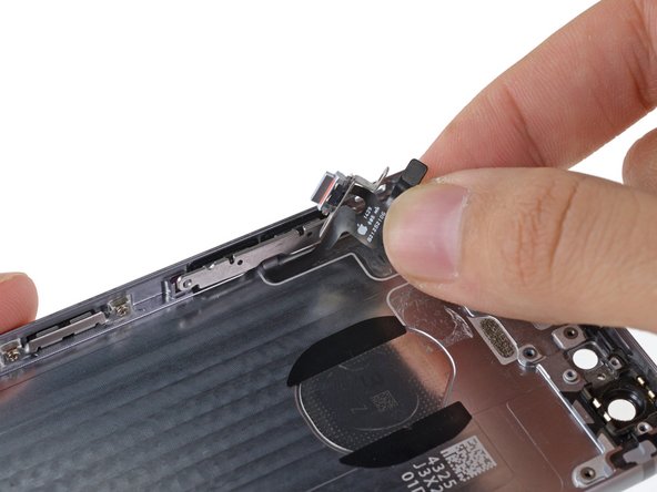

  38. iPhone 6 Rear Case Replacement, Power Button Cable Assembly: crwdns2935265:038crwdnd2935265:01crwdnd2935265:01crwdne2935265:0
    • Peel back the first battery adhesive tab from the bottom right edge of the battery.
    • Use your fingers or blunt tweezers, and be extra careful when working near the battery—puncturing a lithium-ion battery can release dangerous chemicals and cause a fire.
  39. iPhone 6 Rear Case Replacement: crwdns2935265:039crwdnd2935265:01crwdnd2935265:03crwdne2935265:0 iPhone 6 Rear Case Replacement: crwdns2935265:039crwdnd2935265:02crwdnd2935265:03crwdne2935265:0 iPhone 6 Rear Case Replacement: crwdns2935265:039crwdnd2935265:03crwdnd2935265:03crwdne2935265:0

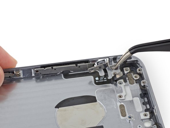

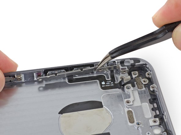

  58. iPhone 6 Rear Case Replacement: crwdns2935265:058crwdnd2935265:01crwdnd2935265:03crwdne2935265:0 iPhone 6 Rear Case Replacement: crwdns2935265:058crwdnd2935265:02crwdnd2935265:03crwdne2935265:0 iPhone 6 Rear Case Replacement: crwdns2935265:058crwdnd2935265:03crwdnd2935265:03crwdne2935265:0
    • Pull the hold switch and volume control button brackets away from the rear case to allow access to the button covers.
  59. iPhone 6 Rear Case Replacement: crwdns2935265:059crwdnd2935265:01crwdnd2935265:03crwdne2935265:0 iPhone 6 Rear Case Replacement: crwdns2935265:059crwdnd2935265:02crwdnd2935265:03crwdne2935265:0 iPhone 6 Rear Case Replacement: crwdns2935265:059crwdnd2935265:03crwdnd2935265:03crwdne2935265:0
    • Begin to peel the volume control button cable up from the rear case starting from the connector end.
    • Be gentle when peeling the thin portions of the cable up from the case.
    • Remove the volume control button cable from the rear case.

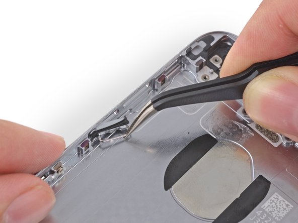

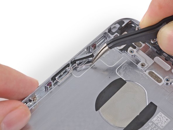

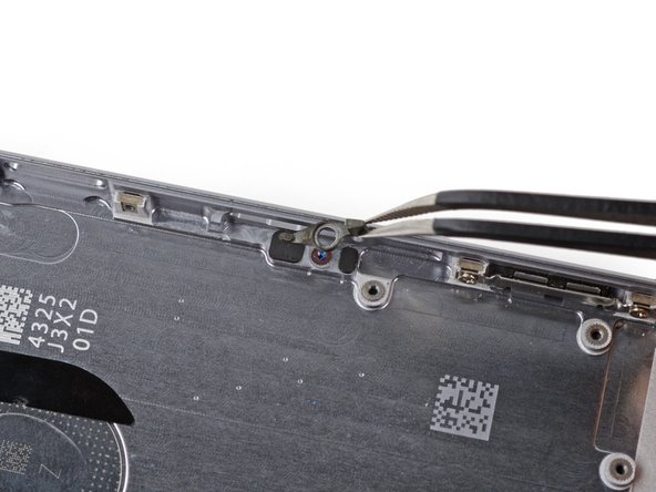

  60. iPhone 6 Rear Case Replacement: crwdns2935265:060crwdnd2935265:01crwdnd2935265:03crwdne2935265:0 iPhone 6 Rear Case Replacement: crwdns2935265:060crwdnd2935265:02crwdnd2935265:03crwdne2935265:0 iPhone 6 Rear Case Replacement: crwdns2935265:060crwdnd2935265:03crwdnd2935265:03crwdne2935265:0
    • Pull the volume control buttons by the metal bar to remove them from the rear case.
    • The buttons are held to the case with an adhesive gasket, pull carefully to prevent ripping the membrane.

    • Remove the two 3.1 mm Phillips #00 screws securing the Lightning port retaining bracket.
  67. iPhone 6 Rear Case Replacement: crwdns2935265:067crwdnd2935265:01crwdnd2935265:02crwdne2935265:0 iPhone 6 Rear Case Replacement: crwdns2935265:067crwdnd2935265:02crwdnd2935265:02crwdne2935265:0
    • Remove the Lightning port retaining bracket.
  68. iPhone 6 Rear Case Replacement: crwdns2935265:068crwdnd2935265:01crwdnd2935265:01crwdne2935265:0

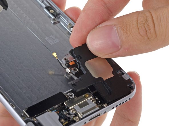

  71. iPhone 6 Rear Case Replacement: crwdns2935265:071crwdnd2935265:01crwdnd2935265:03crwdne2935265:0 iPhone 6 Rear Case Replacement: crwdns2935265:071crwdnd2935265:02crwdnd2935265:03crwdne2935265:0 iPhone 6 Rear Case Replacement: crwdns2935265:071crwdnd2935265:03crwdnd2935265:03crwdne2935265:0
    • Use the flat end of a spudger to begin peeling the Lightning connector cable assembly up from the rear case.
  72. iPhone 6 Rear Case Replacement: crwdns2935265:072crwdnd2935265:01crwdnd2935265:02crwdne2935265:0 iPhone 6 Rear Case Replacement: crwdns2935265:072crwdnd2935265:02crwdnd2935265:02crwdne2935265:0
    • Carefully pull the Lightning connector cable assembly up slightly to free the it from the vibrator and speaker screw posts.
  73. iPhone 6 Rear Case Replacement: crwdns2935265:073crwdnd2935265:01crwdnd2935265:02crwdne2935265:0 iPhone 6 Rear Case Replacement: crwdns2935265:073crwdnd2935265:02crwdnd2935265:02crwdne2935265:0

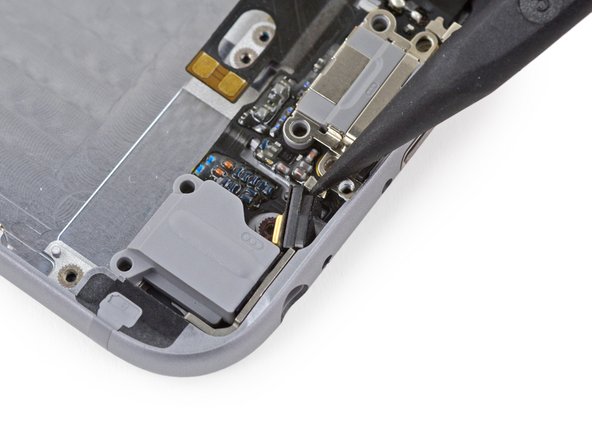

    • Use the flat end of a spudger to lift under the Lightning connector portion of the cable assembly to free more adhesive.
  74. iPhone 6 Rear Case Replacement: crwdns2935265:074crwdnd2935265:01crwdnd2935265:02crwdne2935265:0 iPhone 6 Rear Case Replacement: crwdns2935265:074crwdnd2935265:02crwdnd2935265:02crwdne2935265:0

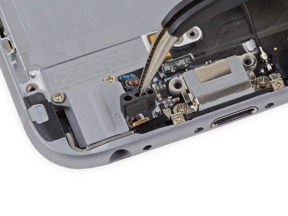

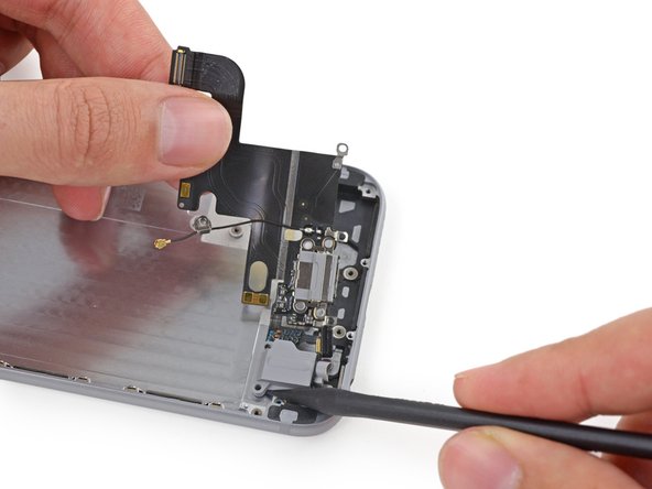

    • Use the point of a spudger to push the microphone portion of the Lightning cable assembly out of its recess in the rear case.
  75. iPhone 6 Rear Case Replacement: crwdns2935265:075crwdnd2935265:01crwdnd2935265:02crwdne2935265:0 iPhone 6 Rear Case Replacement: crwdns2935265:075crwdnd2935265:02crwdnd2935265:02crwdne2935265:0

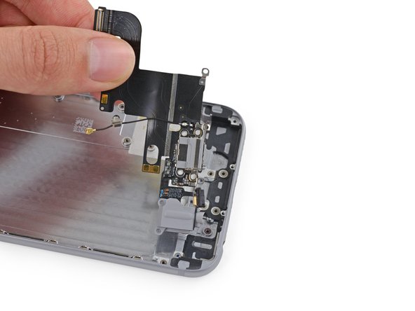

    • Gently run the point of a spudger under the cable assembly between the Lightning connector and the headphone jack to free it from the last of the adhesive.
  76. iPhone 6 Rear Case Replacement: crwdns2935265:076crwdnd2935265:01crwdnd2935265:03crwdne2935265:0 iPhone 6 Rear Case Replacement: crwdns2935265:076crwdnd2935265:02crwdnd2935265:03crwdne2935265:0 iPhone 6 Rear Case Replacement: crwdns2935265:076crwdnd2935265:03crwdnd2935265:03crwdne2935265:0
    • Use the tip of a spudger to help guide the headphone jack out of its recess in the rear case.
    • Remove the Lightning connector cable assembly from the iPhone.
