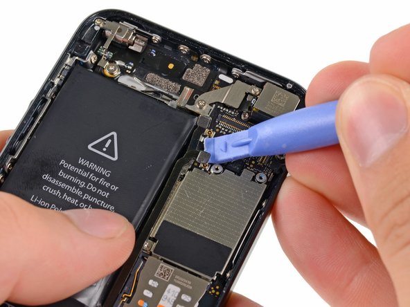

  6. iPhone 5 Interconnect Cables Replacement, Manual Opening Procedure: crwdns2935265:06crwdnd2935265:01crwdnd2935265:01crwdne2935265:0
    • Press a suction cup onto the screen, just above the home button.
    • Be sure the cup is completely on the screen to get a tight seal.
    • If you're opening an iPhone with cracked glass, neatly lay a couple strips of packing tape across the front and squeeze out as many bubbles as you can. This will give the suction cup a surface to grab, and minimize the spread of broken glass.
  7. iPhone 5 Interconnect Cables Replacement, Start lifting the front panel assembly: crwdns2935265:07crwdnd2935265:01crwdnd2935265:01crwdne2935265:0
    • Make sure the suction cup is firmly attached to the front panel assembly.
    • While holding the iPhone down with one hand, pull up on the suction cup to slightly separate the front panel assembly from the rear case.
    • Take your time and apply firm, constant force. The screen is a much tighter fit than most devices.
    • With a plastic opening tool, begin to gently pry the rear case down, away from the screen, while you pull up with the suction cup.
    • There are several clips attaching the front panel assembly to the rear case, so you may need to use a combination of the suction cup and plastic opening tool to free the front panel assembly.

    Suction cup didn't work for me. I tried for half hour with my nerd biceps. In the end, I inserted an xacto blade below the home button to create a gap big enough for me to put in a guitar pick and finally able to pry it open. In the process I scratched the frame so you have to be very careful if you decide to take this approach.

    While holding down on the lower sides of the iPhone, I found inserting the plastic separator just to the right of the audio jack while gently applying pressure down and back from the edge popped the bottom of the display assembly up. Keep in mind to do this while pulling back on the suction cup ring, like the guide says constant, but gentle force at the same time. Another note is to have the suction cup ring vertical to align with the length of the display, that made the process much easier.

    This should be in the guide. The front panel is actually recessed a bit here making it much easier to get a tool in at this point. No way I would have opened it without this tip. Thanks!

    I can confirm, the Garmin sucker cup worked like a charm. Within 5 seconds it popped open.

    Once there is a gap between the screen and the frame, insert the plastic opening tools and move it around the screen. But don't use it for top area (near to power button) as there is a location for flexible ribbon cable.
    Once the bottom part is free, the screen will pop out easily.

    The suction cup will hold if you put a piece of tape over the cracked screen.

  12. iPhone 5 Interconnect Cables Replacement, Disconnecting the battery connector: crwdns2935265:012crwdnd2935265:01crwdnd2935265:01crwdne2935265:0
    • Use a plastic opening tool to gently pry the battery connector up from its socket on the logic board.
    • Be careful not to dislodge the small surface-mounted components surrounding the socket.
    • Be very careful to only pry up on the battery connector itself and not the socket on the logic board. If you pry up on the logic board socket or the board itself, you may destroy the socket or damage nearby components on the board.
    • Be very careful to only pry up on the battery connector and not the socket on the logic board. If you pry up on the logic board socket, you may break the connector entirely.
