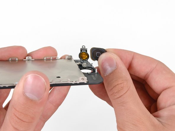

    1. iPhone 5 Home Button Replacement, Home Button: crwdns2935265:017crwdnd2935265:01crwdnd2935265:01crwdne2935265:0
      • Remove the two 1.3 mm Phillips screws securing the home button bracket to the display assembly.
    2. iPhone 5 Home Button Replacement: crwdns2935265:018crwdnd2935265:01crwdnd2935265:02crwdne2935265:0 iPhone 5 Home Button Replacement: crwdns2935265:018crwdnd2935265:02crwdnd2935265:02crwdne2935265:0
      • Gently flip the home button bracket to the right.
    3. iPhone 5 Home Button Replacement: crwdns2935265:019crwdnd2935265:01crwdnd2935265:01crwdne2935265:0
      • Gently press up on the center of the home button from the display side of the display assembly, to loosen the adhesive securing it to the assembly.
    4. iPhone 5 Home Button Replacement: crwdns2935265:020crwdnd2935265:01crwdnd2935265:03crwdne2935265:0 iPhone 5 Home Button Replacement: crwdns2935265:020crwdnd2935265:02crwdnd2935265:03crwdne2935265:0 iPhone 5 Home Button Replacement: crwdns2935265:020crwdnd2935265:03crwdnd2935265:03crwdne2935265:0
      • Once the home button has started to separate from the display assembly, use the tip of a spudger to completely lift the button from the adhesive securing it.
      • Be careful not to tear the rubber gasket surrounding the home button.
      • Remove the home button from the display assembly.
