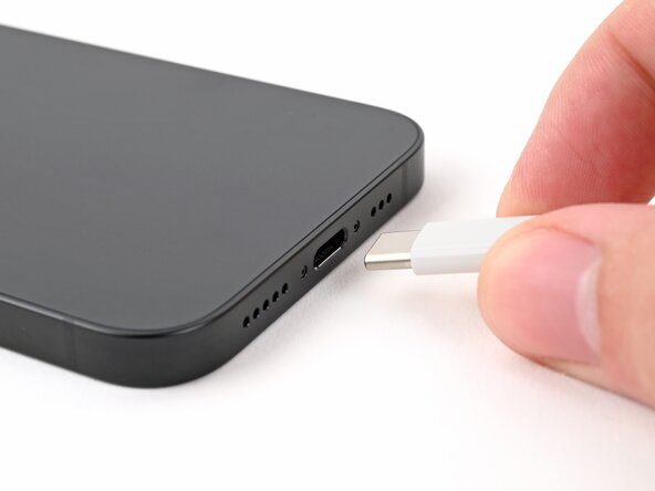

    • Allow your phone's battery to drain below 25%, as a charged lithium-ion battery is a potential safety hazard.
    • Unplug any cables from your phone.
    • Hold the power button and either volume button, then slide to power off your phone.

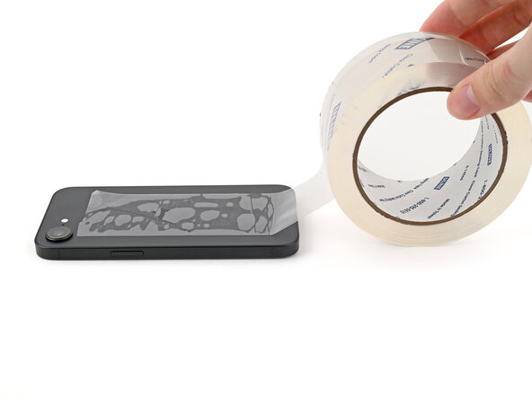

  2. iPhone 16e Taptic Engine Replacement, Tape over any cracks: crwdns2935265:02crwdnd2935265:01crwdnd2935265:02crwdne2935265:0 iPhone 16e Taptic Engine Replacement, Tape over any cracks: crwdns2935265:02crwdnd2935265:02crwdnd2935265:02crwdne2935265:0
    • If your screen or back glass is badly cracked, lay overlapping strips of packing tape over the glass to protect yourself and make disassembly easier.
    • Make sure there's a smooth area near the bottom edge that's big enough for a suction cup to stick to.

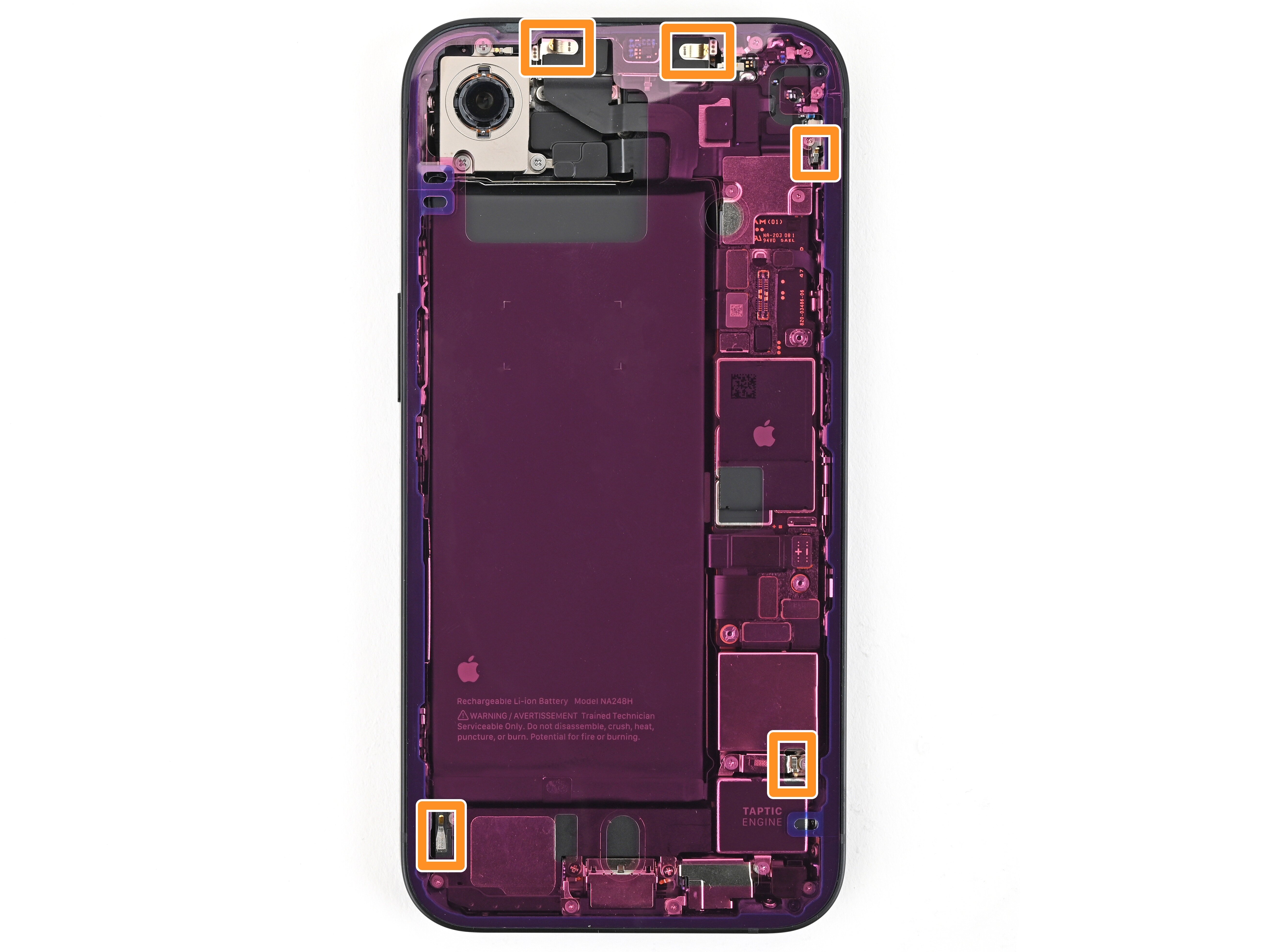

  7. iPhone 16e Taptic Engine Replacement, Back glass information: crwdns2935265:07crwdnd2935265:01crwdnd2935265:01crwdne2935265:0
    • As you slice the adhesive securing the back glass in the following steps, don't insert your pick deeper than 3 mm to avoid damaging the following areas:
    • A delicate cable connecting the back glass to the phone, next to the volume up button.
    • Multiple spring contacts around the perimeter of the phone.

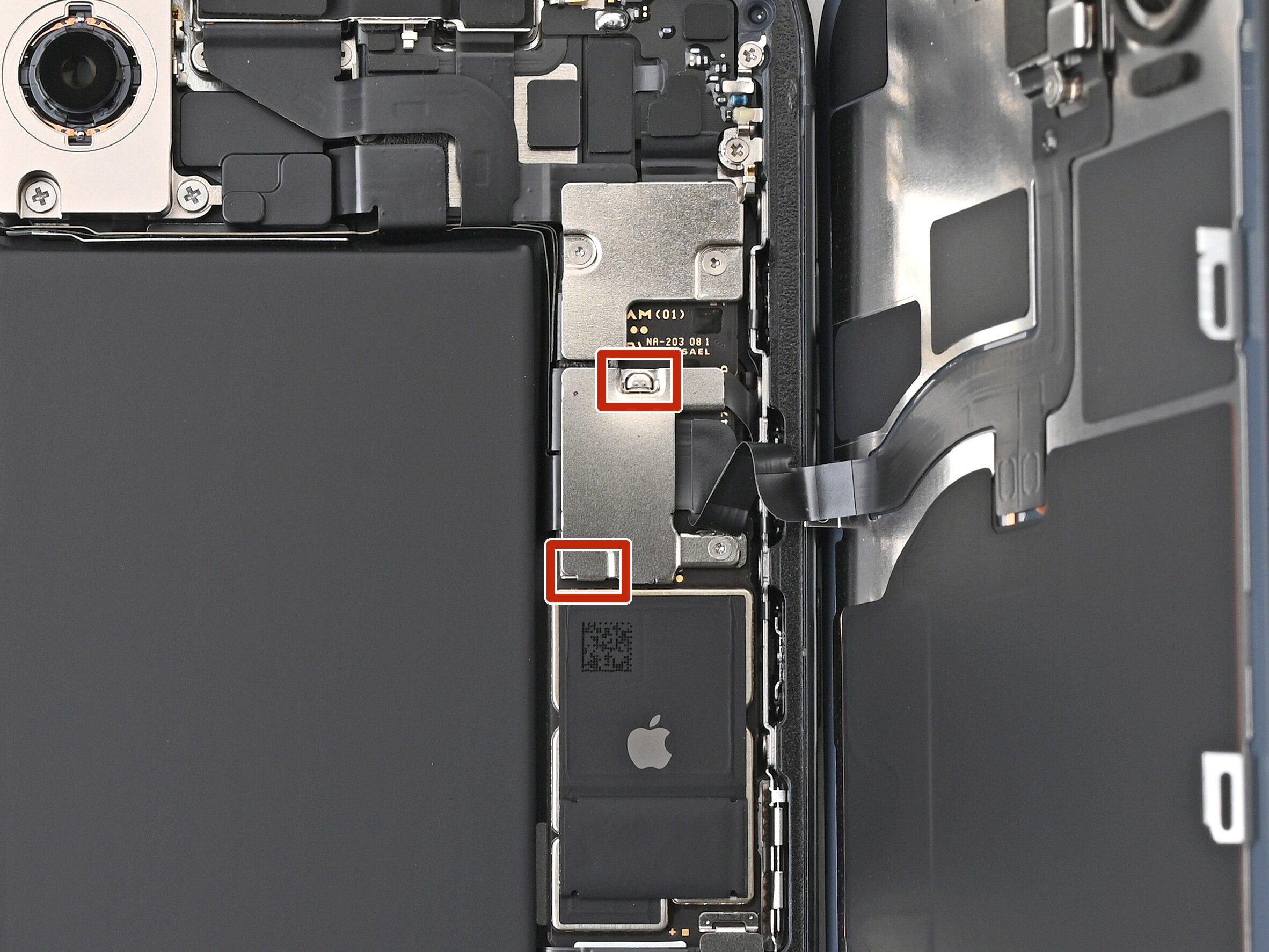

  20. iPhone 16e Taptic Engine Replacement, Remove the middle connector cover: crwdns2935265:020crwdnd2935265:01crwdnd2935265:03crwdne2935265:0 iPhone 16e Taptic Engine Replacement, Remove the middle connector cover: crwdns2935265:020crwdnd2935265:02crwdnd2935265:03crwdne2935265:0 iPhone 16e Taptic Engine Replacement, Remove the middle connector cover: crwdns2935265:020crwdnd2935265:03crwdnd2935265:03crwdne2935265:0
    • The middle connector cover is slotted into two metal clips on the top and bottom.
    • Use the point of a spudger to push the middle connector cover towards the bottom of the phone to release its clips.
    • Use tweezers or your fingers to remove the cover.
