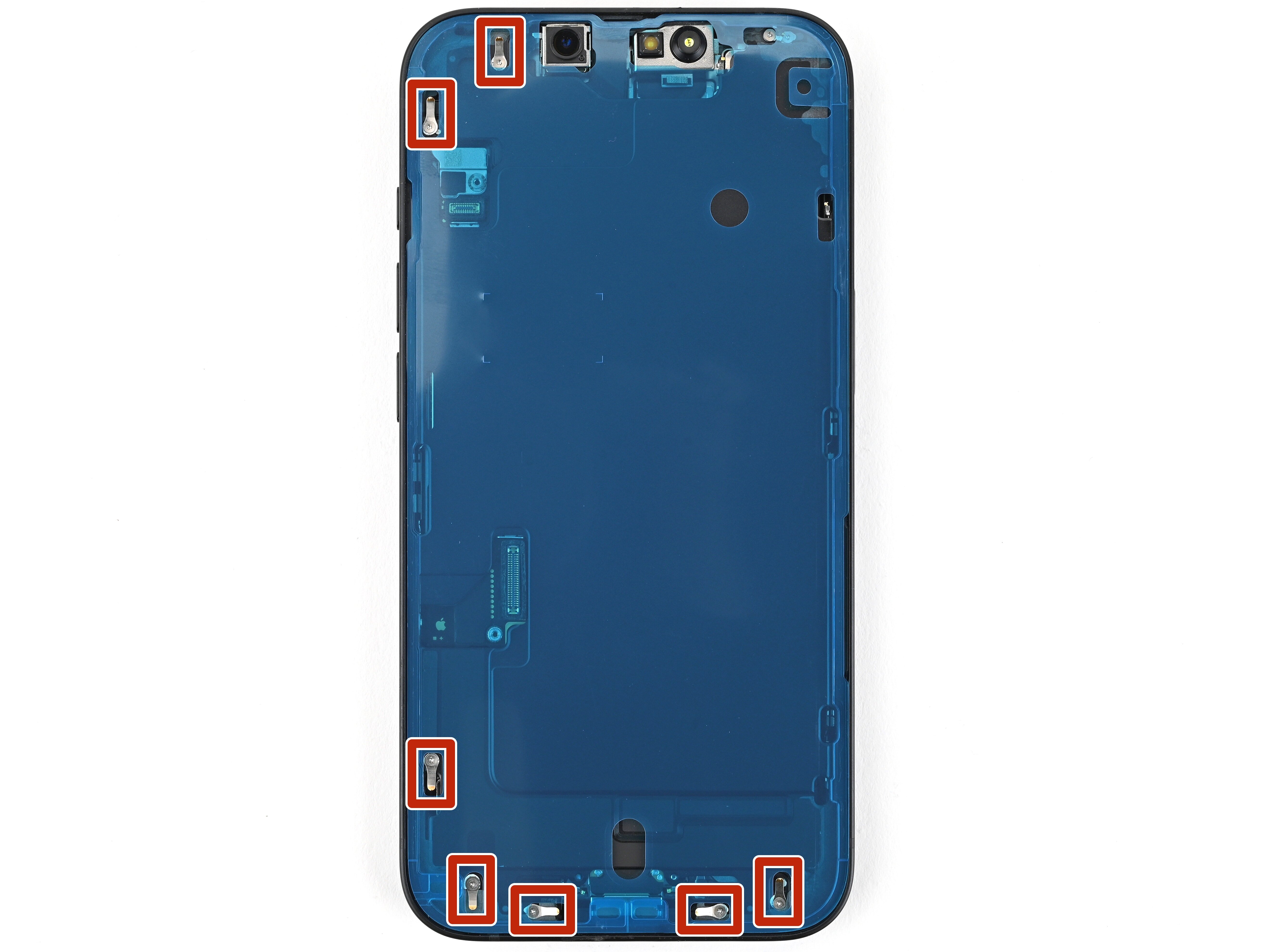

  22. iPhone 16e Screen Replacement, Remove the old adhesive: crwdns2935265:022crwdnd2935265:01crwdnd2935265:02crwdne2935265:0 iPhone 16e Screen Replacement, Remove the old adhesive: crwdns2935265:022crwdnd2935265:02crwdnd2935265:02crwdne2935265:0
    • Use tweezers to remove the adhesive around the perimeter of the frame.
    • You may need to bunch up the adhesive with the point of a spudger before gripping it with tweezers.
    • Use a coffee filter or a lint‑free cloth and high‑concentration isopropyl alcohol (>%90) to clean off any adhesive residue.
  23. iPhone 16e Screen Replacement, Orient the adhesive: crwdns2935265:023crwdnd2935265:01crwdnd2935265:02crwdne2935265:0 iPhone 16e Screen Replacement, Orient the adhesive: crwdns2935265:023crwdnd2935265:02crwdnd2935265:02crwdne2935265:0
    • Lay the adhesive on top of the phone and use features like cutouts for spring contacts and the front‑facing camera to make sure the adhesive is oriented correctly.
    • Your adhesive may look slightly different.
  24. iPhone 16e Screen Replacement, Apply the adhesive: crwdns2935265:024crwdnd2935265:01crwdnd2935265:03crwdne2935265:0 iPhone 16e Screen Replacement, Apply the adhesive: crwdns2935265:024crwdnd2935265:02crwdnd2935265:03crwdne2935265:0 iPhone 16e Screen Replacement, Apply the adhesive: crwdns2935265:024crwdnd2935265:03crwdnd2935265:03crwdne2935265:0
    • Once the adhesive is pressed into place, you can't reposition it—you'll have to remove it and start over with new adhesive.
    • Use the pull tab to begin peeling the back liner off the adhesive starting from the bottom, but don't remove the liner all the way.
    • Hold the blue liner out of the way and align the adhesive with the bottom edge of the iPhone.
    • Lay the bottom edge of the adhesive into its recess in the frame, making sure the iPhone's spring contacts are aligned with their cutouts in the liner.
  25. iPhone 16e Screen Replacement: crwdns2935265:025crwdnd2935265:01crwdnd2935265:03crwdne2935265:0 iPhone 16e Screen Replacement: crwdns2935265:025crwdnd2935265:02crwdnd2935265:03crwdne2935265:0 iPhone 16e Screen Replacement: crwdns2935265:025crwdnd2935265:03crwdnd2935265:03crwdne2935265:0
    • Continue peeling the back liner off the adhesive while pressing the adhesive into place along the edges of the iPhone's frame.
    • If you correctly aligned the lower edge of the adhesive, the side and top edges will fall perfectly into place. If the adhesive is misaligned, remove it and start over with new adhesive.
    • If your adhesive is misaligned and you don't have another set handy, it's okay to temporarily put your iPhone back together and use it normally without any adhesive, but keep in mind that your iPhone's water resistance will be compromised until you install new adhesive.
