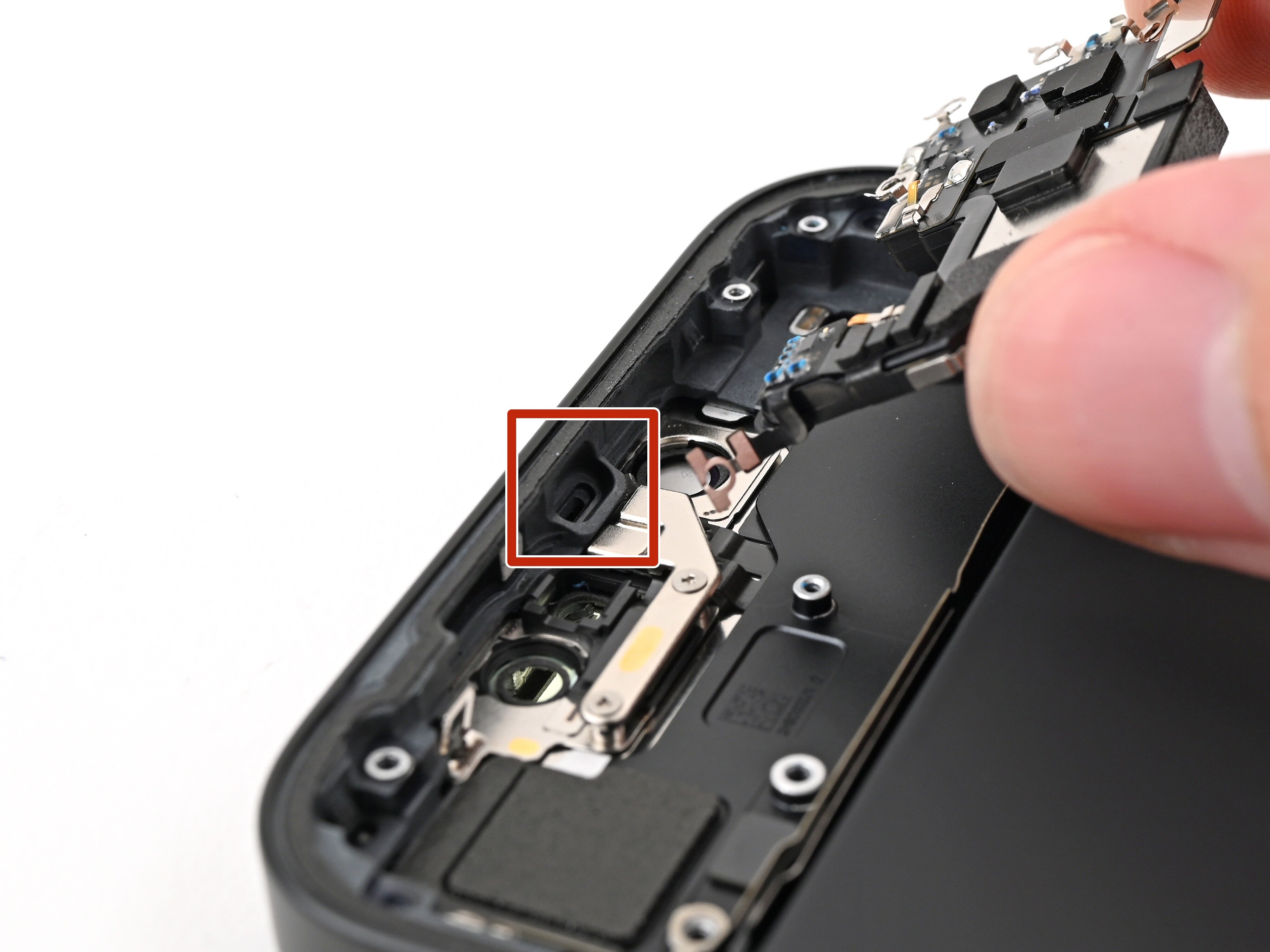

  29. iPhone 16e Earpiece Speaker Replacement, Remove the earpiece speaker: crwdns2935265:029crwdnd2935265:01crwdnd2935265:03crwdne2935265:0 iPhone 16e Earpiece Speaker Replacement, Remove the earpiece speaker: crwdns2935265:029crwdnd2935265:02crwdnd2935265:03crwdne2935265:0 iPhone 16e Earpiece Speaker Replacement, Remove the earpiece speaker: crwdns2935265:029crwdnd2935265:03crwdnd2935265:03crwdne2935265:0
    • Insert the flat end of a spudger into the front camera recess between the earpiece speaker and the frame.
    • Pry up the earpiece speaker and remove it.

  31. iPhone 16e Earpiece Speaker Replacement, Place the earpiece speaker: crwdns2935265:031crwdnd2935265:01crwdnd2935265:02crwdne2935265:0 iPhone 16e Earpiece Speaker Replacement, Place the earpiece speaker: crwdns2935265:031crwdnd2935265:02crwdnd2935265:02crwdne2935265:0
    • Align the top left corner of the earpiece speaker with the sound channel.
  32. iPhone 16e Earpiece Speaker Replacement: crwdns2935265:032crwdnd2935265:01crwdnd2935265:02crwdne2935265:0 iPhone 16e Earpiece Speaker Replacement: crwdns2935265:032crwdnd2935265:02crwdnd2935265:02crwdne2935265:0
    • Press the earpiece speaker onto the frame so it lies flat.
    • Make sure the cable along the top of the battery doesn't fold under earpiece speaker while pressing it down.
