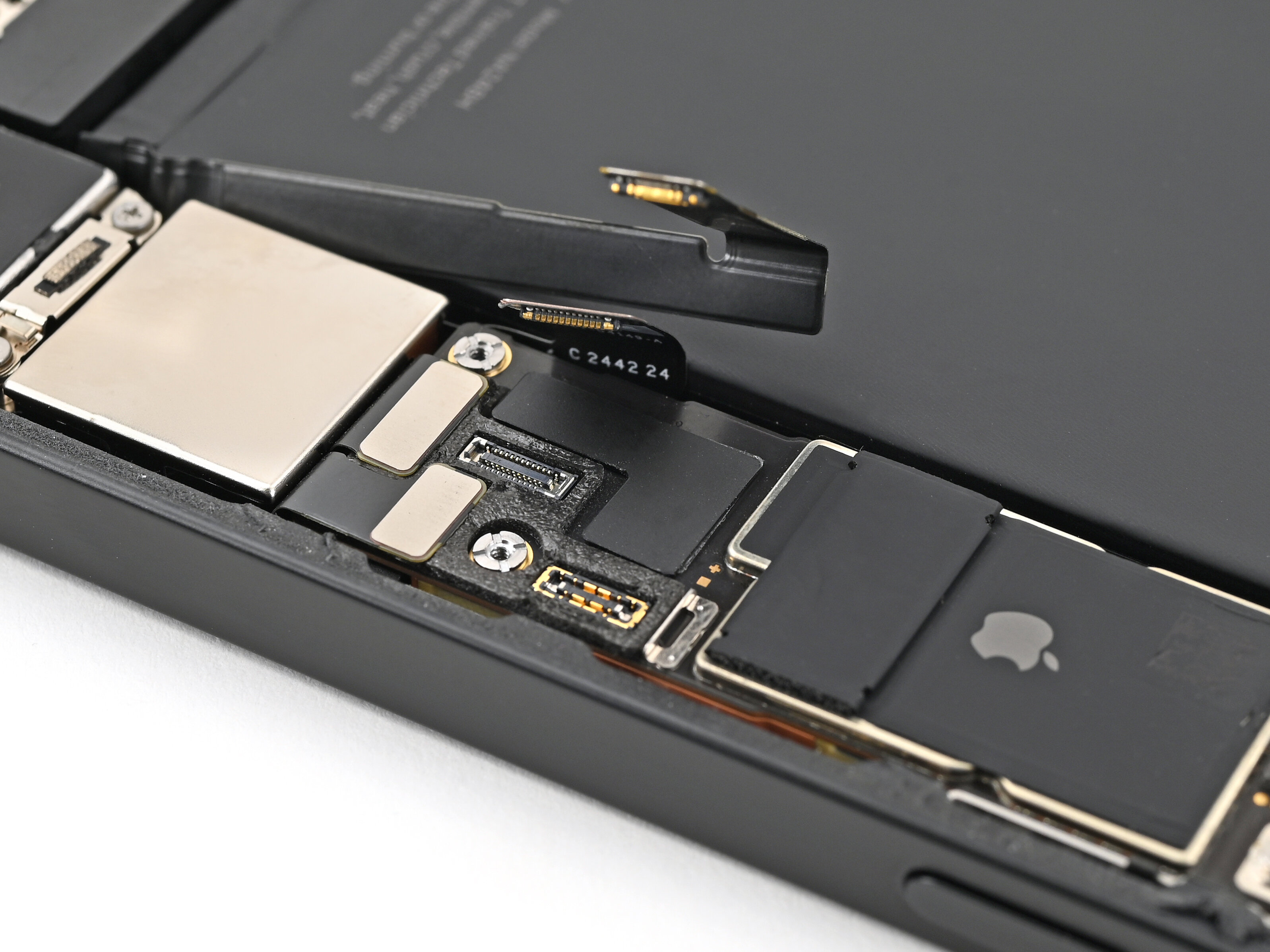

  18. iPhone 16e Battery Replacement, Disconnect the battery: crwdns2935265:018crwdnd2935265:01crwdnd2935265:02crwdne2935265:0 iPhone 16e Battery Replacement, Disconnect the battery: crwdns2935265:018crwdnd2935265:02crwdnd2935265:02crwdne2935265:0
    • Use the point of a spudger to pry up and disconnect the battery press connector.

  23. iPhone 16e Battery Replacement, Peel up the battery cable adhesive: crwdns2935265:023crwdnd2935265:01crwdnd2935265:02crwdne2935265:0 iPhone 16e Battery Replacement, Peel up the battery cable adhesive: crwdns2935265:023crwdnd2935265:02crwdnd2935265:02crwdne2935265:0
    • Slide an opening pick under the battery cable to separate the adhesive securing it to the logic board.
    • There's a pad under the battery cable that you can accidentally slide the pick under. If you do, press the pad back into place and slide the opening pick between the pad and the cable.

  43. iPhone 16e Battery Replacement, Connect the press connectors: crwdns2935265:043crwdnd2935265:01crwdnd2935265:03crwdne2935265:0 iPhone 16e Battery Replacement, Connect the press connectors: crwdns2935265:043crwdnd2935265:02crwdnd2935265:03crwdne2935265:0 iPhone 16e Battery Replacement, Connect the press connectors: crwdns2935265:043crwdnd2935265:03crwdnd2935265:03crwdne2935265:0
    • Prop up the back glass along the right edge of your iPhone, using a box or similar sturdy object to support the glass.
    • Use the flat end of a spudger or your finger to connect the charging coil press connector, then the battery press connector.
