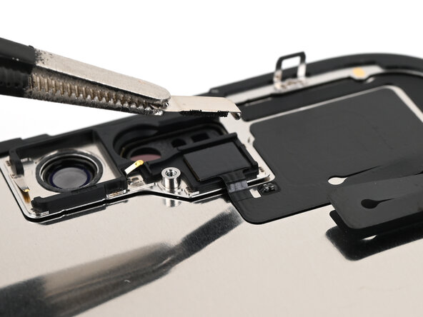

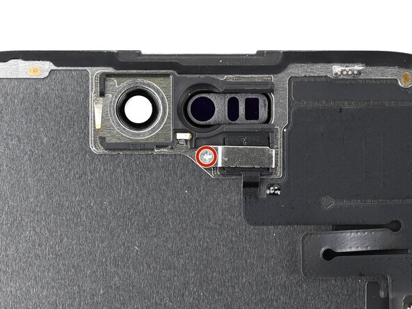

  20. iPhone 16 Screen Replacement, Remove the ambient light sensor bracket: crwdns2935265:020crwdnd2935265:01crwdnd2935265:03crwdne2935265:0 iPhone 16 Screen Replacement, Remove the ambient light sensor bracket: crwdns2935265:020crwdnd2935265:02crwdnd2935265:03crwdne2935265:0 iPhone 16 Screen Replacement, Remove the ambient light sensor bracket: crwdns2935265:020crwdnd2935265:03crwdnd2935265:03crwdne2935265:0
    • Use a Phillips screwdriver to remove the 1.3 mm‑long screw securing the ambient light sensor bracket.
    • Use a pair of tweezers or your fingers to lift and remove the ambient light sensor bracket.

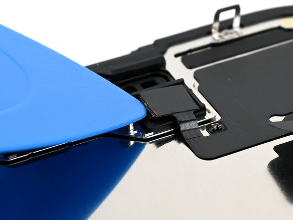

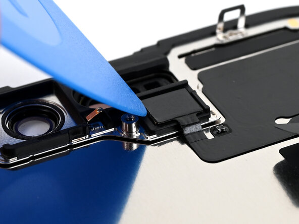

  21. iPhone 16 Screen Replacement, Pry up the ambient light sensor: crwdns2935265:021crwdnd2935265:01crwdnd2935265:03crwdne2935265:0 iPhone 16 Screen Replacement, Pry up the ambient light sensor: crwdns2935265:021crwdnd2935265:02crwdnd2935265:03crwdne2935265:0 iPhone 16 Screen Replacement, Pry up the ambient light sensor: crwdns2935265:021crwdnd2935265:03crwdnd2935265:03crwdne2935265:0
    • Use a hair dryer, heat gun, or heated iOpener to soften the adhesive under the ambient light sensor and ambient light sensor cable.
    • Use an opening pick to pry up the ambient light sensor.

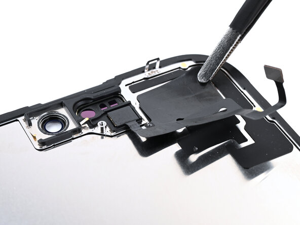

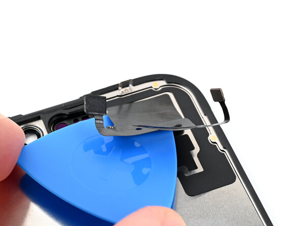

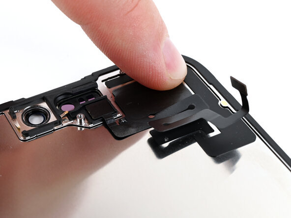

  22. iPhone 16 Screen Replacement, Reposition the ambient light sensor cable: crwdns2935265:022crwdnd2935265:01crwdnd2935265:02crwdne2935265:0 iPhone 16 Screen Replacement, Reposition the ambient light sensor cable: crwdns2935265:022crwdnd2935265:02crwdnd2935265:02crwdne2935265:0
    • Use your finger to push the ambient light sensor away from its recess.
  23. iPhone 16 Screen Replacement, Peel up the ambient light sensor cable: crwdns2935265:023crwdnd2935265:01crwdnd2935265:02crwdne2935265:0 iPhone 16 Screen Replacement, Peel up the ambient light sensor cable: crwdns2935265:023crwdnd2935265:02crwdnd2935265:02crwdne2935265:0
    • Gently slide an opening pick under the ambient light sensor cable, starting near the sensor and moving towards to the opposite corner.
    • If the adhesive doesn't peel up easily, apply more heat.

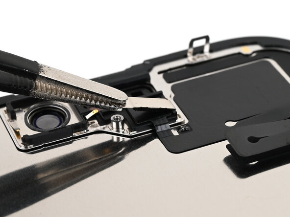

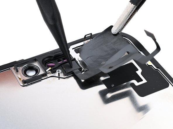

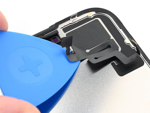

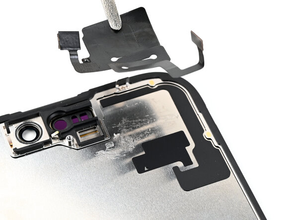

  24. iPhone 16 Screen Replacement, Remove the ambient light sensor: crwdns2935265:024crwdnd2935265:01crwdnd2935265:03crwdne2935265:0 iPhone 16 Screen Replacement, Remove the ambient light sensor: crwdns2935265:024crwdnd2935265:02crwdnd2935265:03crwdne2935265:0 iPhone 16 Screen Replacement, Remove the ambient light sensor: crwdns2935265:024crwdnd2935265:03crwdnd2935265:03crwdne2935265:0
    • Continue slowly sliding the opening pick under the ambient light sensor cable until the cable is free from the screen.
    • Use a pair of tweezers to lift the ambient light sensor off of the screen.

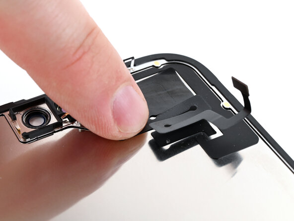

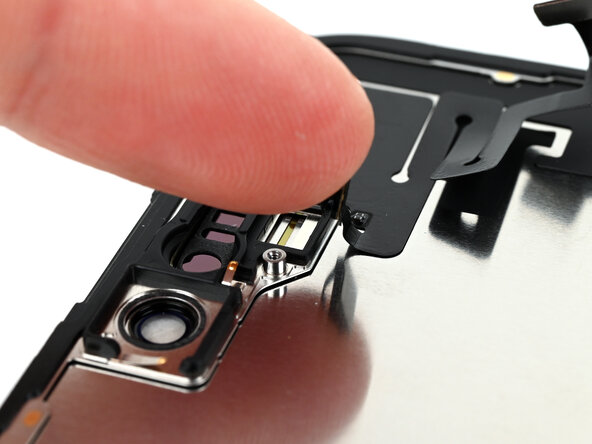

  27. iPhone 16 Screen Replacement, Press the ambient light sensor: crwdns2935265:027crwdnd2935265:01crwdnd2935265:03crwdne2935265:0 iPhone 16 Screen Replacement, Press the ambient light sensor: crwdns2935265:027crwdnd2935265:02crwdnd2935265:03crwdne2935265:0 iPhone 16 Screen Replacement, Press the ambient light sensor: crwdns2935265:027crwdnd2935265:03crwdnd2935265:03crwdne2935265:0
    • Use your finger to press down the ambient light sensor cable.
  28. iPhone 16 Screen Replacement, Install the ambient light sensor bracket: crwdns2935265:028crwdnd2935265:01crwdnd2935265:03crwdne2935265:0 iPhone 16 Screen Replacement, Install the ambient light sensor bracket: crwdns2935265:028crwdnd2935265:02crwdnd2935265:03crwdne2935265:0 iPhone 16 Screen Replacement, Install the ambient light sensor bracket: crwdns2935265:028crwdnd2935265:03crwdnd2935265:03crwdne2935265:0
    • Use tweezers or your fingers to place the ambient light sensor bracket over the back of the sensor.
    • Use a Phillips screwdriver to install the 1.3 mm‑long screw securing the ambient light sensor bracket.

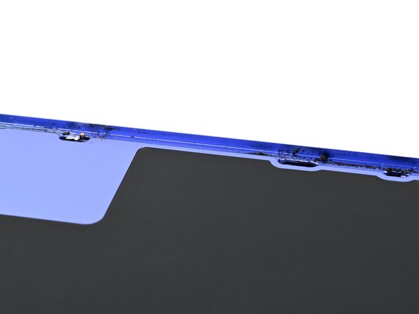

  29. iPhone 16 Screen Replacement, Remove the screen adhesive: crwdns2935265:029crwdnd2935265:01crwdnd2935265:03crwdne2935265:0 iPhone 16 Screen Replacement, Remove the screen adhesive: crwdns2935265:029crwdnd2935265:02crwdnd2935265:03crwdne2935265:0 iPhone 16 Screen Replacement, Remove the screen adhesive: crwdns2935265:029crwdnd2935265:03crwdnd2935265:03crwdne2935265:0
    • Be careful not to damage any of the spring contacts as you clean the frame.
    • This is a good point to test your repair before sealing up your phone. Connect the screen, power on your phone, and make sure it works as expected. Power it back down, disconnect the battery and back glass, and continue reassembly.
    • The adhesive remaining on your phone is difficult to remove and leaves residue. If you have trouble removing the adhesive, apply some heat using a hair dryer or heat gun.
    • Use a spudger to push the screen adhesive up until you can grab it with a pair of tweezers.
    • Use a pair of tweezers to remove the adhesive around the entire perimeter of the iPhone.

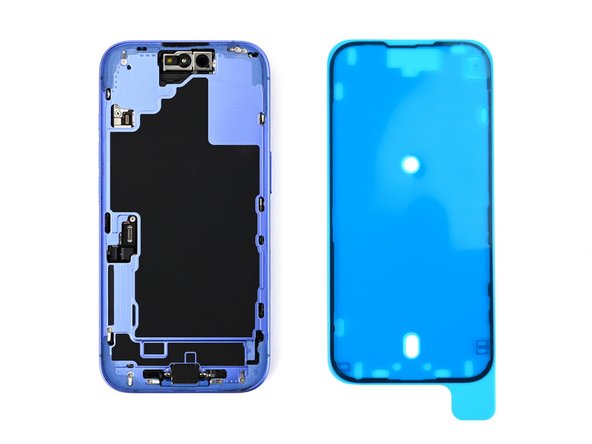

  31. iPhone 16 Screen Replacement, Orient the adhesive: crwdns2935265:031crwdnd2935265:01crwdnd2935265:02crwdne2935265:0 iPhone 16 Screen Replacement, Orient the adhesive: crwdns2935265:031crwdnd2935265:02crwdnd2935265:02crwdne2935265:0
    • Lay the adhesive next to the phone and use features like cutouts for spring contacts and the front‑facing camera to make sure the adhesive is oriented correctly.
    • Your adhesive may look slightly different.

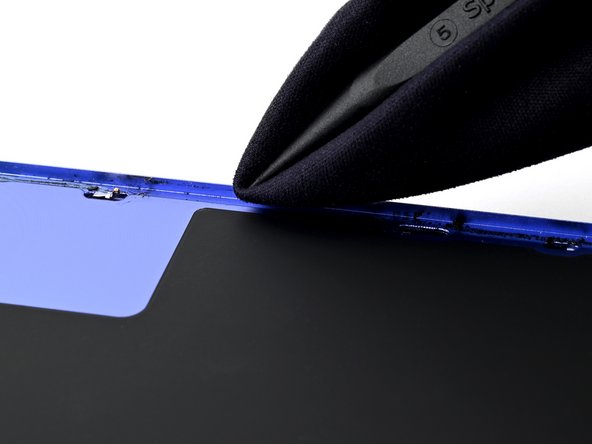

  36. iPhone 16 Screen Replacement, Remove the top liner: crwdns2935265:036crwdnd2935265:01crwdnd2935265:03crwdne2935265:0 iPhone 16 Screen Replacement, Remove the top liner: crwdns2935265:036crwdnd2935265:02crwdnd2935265:03crwdne2935265:0 iPhone 16 Screen Replacement, Remove the top liner: crwdns2935265:036crwdnd2935265:03crwdnd2935265:03crwdne2935265:0
    • Use the point of a spudger to lift the pull tab in the top‑right corner of the frame until you can grab it with your fingers.
    • Your pull tab may be in a different location. Make sure you're pulling the full-size top liner, not the thin liners under it.
    • Peel back the top liner and remove it.

  40. iPhone 16 Screen Replacement, Cover the connectors: crwdns2935265:040crwdnd2935265:01crwdnd2935265:02crwdne2935265:0 iPhone 16 Screen Replacement, Cover the connectors: crwdns2935265:040crwdnd2935265:02crwdnd2935265:02crwdne2935265:0
    • Use a pair of tweezers or your fingers to place the screen connector cover over the screen connector by inserting it at a slight downward angle to engage the hook, then laying the cover flat over the connector.
  41. iPhone 16 Screen Replacement: crwdns2935265:041crwdnd2935265:01crwdnd2935265:02crwdne2935265:0 iPhone 16 Screen Replacement: crwdns2935265:041crwdnd2935265:02crwdnd2935265:02crwdne2935265:0
    • Use a pair of tweezers or your fingers to place the front sensor connector cover over the front sensor connector by inserting it at a 90‑degree angle to engage the hook, then laying the cover flat over the connector.
  42. iPhone 16 Screen Replacement, Install the cover screws: crwdns2935265:042crwdnd2935265:01crwdnd2935265:02crwdne2935265:0 iPhone 16 Screen Replacement, Install the cover screws: crwdns2935265:042crwdnd2935265:02crwdnd2935265:02crwdne2935265:0
    • Use a tri-point Y000 driver to install the two 0.9 mm‑long screws securing the front sensor connector and screen connector covers.
