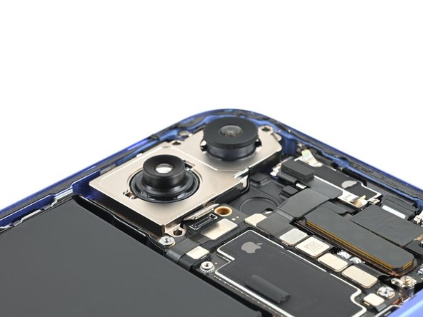

  22. iPhone 16 Rear Camera Assembly Replacement, Disconnect the rear camera assembly: crwdns2935265:022crwdnd2935265:01crwdnd2935265:02crwdne2935265:0 iPhone 16 Rear Camera Assembly Replacement, Disconnect the rear camera assembly: crwdns2935265:022crwdnd2935265:02crwdnd2935265:02crwdne2935265:0
    • Use the point of a spudger to pry up and disconnect the rear camera assembly press connector.

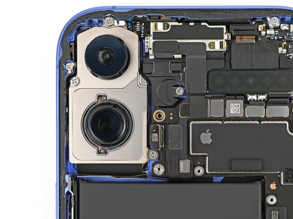

  23. iPhone 16 Rear Camera Assembly Replacement, Remove the rear camera assembly screws: crwdns2935265:023crwdnd2935265:01crwdnd2935265:02crwdne2935265:0 iPhone 16 Rear Camera Assembly Replacement, Remove the rear camera assembly screws: crwdns2935265:023crwdnd2935265:02crwdnd2935265:02crwdne2935265:0
    • Use a Phillips screwdriver to remove the three screws securing the rear camera assembly:
    • One 2.3 mm‑long screw
    • One 4.7 mm‑long screw
    • One 3.2 mm‑long screw

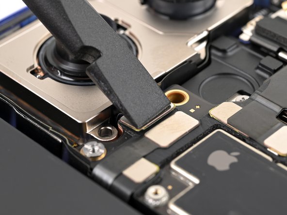

  24. iPhone 16 Rear Camera Assembly Replacement, Remove the rear camera assembly: crwdns2935265:024crwdnd2935265:01crwdnd2935265:03crwdne2935265:0 iPhone 16 Rear Camera Assembly Replacement, Remove the rear camera assembly: crwdns2935265:024crwdnd2935265:02crwdnd2935265:03crwdne2935265:0 iPhone 16 Rear Camera Assembly Replacement, Remove the rear camera assembly: crwdns2935265:024crwdnd2935265:03crwdnd2935265:03crwdne2935265:0
    • Insert the tip of a spudger into the top screw hole in the rear camera assembly.
    • Lift the rear camera assembly out of the frame and remove it.
  25. iPhone 16 Rear Camera Assembly Replacement, End of disassembly: crwdns2935265:025crwdnd2935265:01crwdnd2935265:01crwdne2935265:0
    • Congratulations on completing disassembly! The remaining steps will show you how to reassemble your device.
