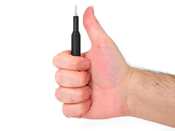

  4. iPhone 16 Pro Back Glass Replacement, Remove the pentalobe screws: crwdns2935265:04crwdnd2935265:01crwdnd2935265:02crwdne2935265:0 iPhone 16 Pro Back Glass Replacement, Remove the pentalobe screws: crwdns2935265:04crwdnd2935265:02crwdnd2935265:02crwdne2935265:0
    • Use a P2 pentalobe screwdriver to remove the two 7.4 mm‑long screws on either side of the USB-C port.
