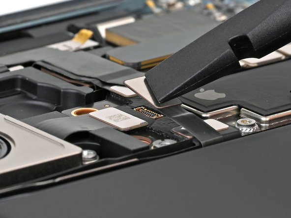

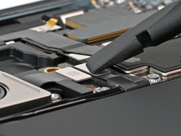

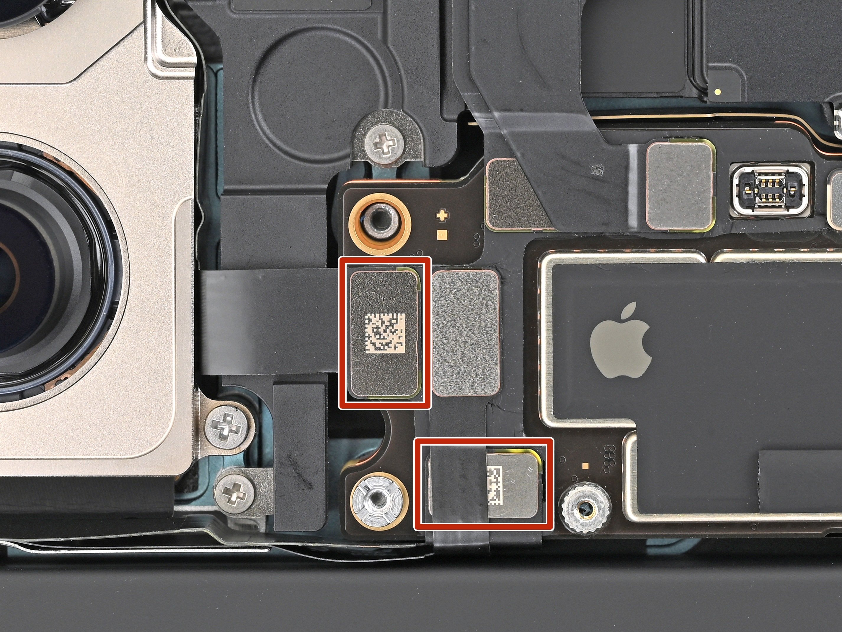

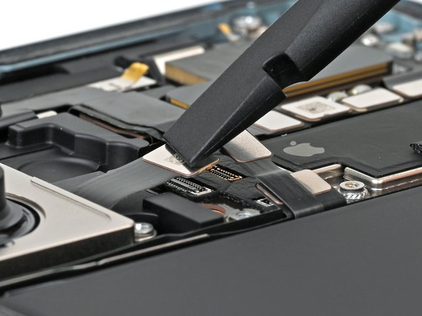

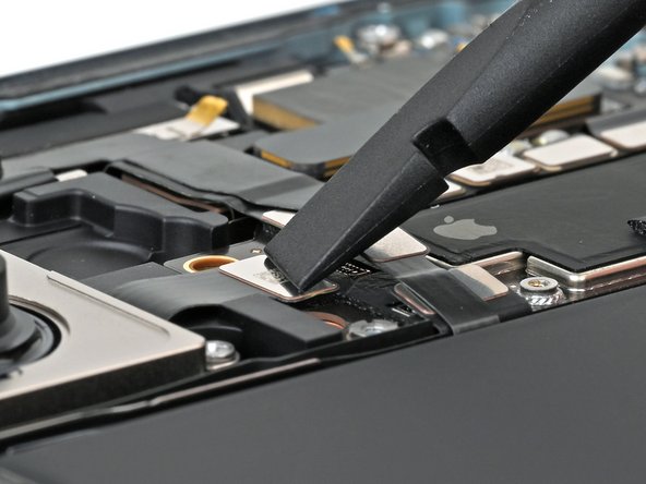

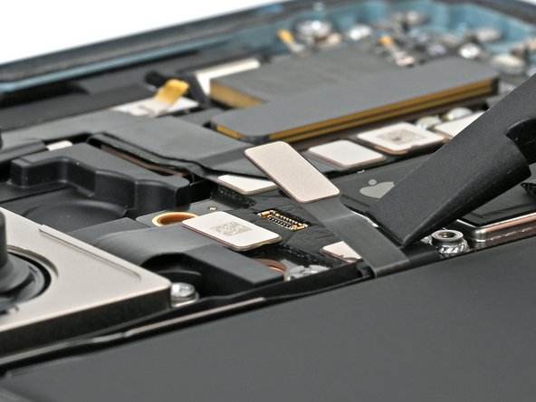

  24. iPhone 16 Plus Rear Cameras Replacement, Disconnect the rear cameras: crwdns2935265:024crwdnd2935265:01crwdnd2935265:03crwdne2935265:0 iPhone 16 Plus Rear Cameras Replacement, Disconnect the rear cameras: crwdns2935265:024crwdnd2935265:02crwdnd2935265:03crwdne2935265:0 iPhone 16 Plus Rear Cameras Replacement, Disconnect the rear cameras: crwdns2935265:024crwdnd2935265:03crwdnd2935265:03crwdne2935265:0
    • Disconnect the two rear camera press connectors, located underneath and to the left of the power/Camera Control button connector.

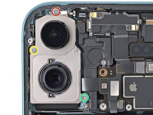

  25. iPhone 16 Plus Rear Cameras Replacement, Remove the rear camera screws: crwdns2935265:025crwdnd2935265:01crwdnd2935265:02crwdne2935265:0 iPhone 16 Plus Rear Cameras Replacement, Remove the rear camera screws: crwdns2935265:025crwdnd2935265:02crwdnd2935265:02crwdne2935265:0
    • Use your Phillips screwdriver to remove the three screws securing the rear cameras:
    • One 3.2 mm‑long screw
    • One 4.7 mm‑long screw
    • One 2.4 mm‑long screw
  26. iPhone 16 Plus Rear Cameras Replacement, Remove the rear cameras: crwdns2935265:026crwdnd2935265:01crwdnd2935265:02crwdne2935265:0 iPhone 16 Plus Rear Cameras Replacement, Remove the rear cameras: crwdns2935265:026crwdnd2935265:02crwdnd2935265:02crwdne2935265:0
    • Use a spudger or clean fingertip to pry up the top edge of the rear cameras until you can grab them with your fingers.
  27. iPhone 16 Plus Rear Cameras Replacement: crwdns2935265:027crwdnd2935265:01crwdnd2935265:03crwdne2935265:0 iPhone 16 Plus Rear Cameras Replacement: crwdns2935265:027crwdnd2935265:02crwdnd2935265:03crwdne2935265:0 iPhone 16 Plus Rear Cameras Replacement: crwdns2935265:027crwdnd2935265:03crwdnd2935265:03crwdne2935265:0
    • Lift the cameras straight up, then pull them towards the top of the phone to remove them.

  46. iPhone 16 Plus Rear Cameras Replacement, Connect the charging coil: crwdns2935265:046crwdnd2935265:01crwdnd2935265:03crwdne2935265:0 iPhone 16 Plus Rear Cameras Replacement, Connect the charging coil: crwdns2935265:046crwdnd2935265:02crwdnd2935265:03crwdne2935265:0 iPhone 16 Plus Rear Cameras Replacement, Connect the charging coil: crwdns2935265:046crwdnd2935265:03crwdnd2935265:03crwdne2935265:0
    • Prop up the back glass along the right edge of your iPhone, using a box or similar sturdy object to support the screen.
    • Use the flat end of a spudger or your finger to connect the charging coil press connector.
  47. iPhone 16 Plus Rear Cameras Replacement, Connect the battery: crwdns2935265:047crwdnd2935265:01crwdnd2935265:02crwdne2935265:0 iPhone 16 Plus Rear Cameras Replacement, Connect the battery: crwdns2935265:047crwdnd2935265:02crwdnd2935265:02crwdne2935265:0
    • Use the flat end of a spudger or your finger to connect the battery.
