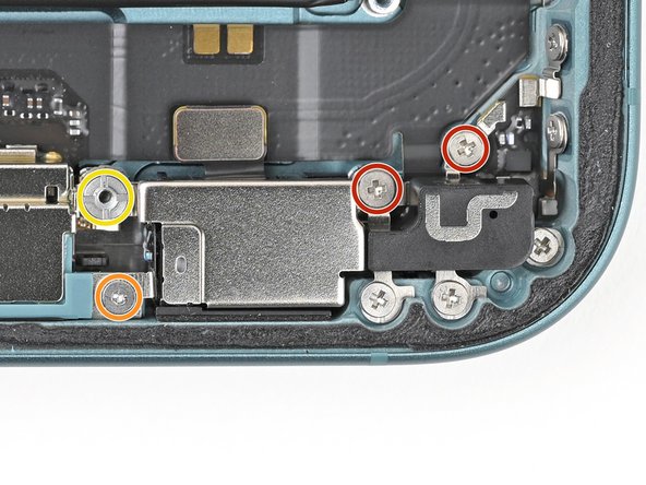

  26. iPhone 16 Plus Microphone Replacement, Remove the loudspeaker screws: crwdns2935265:026crwdnd2935265:01crwdnd2935265:02crwdne2935265:0 iPhone 16 Plus Microphone Replacement, Remove the loudspeaker screws: crwdns2935265:026crwdnd2935265:02crwdnd2935265:02crwdne2935265:0
    Standoff Screwdriver for iPhones
    $5.49
    • Be careful not to puncture or dent the battery with your screwdriver.
    • Use your Phillips screwdriver to remove four of the screws securing the loudspeaker:
    • Three 1.5 mm-long screws
    • One 3.0 mm-long screw
    • Use your tri-point Y000 screwdriver to remove the 1.3 mm-long screw securing a grounding contact and the loudspeaker.
    • Use your standoff screwdriver to remove the 3.4 mm-long screw securing the loudspeaker.
    • If you don't have a standoff driver, you may use a thin flathead driver—but be careful not to strip the shallow notches in the screw heads.

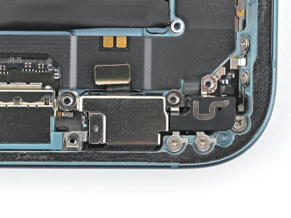

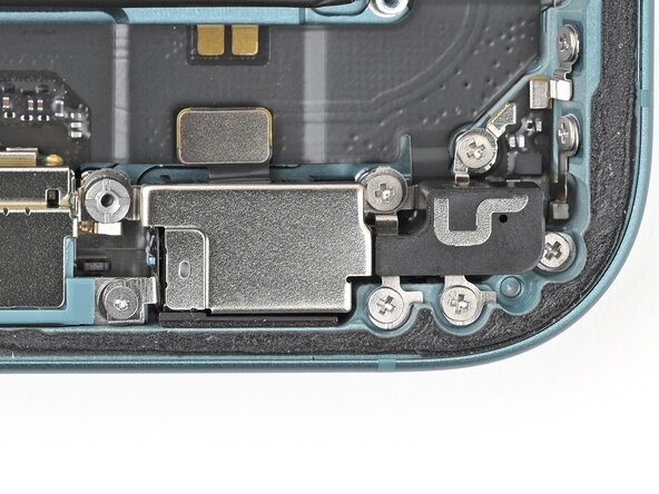

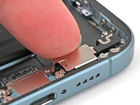

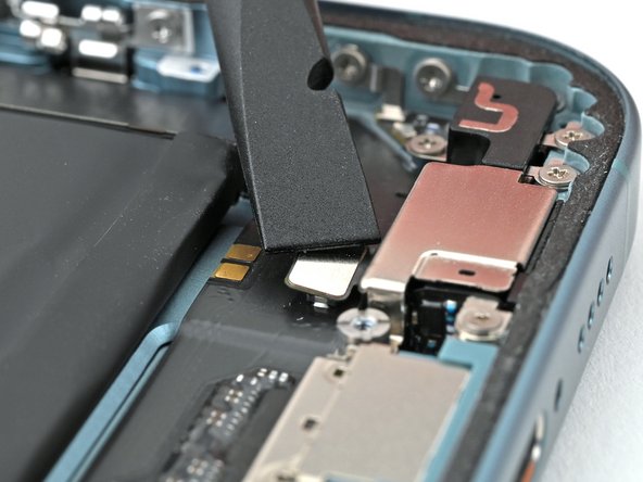

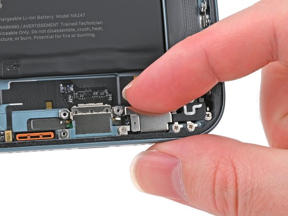

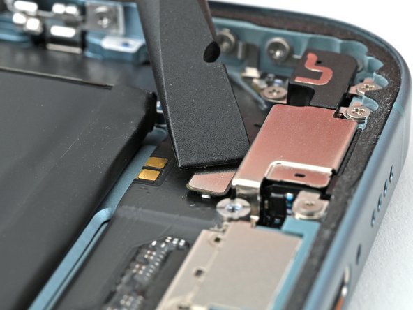

  28. iPhone 16 Plus Microphone Replacement, Disconnect the microphone: crwdns2935265:028crwdnd2935265:01crwdnd2935265:02crwdne2935265:0 iPhone 16 Plus Microphone Replacement, Disconnect the microphone: crwdns2935265:028crwdnd2935265:02crwdnd2935265:02crwdne2935265:0
    • Use the point of a spudger to pry up and disconnect the microphone's press connector.
    • Don't pry against the battery, it could catch fire if damaged.

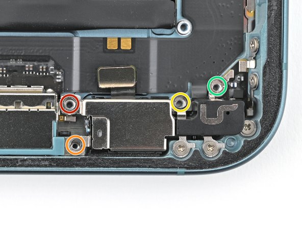

  29. iPhone 16 Plus Microphone Replacement, Remove the microphone screws: crwdns2935265:029crwdnd2935265:01crwdnd2935265:02crwdne2935265:0 iPhone 16 Plus Microphone Replacement, Remove the microphone screws: crwdns2935265:029crwdnd2935265:02crwdnd2935265:02crwdne2935265:0
    • Remove the four screws securing the microphone:
    • One 3.3 mm‑long standoff screw
    • One 1.3 mm‑long tri-point Y000 screw
    • One 1.5 mm‑long Phillips screw
    • One 1.3 mm‑long Phillips screw

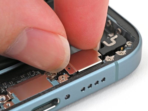

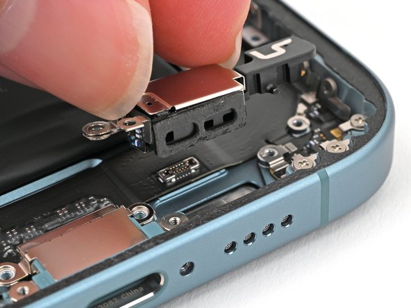

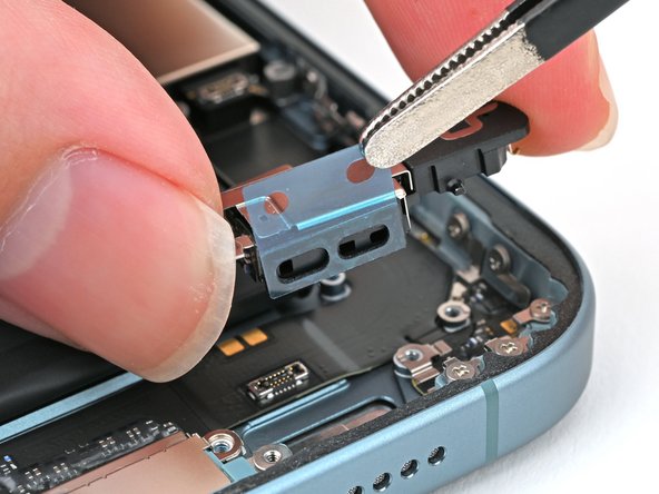

  30. iPhone 16 Plus Microphone Replacement, Remove the microphone: crwdns2935265:030crwdnd2935265:01crwdnd2935265:03crwdne2935265:0 iPhone 16 Plus Microphone Replacement, Remove the microphone: crwdns2935265:030crwdnd2935265:02crwdnd2935265:03crwdne2935265:0 iPhone 16 Plus Microphone Replacement, Remove the microphone: crwdns2935265:030crwdnd2935265:03crwdnd2935265:03crwdne2935265:0
    • The microphone is held in place by strong adhesive to the bottom edge of the phone.
    • Insert the flat end of a spudger under the top edge of the microphone and pry up until you can grab it with your fingers.
    • If the microphone does not budge, try adding a little bit of heat using an iOpener, hair dryer, or heat gun. Only heat it it's slightly hot to touch, as the battery is susceptible to heat damage.
    • Peel the microphone from the adhesive securing it to the frame and remove it.

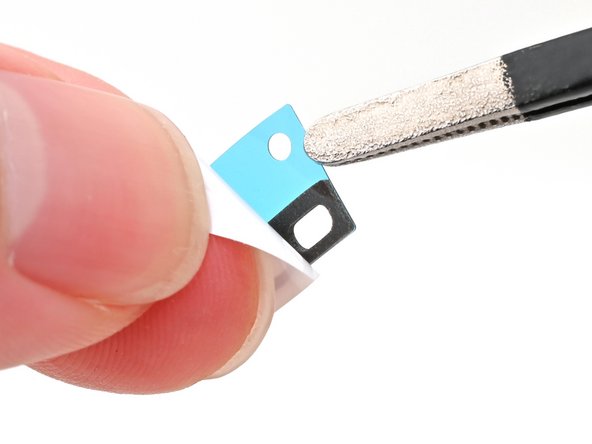

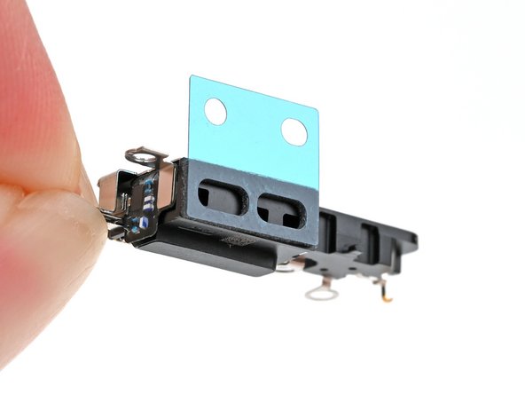

  32. iPhone 16 Plus Microphone Replacement, Prepare the adhesive: crwdns2935265:032crwdnd2935265:01crwdnd2935265:01crwdne2935265:0
    • Peel away the new adhesive strip from its white liner, keeping the blue liner in place.
    • Don't stick the adhesive to the microphone yet.

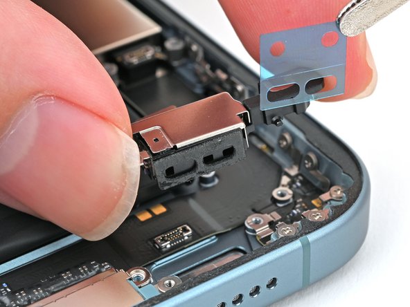

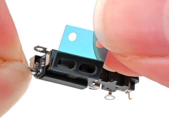

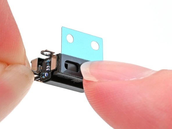

  33. iPhone 16 Plus Microphone Replacement, Apply the adhesive: crwdns2935265:033crwdnd2935265:01crwdnd2935265:03crwdne2935265:0 iPhone 16 Plus Microphone Replacement, Apply the adhesive: crwdns2935265:033crwdnd2935265:02crwdnd2935265:03crwdne2935265:0 iPhone 16 Plus Microphone Replacement, Apply the adhesive: crwdns2935265:033crwdnd2935265:03crwdnd2935265:03crwdne2935265:0
    • Once the adhesive sticks to the microphone, it cannot be removed and reused. Ensure it is perfectly aligned before adhering.
    • Align the two holes in the adhesive with the three holes in the microphone, and stick it into place.
  34. iPhone 16 Plus Microphone Replacement: crwdns2935265:034crwdnd2935265:01crwdnd2935265:02crwdne2935265:0 iPhone 16 Plus Microphone Replacement: crwdns2935265:034crwdnd2935265:02crwdnd2935265:02crwdne2935265:0
    • Use tweezers or your fingers to remove the blue plastic liner.

    • Use the flat end of a spudger to connect the microphone's press connector.
  40. iPhone 16 Plus Microphone Replacement, Install the loudspeaker: crwdns2935265:040crwdnd2935265:01crwdnd2935265:03crwdne2935265:0 iPhone 16 Plus Microphone Replacement, Install the loudspeaker: crwdns2935265:040crwdnd2935265:02crwdnd2935265:03crwdne2935265:0 iPhone 16 Plus Microphone Replacement, Install the loudspeaker: crwdns2935265:040crwdnd2935265:03crwdnd2935265:03crwdne2935265:0
    • Make sure the orange speaker gasket is fully in its slot in the frame.
    • Align the loudspeaker with its screw posts and set it into its recess.
    • Be careful not to move the orange speaker gasket during installation.
  41. iPhone 16 Plus Microphone Replacement: crwdns2935265:041crwdnd2935265:01crwdnd2935265:02crwdne2935265:0 iPhone 16 Plus Microphone Replacement: crwdns2935265:041crwdnd2935265:02crwdnd2935265:02crwdne2935265:0
    $5.49
    • Use a Phillips screwdriver to install four of the screws securing the loudspeaker:
    • Three 1.5 mm‑long screws
    • One 3.0 mm‑long screw
    • Use a tri‑point Y000 screwdriver to install the 1.3 mm‑long screw securing a grounding contact and the loudspeaker.
    • Use a standoff screwdriver to install the 3.4 mm‑long screw securing the loudspeaker.
  42. iPhone 16 Plus Microphone Replacement, Install the Taptic Engine: crwdns2935265:042crwdnd2935265:01crwdnd2935265:03crwdne2935265:0 iPhone 16 Plus Microphone Replacement, Install the Taptic Engine: crwdns2935265:042crwdnd2935265:02crwdnd2935265:03crwdne2935265:0 iPhone 16 Plus Microphone Replacement, Install the Taptic Engine: crwdns2935265:042crwdnd2935265:03crwdnd2935265:03crwdne2935265:0
    • Use blunt-nose tweezers or your fingers to align the Taptic Engine with its screw posts and place it in the frame.
  43. iPhone 16 Plus Microphone Replacement, Connect the Taptic Engine: crwdns2935265:043crwdnd2935265:01crwdnd2935265:02crwdne2935265:0 iPhone 16 Plus Microphone Replacement, Connect the Taptic Engine: crwdns2935265:043crwdnd2935265:02crwdnd2935265:02crwdne2935265:0
    • Use your finger or a spudger to connect the Taptic Engine press connector.
    • To re-attach press connectors like this one, carefully align and press down on one side, then the other, until it clicks into place. Don't try to force the connector into place—if you're having trouble, reposition it and try again.
  44. iPhone 16 Plus Microphone Replacement, Secure the Taptic Engine: crwdns2935265:044crwdnd2935265:01crwdnd2935265:02crwdne2935265:0 iPhone 16 Plus Microphone Replacement, Secure the Taptic Engine: crwdns2935265:044crwdnd2935265:02crwdnd2935265:02crwdne2935265:0
    • Use a Phillips screwdriver to install the 1.8 mm screw securing the Taptic Engine.
  45. iPhone 16 Plus Microphone Replacement, Install the bracket: crwdns2935265:045crwdnd2935265:01crwdnd2935265:02crwdne2935265:0 iPhone 16 Plus Microphone Replacement, Install the bracket: crwdns2935265:045crwdnd2935265:02crwdnd2935265:02crwdne2935265:0
    • Align the Taptic Engine bracket with its screw holes and set it into place.
  46. iPhone 16 Plus Microphone Replacement: crwdns2935265:046crwdnd2935265:01crwdnd2935265:02crwdne2935265:0 iPhone 16 Plus Microphone Replacement: crwdns2935265:046crwdnd2935265:02crwdnd2935265:02crwdne2935265:0
    • Use a Phillips screwdriver to install the three screws securing the Taptic Engine bracket:
    • Two 1.9 mm‑long screws
    • One 2.1 mm‑long screw
